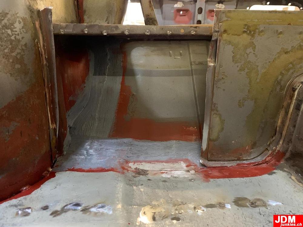

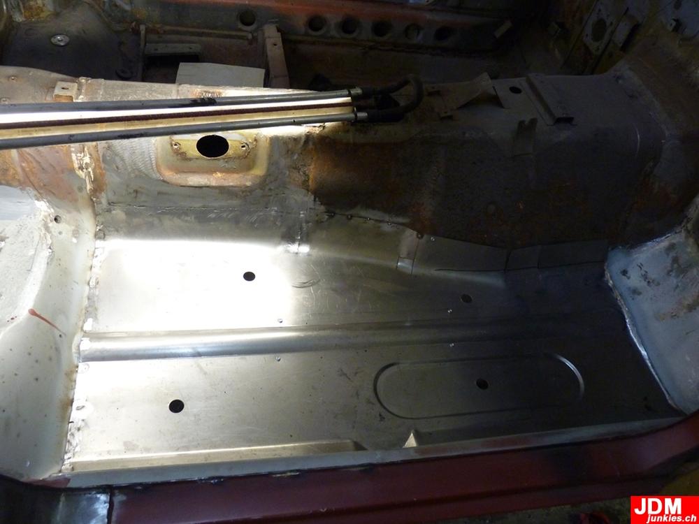

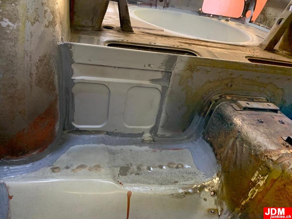

March 16, 20205 yr Author comment_594492 My bodyshop guy promised me to work on my car until end of march. so i hope there is some progress. the first update he sent me was from the area behind the passenger seat. There was some rust do to the previous owner storing it without a sunroof installed, during swiss winter, so snow collected inside the car and we know Z's dont like any kind of moisture. Now looks better than ever and is nicely protected. Link to comment https://www.classiczcars.com/forums/topic/44860-my-two-swiss-s30z-fairlady-restoration-build-thread/?&page=47#findComment-594492 Share on other sites More sharing options...

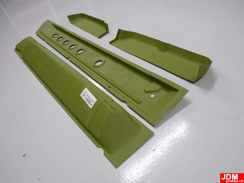

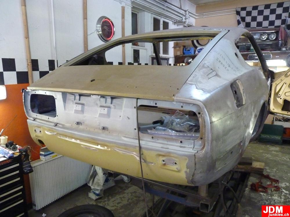

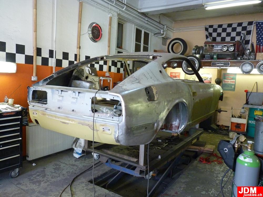

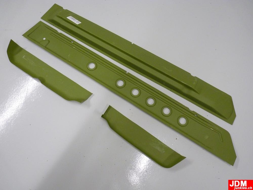

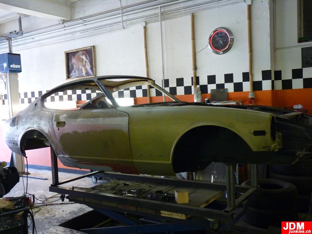

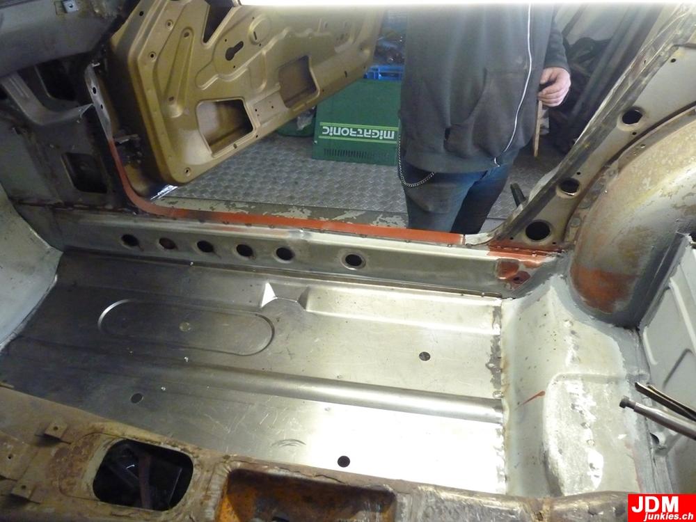

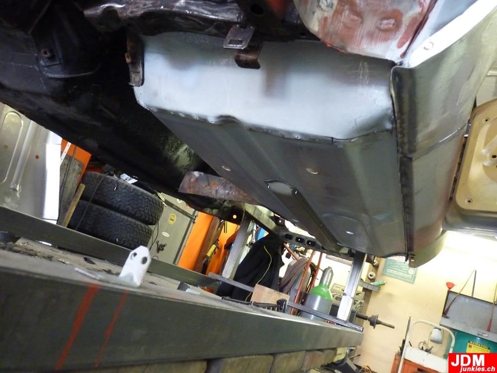

March 19, 20205 yr Author comment_594769 Good news. My Panelbeater is working hard on my car atm and there's some progress, so i visited him (with 2 meters distance of course, because #Coronavirus). So the passenger floor pans are in and will be completed soon: Looking good in my opinion: To get everything aligned was a bit of a headache, even with the best parts available, but looks good now. So today i brought him the front fender. It needs the original edge line hammered back in, as some previous owner decided to hammer that flat.. terrible.. Luckily it's the kind of job my panelbeater likes ? Starts to look like a car again, doesn't it? Allthough the rocker panel needs some adjustment. View from the rear. Also brought him the hatch to adjust everything but we didn't test fit it yet. Still a few days of work to adjust the rocker panel, get the floorpans welded in completely and have the Seat rail mounts back in. But then it's up to the other side. which is luckily in much better state and i have much bigger, better and OEM Panels ready. so i hope work will be faster. I say that, knowing that my panelbeater takes his time to get it done right.. Link to comment https://www.classiczcars.com/forums/topic/44860-my-two-swiss-s30z-fairlady-restoration-build-thread/?&page=47#findComment-594769 Share on other sites More sharing options...

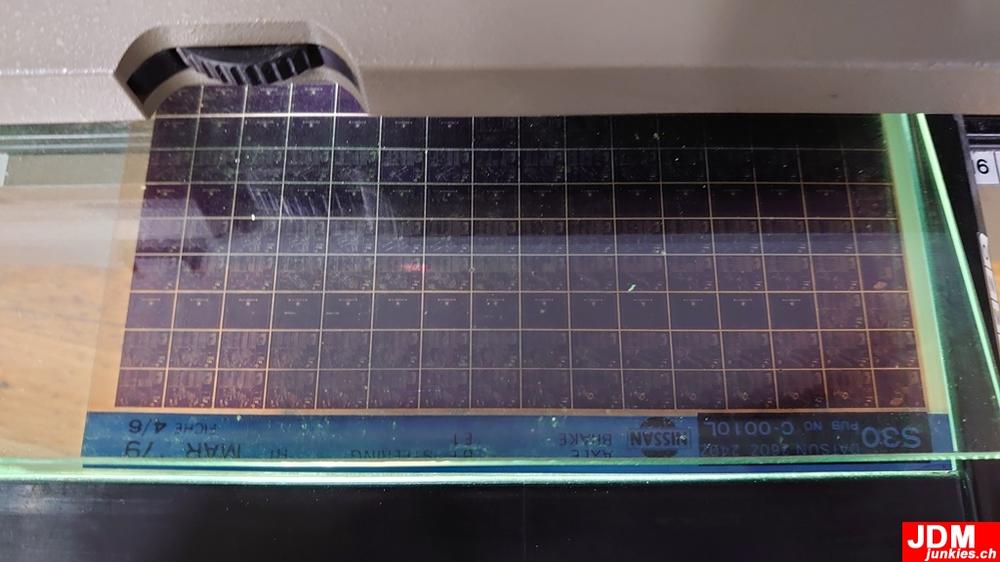

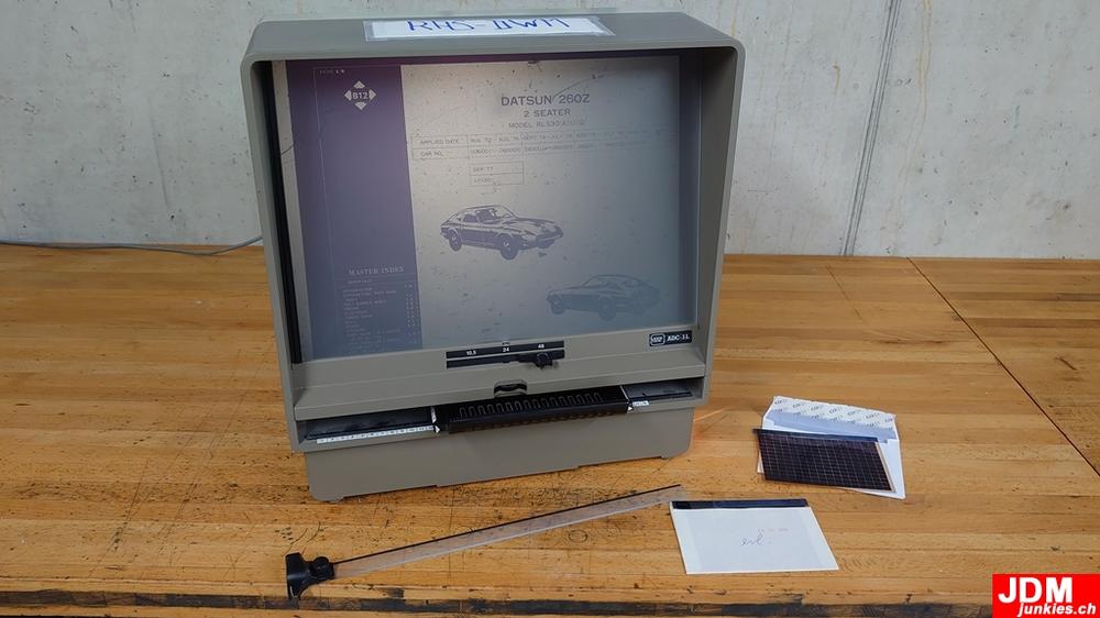

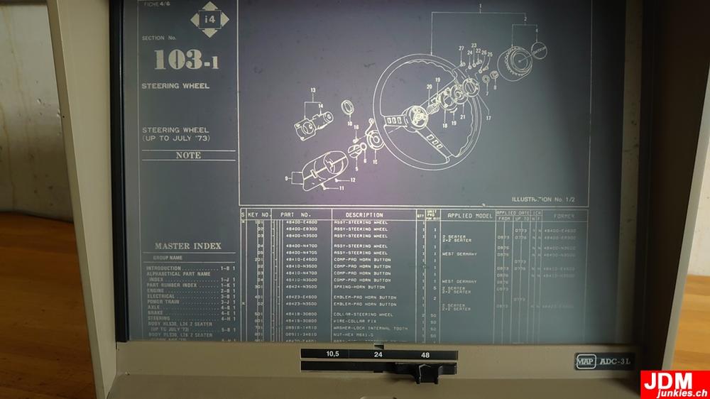

March 24, 20205 yr Author comment_595254 A while a go a i scored an (incomplete) set of old Nissan / Datsun Microfiches of the 240Z / S30 chassis in germany for almost nothing. I tried to scan it using a flatbet scanner is some suggested but the results were terrible. When i found out that my company (beeing a several hundred years old machinery company) has several of those in the mechanical department, i asked if i could borrow one to check my microfiches. and today i brought one home: Microfiches are like Dia's, a kind of minimized drawings or part lists on a film type piece of plastic. The microfiche reader is more or less a projector. You insert one of the film cards, which is labelled for example with "S30 Chassis": And then you can zoom in. By moving around the card you can check the different sections. and then zoom in more and more until you get the page you want: Like for example the steering section: The data in the microfiche is nothing special. it's available in digital form (Nissan FAST or E-Fast software), printed form (Parts manual / R-Drive parts lists) or even as scanned versions of the Microfiches. However it's fun to tinker around like they did back in the day and i will sure have my fun during the COVID-19 Lockdown time to go through the microfiches and check for some data i didn't know yet. Since those Microfiche readers are for sale cheap, im thinking of buying a second-hand unit just for fun and for having the parts fiches accessable directly in the workshop. Link to comment https://www.classiczcars.com/forums/topic/44860-my-two-swiss-s30z-fairlady-restoration-build-thread/?&page=47#findComment-595254 Share on other sites More sharing options...

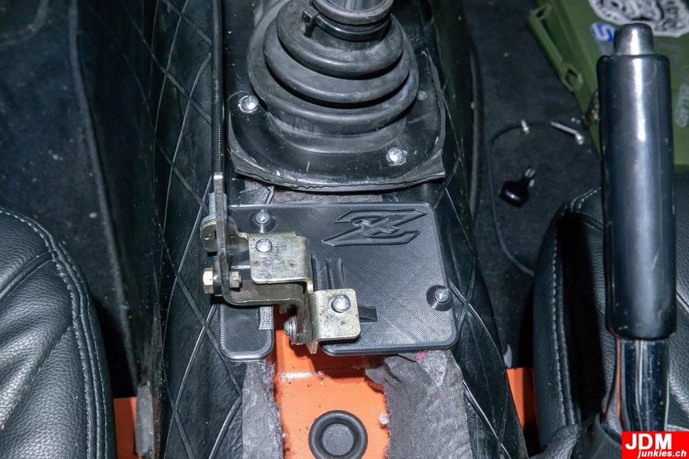

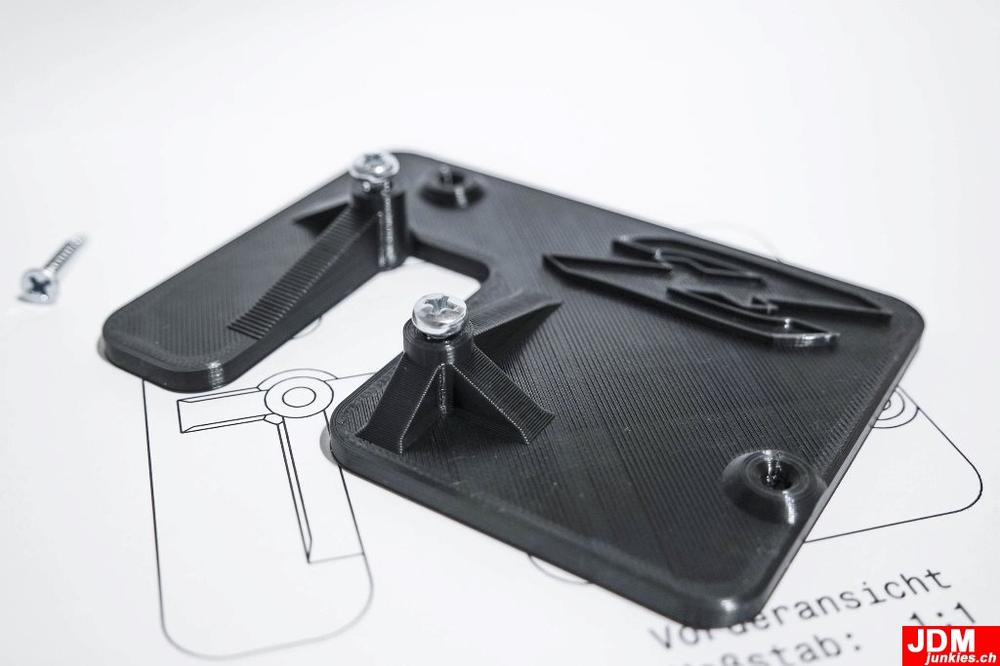

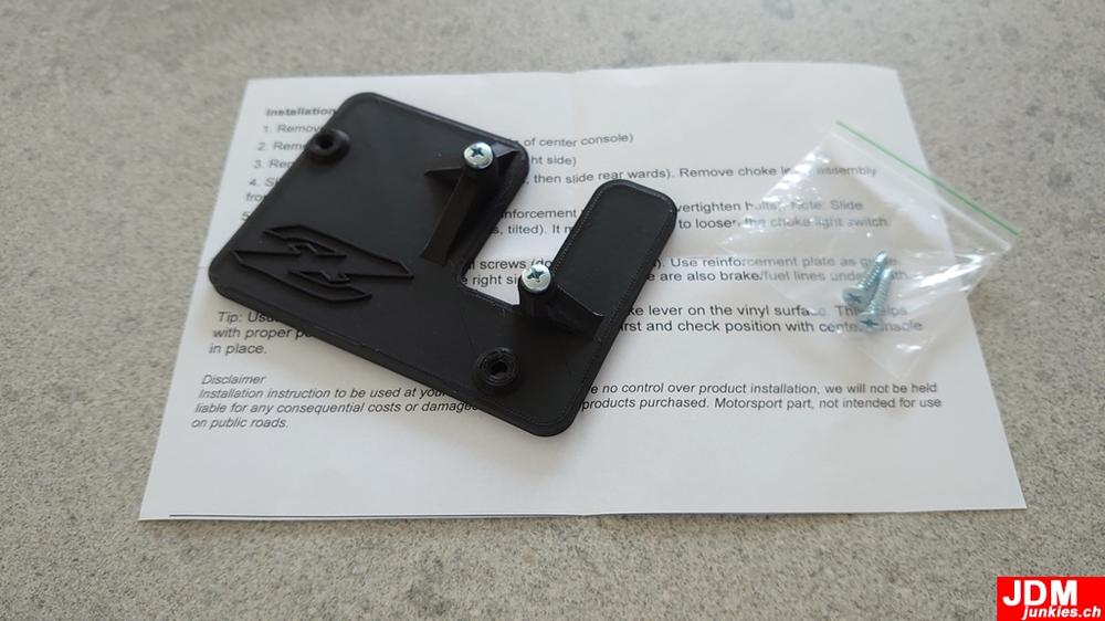

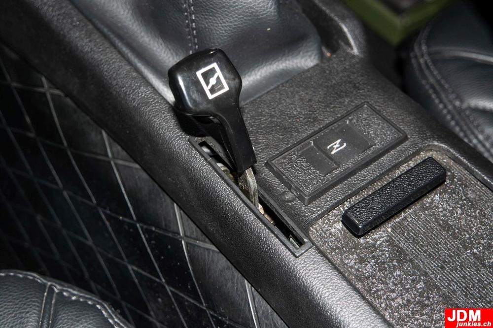

March 27, 20205 yr Author comment_595615 A few weeks ago i saw a german guy named tim on facebook, showing some Choke lever adapter plates he designed and made for the Z. He made a few more and sold them. I guess he didn't expect them to sell like hot cakes, so he had to make a few more. And that's how i got one in the mailbox today. The plate is made from 3D Printed plastic, which is then hardenet to improve strenght a lot and make it thermally stable up to 120°C. He designed and made those in first case for himself, and told me a lot of testing went into it to get the process right: The original choke lever is prone to be a bit "wiggly" which wasn't the best design from Nissan. The plate will improve tha stability of the choke lever and also prevent the Center console from cracking it that area (which can happen due to the loose choke lever) Once it's installed it is completely invisible. In my opinion clearly an OEM Upgrade worth it, even with completely stock cars. All pictures except the first one are courtesy of tim. Edited March 29, 20205 yr by JDMjunkies.ch Link to comment https://www.classiczcars.com/forums/topic/44860-my-two-swiss-s30z-fairlady-restoration-build-thread/?&page=47#findComment-595615 Share on other sites More sharing options...

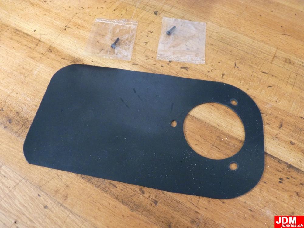

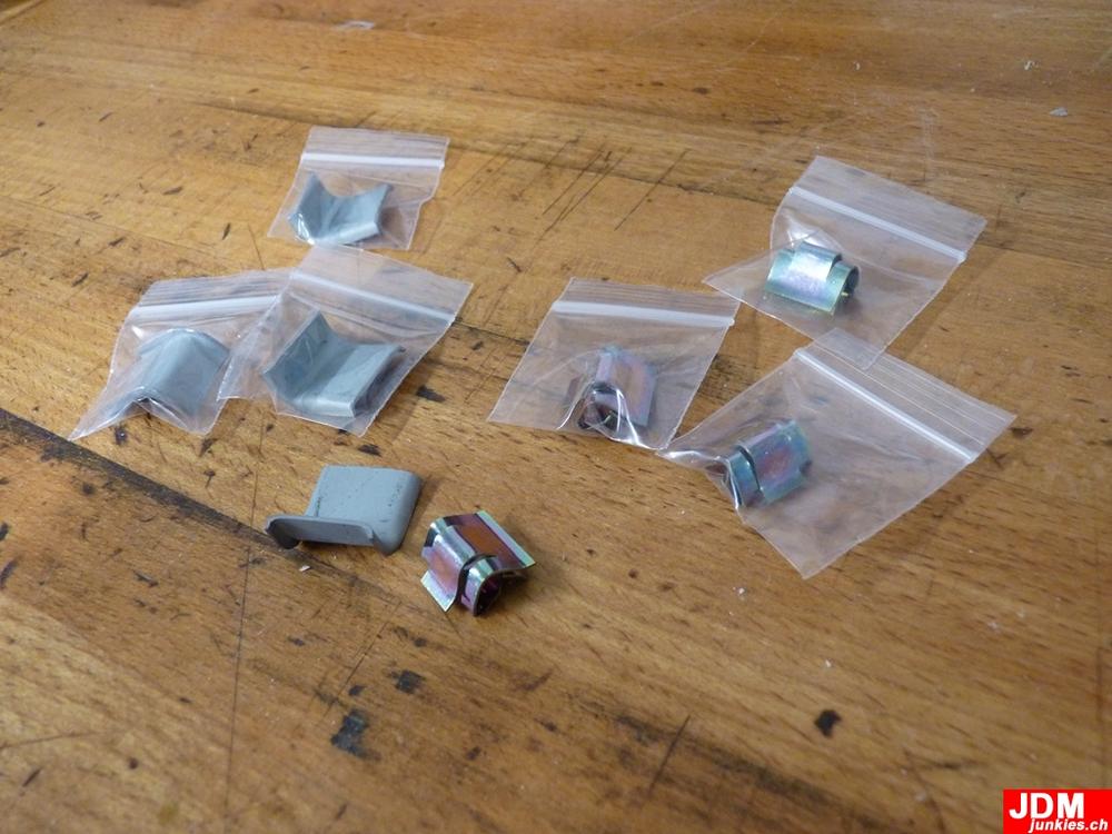

March 30, 20205 yr Author comment_595826 A few weeks ago my Bodyshop guy asked me if i could get him the now-missing taillight surroudning panel mounts, which he had to remove during repair of the rear-end. I researched a bit and found that JDM-Car-Parts makes them. They weren't cheap but well... Today they arrived in the mailbox. And while shipping stuff anyway, i decided to add a few small bits and pieces to the order. Like the chain that holds the Fuel filler cap in place: The rubber piece that goes behind the fuel filler cap: And some headlight gaskets, since my original ones are completely toast: Link to comment https://www.classiczcars.com/forums/topic/44860-my-two-swiss-s30z-fairlady-restoration-build-thread/?&page=47#findComment-595826 Share on other sites More sharing options...

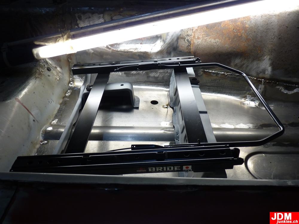

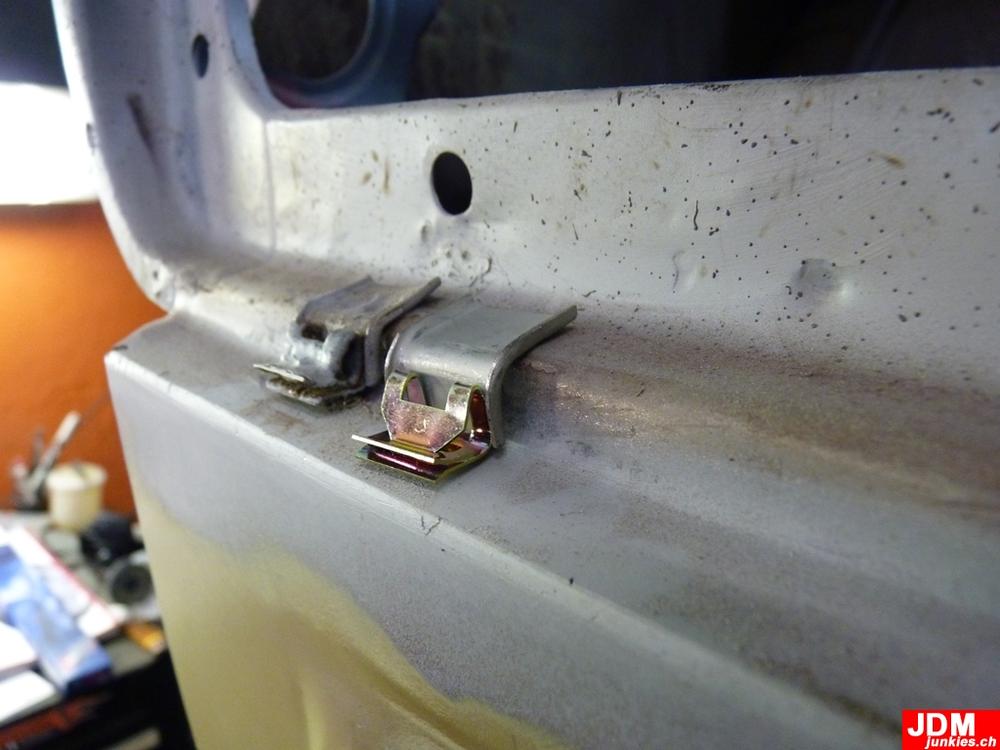

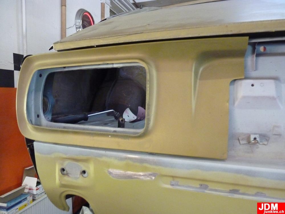

March 31, 20205 yr Author comment_595922 Thanks to the Covid-19 crisis my Bodyshop had to close for the time beeing, since he has trouble getting all the stuff he needs atm. Nevertheless i was able to visit him today, deliver a few small bits and pieces and test-fitted some parts. This is how it looked a few days ago, before the shut-down: And this today when i visited him. still a bit of work needed, but keeps on looking better and better. Frame-rail is welded on too, but forgot to take a picture. Instead of bringing a whole seat i brought the bride seat rail which has the same pattern to test the bracket location (will be in original position). The brackets will need some touch-ups too. if you look closely, you can see the front one has some rust holes... We also had a look at the new taillight surrounding panel brackets. We didn't figure out yet how it is intended to paint those brakets or the area around them. Probably bend them up a bit?. but at least they fit perfectly and look good ? We made a little mock-up with one of the taillight surrounding panels. The position is not correcti n the picture, but you get the idea ? And the trunk is on there too. The damper and the rupper-pockets and spacers are missing at the top yet. but i brought them along today so he can adjust everything nicely and make sure are the panelgaps are straight and tight. Link to comment https://www.classiczcars.com/forums/topic/44860-my-two-swiss-s30z-fairlady-restoration-build-thread/?&page=47#findComment-595922 Share on other sites More sharing options...
March 31, 20205 yr comment_595963 Did the mounting brackets come from JDM car parts too? I had seen their tail light finisher clips. They are a little pricey Link to comment https://www.classiczcars.com/forums/topic/44860-my-two-swiss-s30z-fairlady-restoration-build-thread/?&page=47#findComment-595963 Share on other sites More sharing options...
April 1, 20204 yr Author comment_596030 On 3/31/2020 at 10:58 PM, Patcon said: Did the mounting brackets come from JDM car parts too? I had seen their tail light finisher clips. They are a little pricey Yes they are pricey, but the fitment is perfect and as close as original as you can, and i guess also a lack of options for that... On their page where you can buy the clips, you can also select the brackets in the dropdown menu. I guess in the aftermath i gould have re-used the old brackets (not the clips) but i'm also fine with having new ones ? Link to comment https://www.classiczcars.com/forums/topic/44860-my-two-swiss-s30z-fairlady-restoration-build-thread/?&page=47#findComment-596030 Share on other sites More sharing options...
