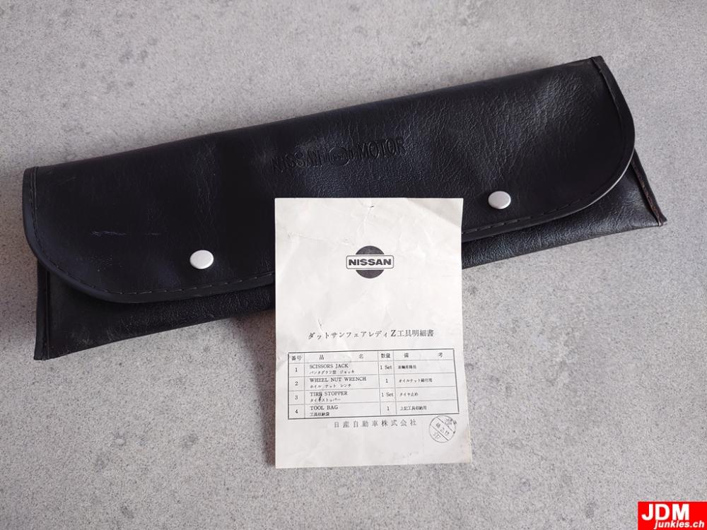

Today i got a few interesting documents again. Let's start with the Z-specific stuff. An original Toolkit bag packing slip / Content slip:
I will use it to make a nice replica for my original toolkit (which came with some missing tools and without the toolkit.

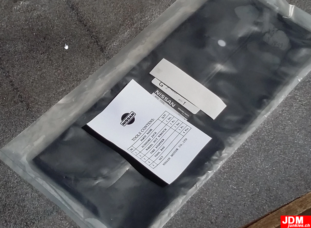

The one above came from an original "final spec" European 240Z and is different to what i've seen for Sale in the USA. But it might be possible that the slip has changed over the years and that later
spareparts came with a different slip. Picture below shows one for sale in america by zeddsaver.com:

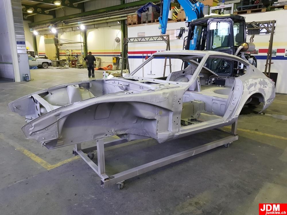

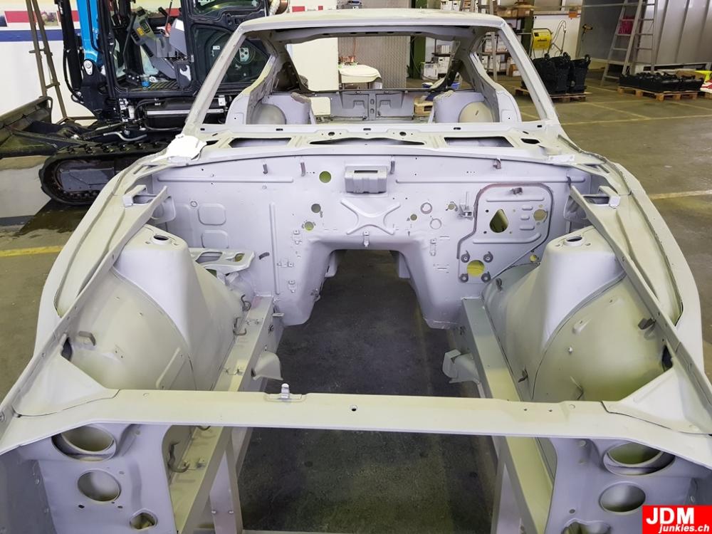

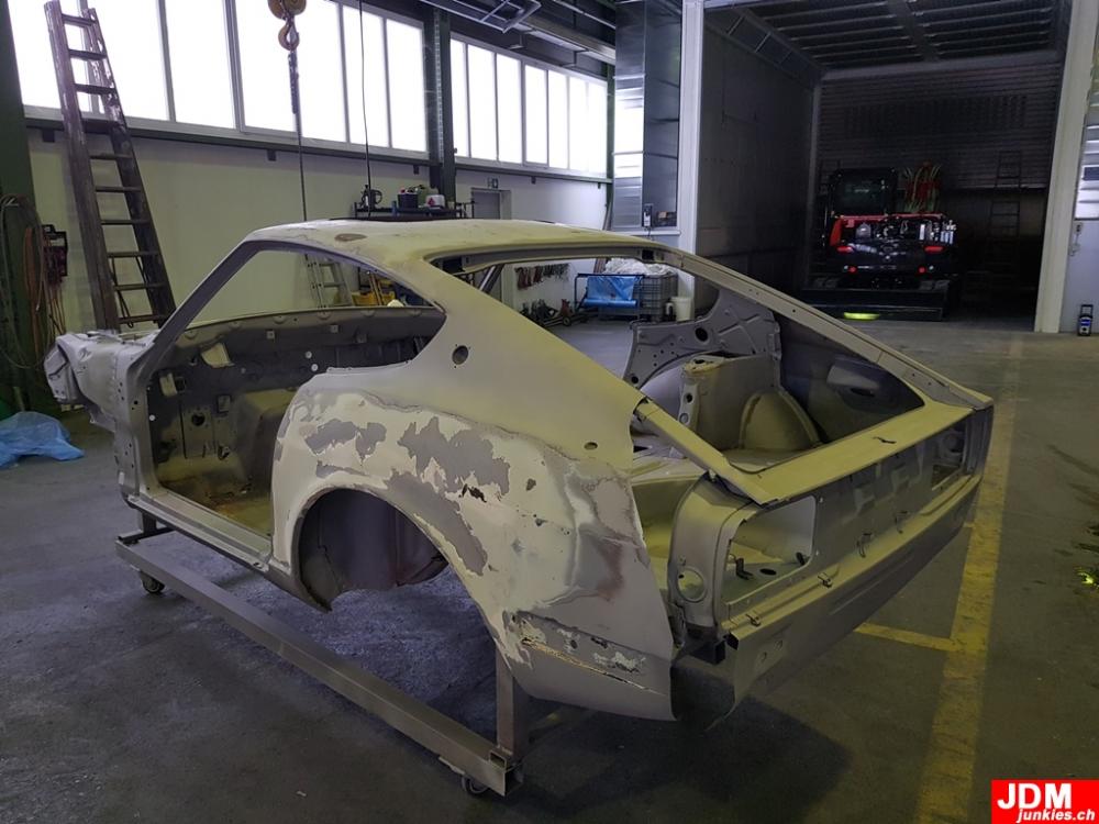

Slightly delayed because of holday season and the current COVID situation, but i just got some pictures from the blaster, and a note that the chassis is done. They blasted the whole car with non abrasive plastic media, which doesnt warp big thin surfaces. Where abrasives were needed, they added a bit of sand to remove rust and bondo (partially). The sticker underbody protecting-stuff was removed by dry-ice blasting...
You can clearly see the many repairs on the inner front fender and Air channel and the ton of bondo remaining on the LH rear quarter.
Luckily the engine bay looks nice at the first view, but i have to inspect closer once it's back at my place.
This is the side that has already been finnished by the bodyshop (the brown stuff is remaining seam sealer...)
this is the undone side. Luckily i have a NOS spare roof and rear quarter in stock to fix this. Meanwhile the chassis should also be primered with a weldable primer. In the next days they will return it to me and then i'll take some better pictures and a closer look at all the details... Just a little tip from my side. If you ever do a full restoration like this. start with cleaning the chassis. not like me who started with the bodywork just to blast the chassis when half of it was already done. well you learn new things all th e time - and that's what makes a project like this so much fun 🙂 More coming soon....

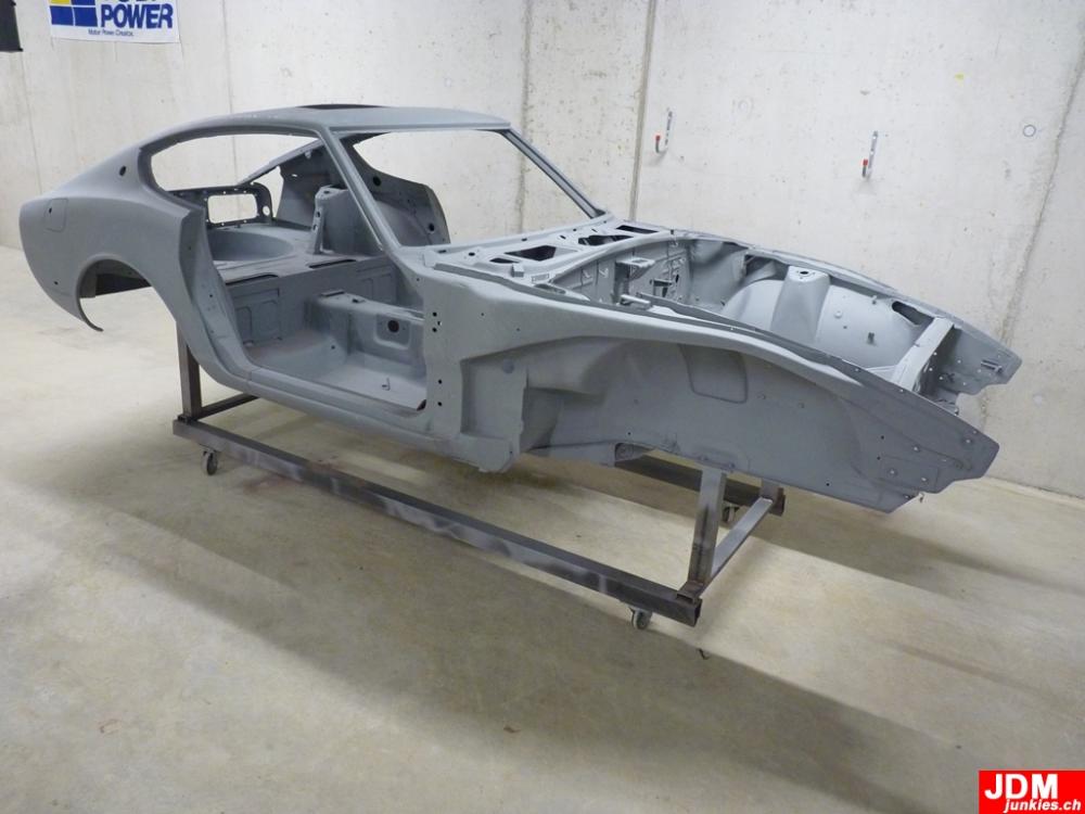

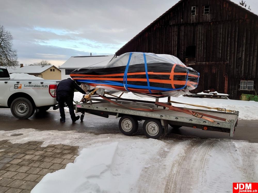

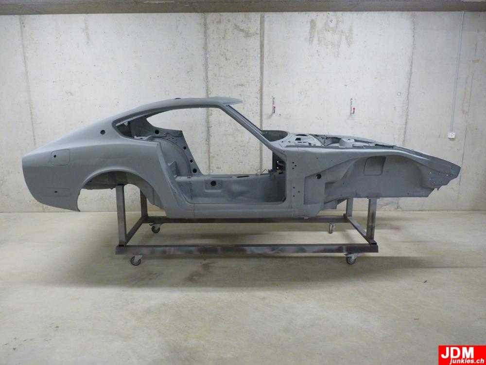

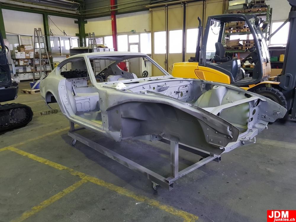

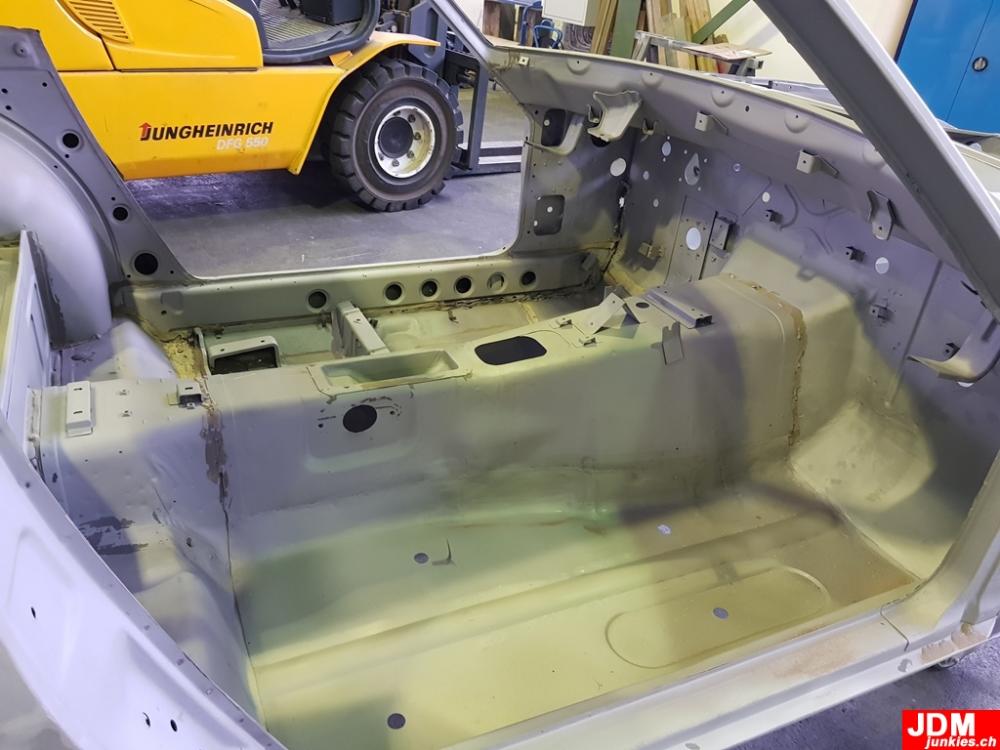

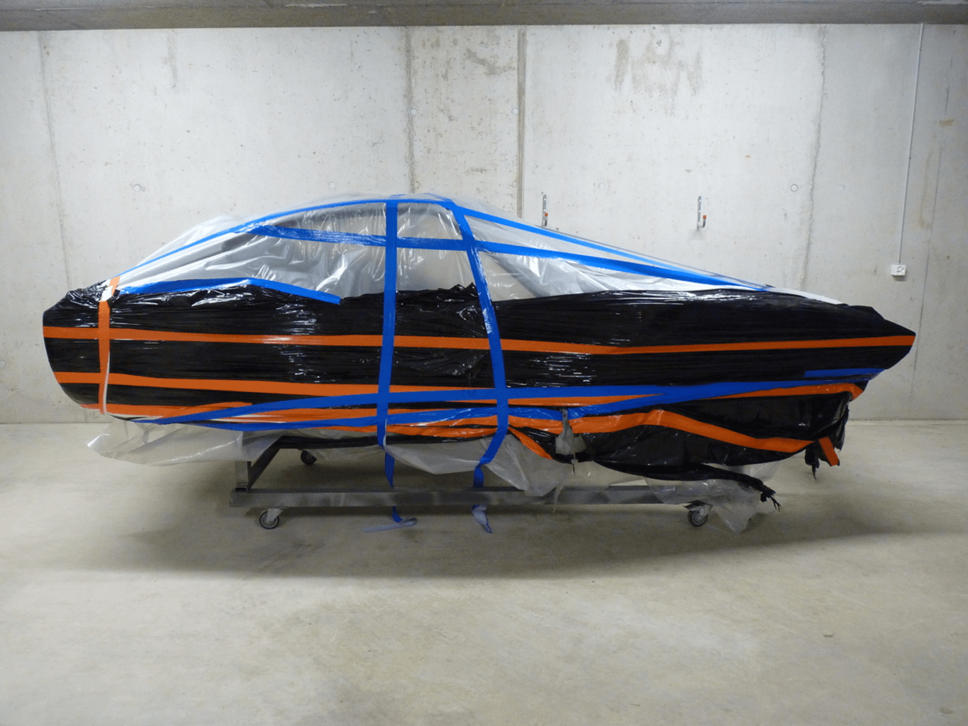

Today i got the delivery from the guys at Sandstrahlen-plus.ch which i can really recommend if you're in switzerland...
They had my complete chassis blasted (except the roof and a few areas i will replace anyway) and primered.
The job is very nice if you ask me and it looks so much better with all the car in one colour, rather than twelve different layers of primer, bondo, paint, rust protection, etc.. in various states...
Remember, this is how it looked a few weeks ago...

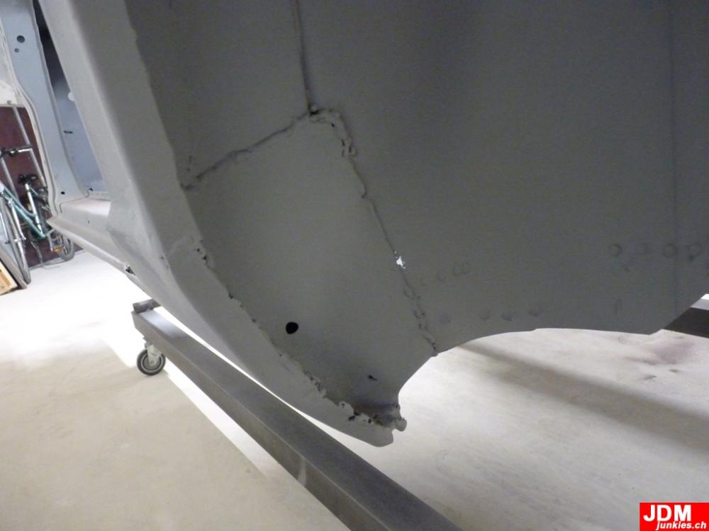

Luckily the process didnt' reveal any new problems, only the bad repairs of yesteryear and the rusty spots i already new and have replacement panels for...

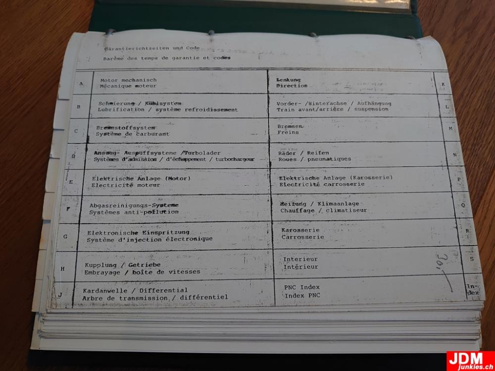

The fifth folder is a Warranty Flatrate time folder, which lists various warranty flatrate times and Warranty codes for the different cars including the 240Z and C10. It is required to fill the above mentioned warranty report.

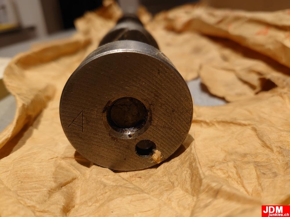

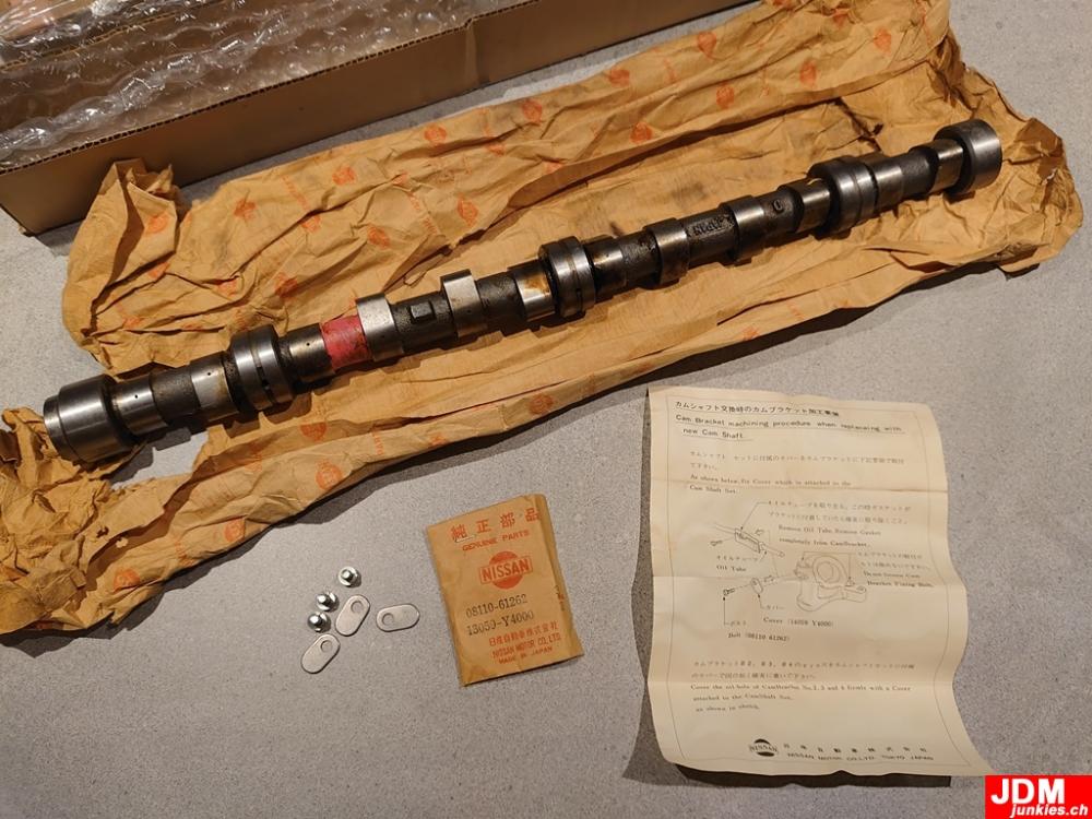

Yesterday the post officer brought a nice little package to my door:

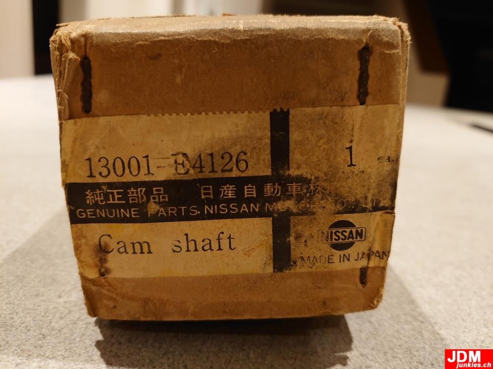

It contains a brand new (NOS) L6 Camshaft for the E88 Head. It is used widely in many L-series cars from what i understoud, but i still have to research all the details. It was for sale not far away and the price was ok, so i thought myself i better secure it...
I love the beautiful wrapping with the Nissan wrapping paper, etc...

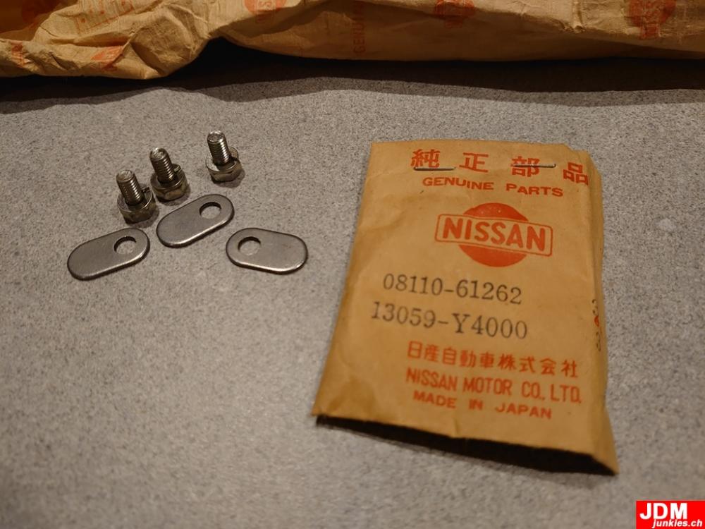

It came with a (separetely sold) Set of Cam oiler blockoff plates and bolts for older externally oiled cams. I still have to check if i need those...
It also came with a "Cam bracket machining procedure when replacing with new cam shaft" Manual:
Here you see the typical "A" marking:

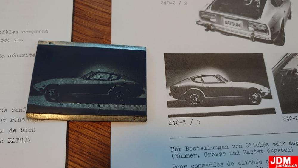

One of the coolest parts here is definitely the 1971 Geneva International Motor show press release folder, including the 240Z and information about the Z beeing shown at their booth.
But what is even cooler. The press release states you can order Lithographic master plates from Datsun (Suisse) SA, for your own catalogue production, and it came with one of those lithography master plates. With exactly the same picture as shown in the press release and which is also used in some of the official swiss Z-documentation:

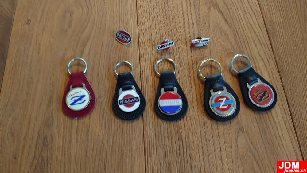

A bunch of key holders. Not sure if any of these where officially released by nissan or if all of them are 3rd party stuff.

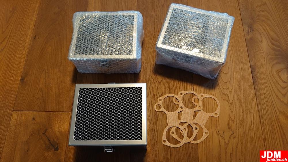

And the cooles part: The "Breadbox" triple mikuni Airboxes, which where used on some of the works rallye cars, and where also optional "competition" equipment.
The ones i got are japanese MS Kubo replicas with slightly different locking mechanism. Original ones are rare to find and expensive. And since i'm not even sure if i can install them here street-legally, i decided not to go too crazy about finding original ones. But then i still liked them so much, i had to have them. Here's a picture of the competition parts catalogue, listing the original ones:

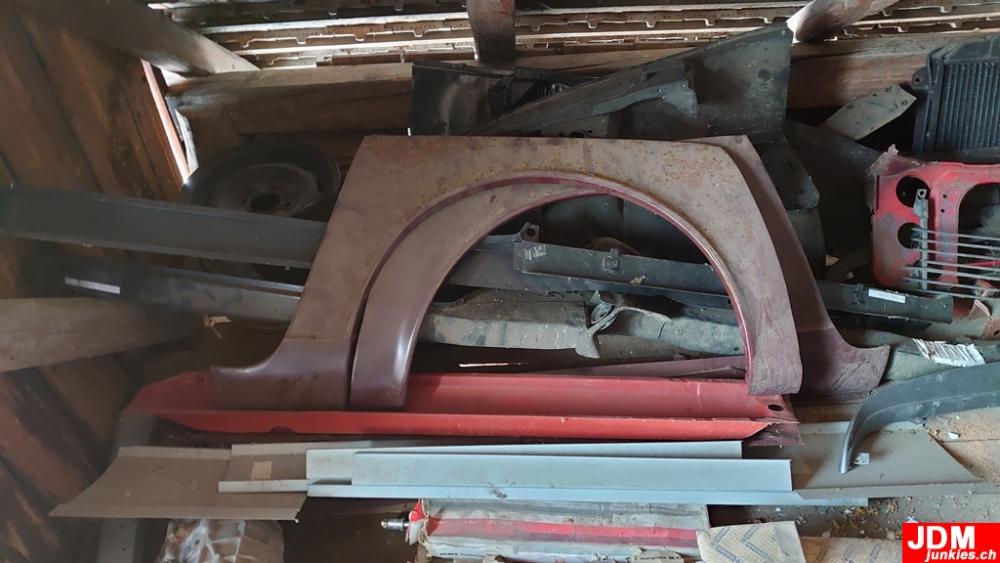

Most of the parts where stored in the upper level and only accessible via an unstdeady ladder. But hey - who cares if there are NOS genuine datsun parts?
I was initially only interested in the sheetmetal parts, mostly the datsun original parts. But they were only for sale as a lot. Well and then we agreed on buying the whole parts Lot including all the used and aftermarket parts too, so he could clear out the whole stock at once.

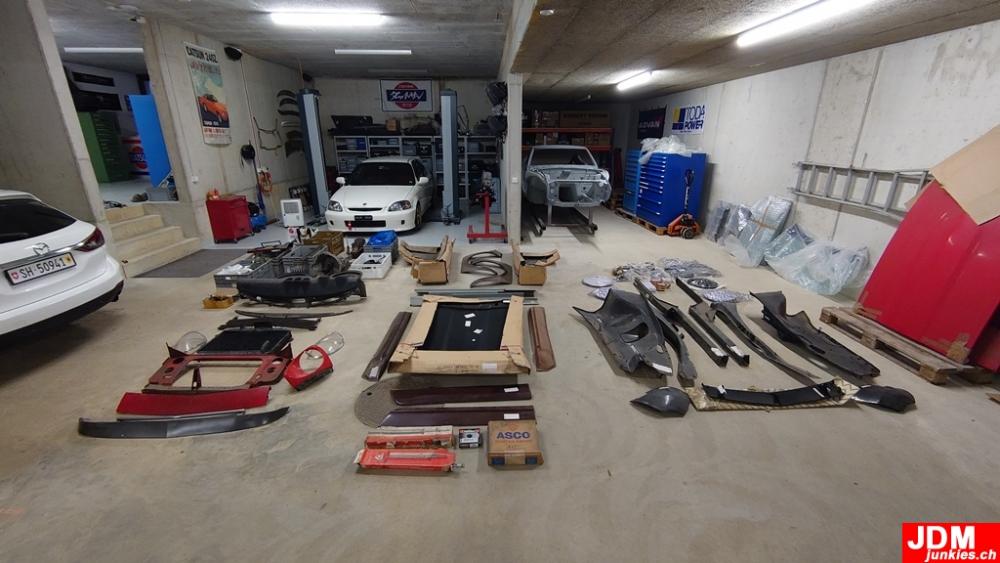

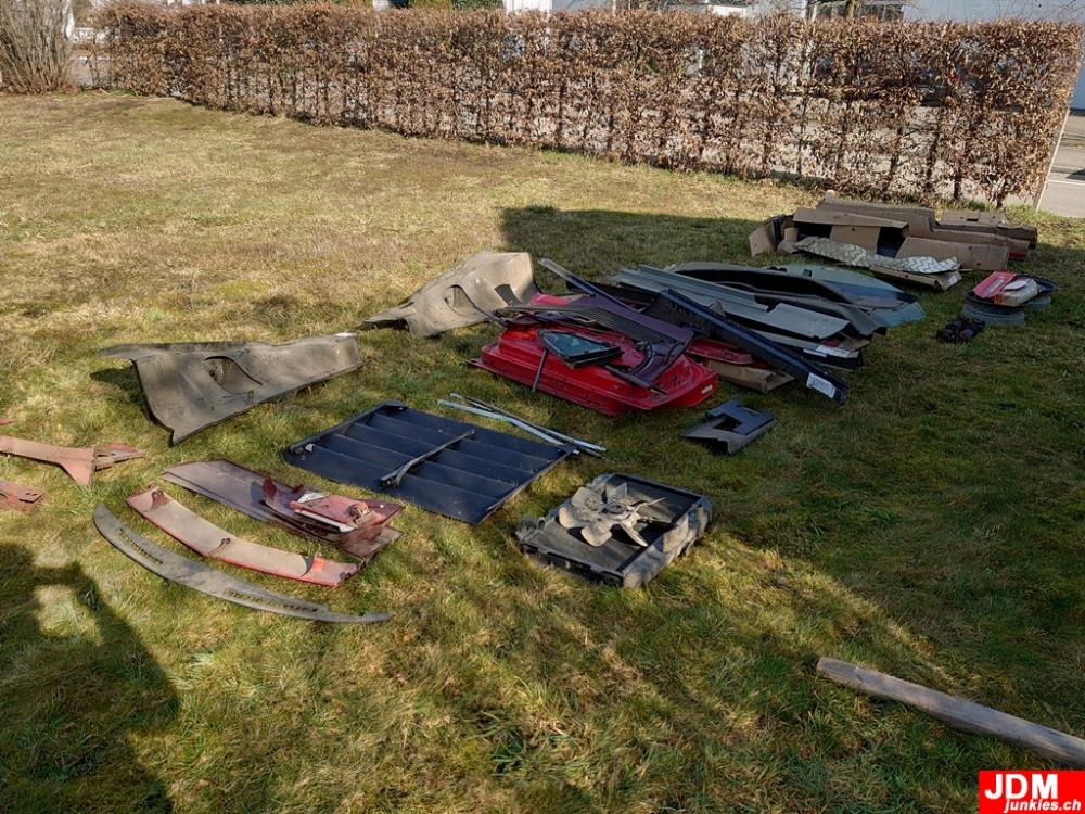

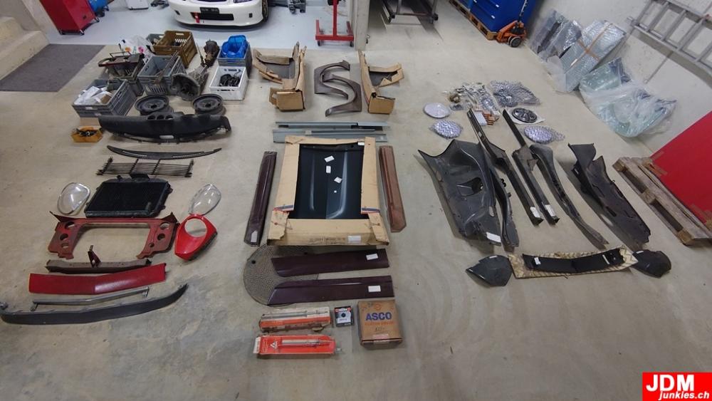

So the last days i spent in my garage sorting through all the parts. I made three piles. Left is used original Parts, Center are aftermarket parts and right are NOS genuine Datsun / Nissan parts. On the wall to the right you can see some additional big items...

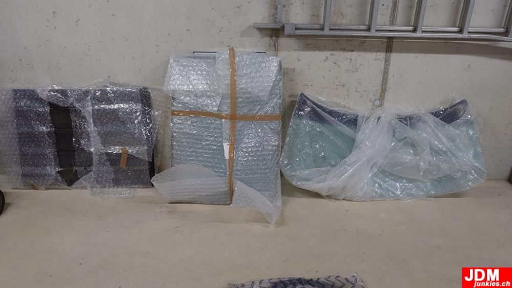

Which includes some funky window louvres, a used hatch glass and a new aftermarket Windshield:

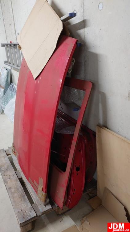

Additionally a set of Doors, hood and hatch from a donor-car:

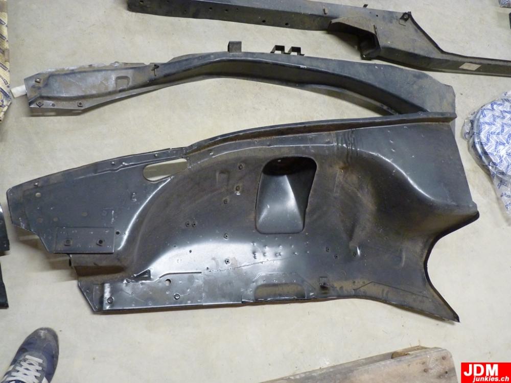

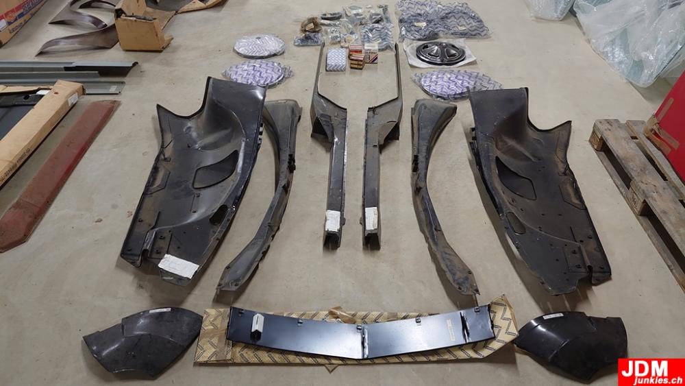

The "holy grail" is definitive the NOS parts lot which includes air-channels, complete front inner fenders, a set of front valances, frame-rails, hubcaps, weather strip, trim pieces and many small bits.
These are some of the parts that will end up on my build, if required. I've been looking for those for many years now, so i'm quite happy i finally found them!

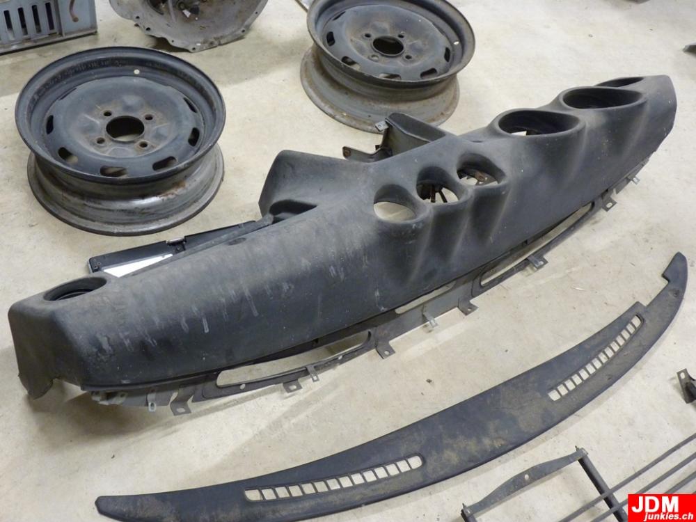

The used parts lot included everything from an uncracked dashboard to original steelies, radiator frame, Headlight covers, an A-type 5-speed transmission, Euro-spec front spoiler, Euro turn signals and much, much more...
The aftermarket-lot included a lot of older, but unused parts from all kind of sources. A complete Hood, 3 front fenders, inner and outer rocker panels, rear lower corners, door repair panels, rear arch repair panels, a set of vintage Koni dampers, Aisin-seiki clutch cover, brake shoes and much more... It has been an exhausting but also very fun and satisfying journey to get all those parts. They're now safely in storage and will end up on some pretty nice restauration projects, which deserve such nice parts!
