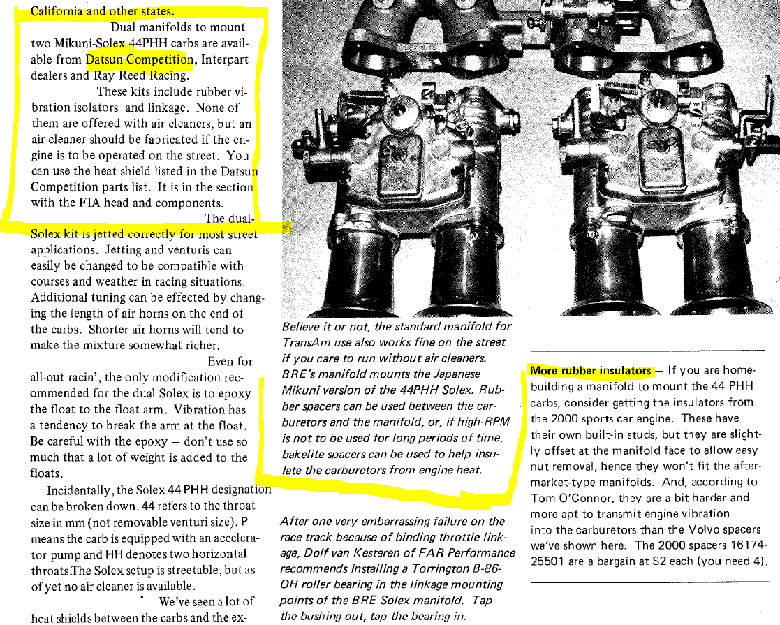

December 9, 20213 yr Author comment_632956 I recently collected a few different Carb insulator setups. mainly just because i first got the wrong ones, and then some more 🙂 Left to right. Original Datsun PHH44, but for the U-series (Fairlady) Engine, PHH44 L-series replica, PHH40 (L-series) Replica: The main difference between the U and L-shaped items are a slight offset in the stud position (see left) What also came in one of those deliveries was a set of NOS rocker arms. Not sure if i will need them, but as you know i can't resist whenever NOS parts get offered: So my "fun" Motor intake side setup is nearing completion. I meanwhile have enough parts to build one standard and one "sport" motor. Also just got a call today that a pallette of parts on the way from japan will arrive next week in the Port of Rotterdam, before being delivered to switzerland (Just as the Datsun parts and cars, back in the days)... So i'm quite excited 🙂 Link to comment https://www.classiczcars.com/forums/topic/44860-my-two-swiss-s30z-fairlady-restoration-build-thread/?&page=54#findComment-632956 Share on other sites More sharing options...
December 9, 20213 yr comment_632957 Surprised to see you intend to use that type of rubberised insulator on a six. I don't recall Nissan ever using anything other than the solid, phenolic type insulators on the sixes. On the L4 yes, but not L6. Link to comment https://www.classiczcars.com/forums/topic/44860-my-two-swiss-s30z-fairlady-restoration-build-thread/?&page=54#findComment-632957 Share on other sites More sharing options...
December 9, 20213 yr comment_632958 and good luck to pass the inspection in Switzerland. the triples without Veteran status yes. the filters and max 73db no way. At least not in Zurich. Link to comment https://www.classiczcars.com/forums/topic/44860-my-two-swiss-s30z-fairlady-restoration-build-thread/?&page=54#findComment-632958 Share on other sites More sharing options...
December 9, 20213 yr comment_632959 46 minutes ago, HS30-H said: Surprised to see you intend to use that type of rubberised insulator on a six. I don't recall Nissan ever using anything other than the solid, phenolic type insulators on the sixes. On the L4 yes, but not L6. The rubber ones are Nismo and were part of a kit Nissan sold for L6. Link to comment https://www.classiczcars.com/forums/topic/44860-my-two-swiss-s30z-fairlady-restoration-build-thread/?&page=54#findComment-632959 Share on other sites More sharing options...
December 9, 20213 yr comment_632962 1 hour ago, duffymahoney said: The rubber ones are Nismo and were part of a kit Nissan sold for L6. 'NISMO' is by definition 1984-up. Pretty late L6-wise. I don't recall Nissan ever supplying them for the L6 until at least (off the top of my head) 1976-ish? That's a long time with the solid phenolic type, which they tended to use on the Works cars by the way. They have a reputation for moving around too much when they get hot. And on an L6, they get hot. They also de-laminate, crack and otherwise react badly to certain fuel additives. Other than that I love them... 😉 Link to comment https://www.classiczcars.com/forums/topic/44860-my-two-swiss-s30z-fairlady-restoration-build-thread/?&page=54#findComment-632962 Share on other sites More sharing options...
December 10, 20213 yr comment_632983 If you weren't aware, the U20 Solex carb insulators (16174-25501) have a gasket either side of them, one manifold, one carb. There are also 50mm versions of these. Link to comment https://www.classiczcars.com/forums/topic/44860-my-two-swiss-s30z-fairlady-restoration-build-thread/?&page=54#findComment-632983 Share on other sites More sharing options...

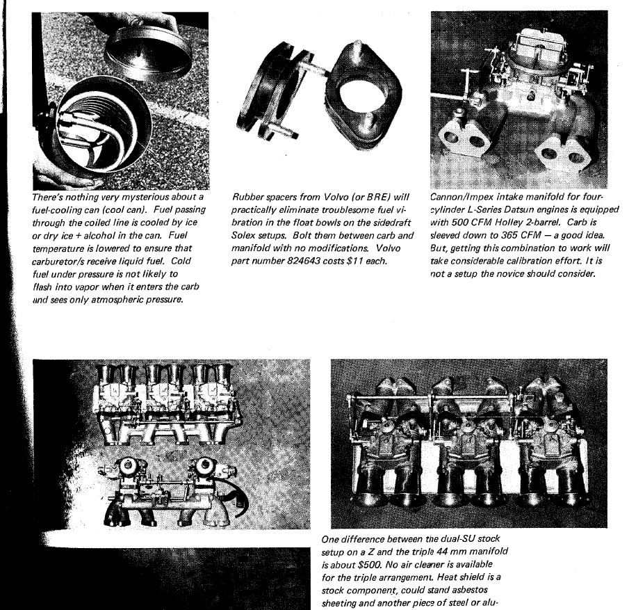

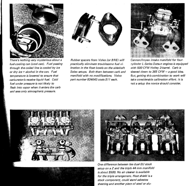

December 10, 20213 yr comment_632986 There's some interesting reading in Bill Fisher and Bob Waar's book: "how to modify DATSUN 510 610 240Z engines and chassis" I have a copy from 1973, it's a good read. Here are a few snippets related to isolators for Mikuni/Solex carbs, Link to comment https://www.classiczcars.com/forums/topic/44860-my-two-swiss-s30z-fairlady-restoration-build-thread/?&page=54#findComment-632986 Share on other sites More sharing options...
