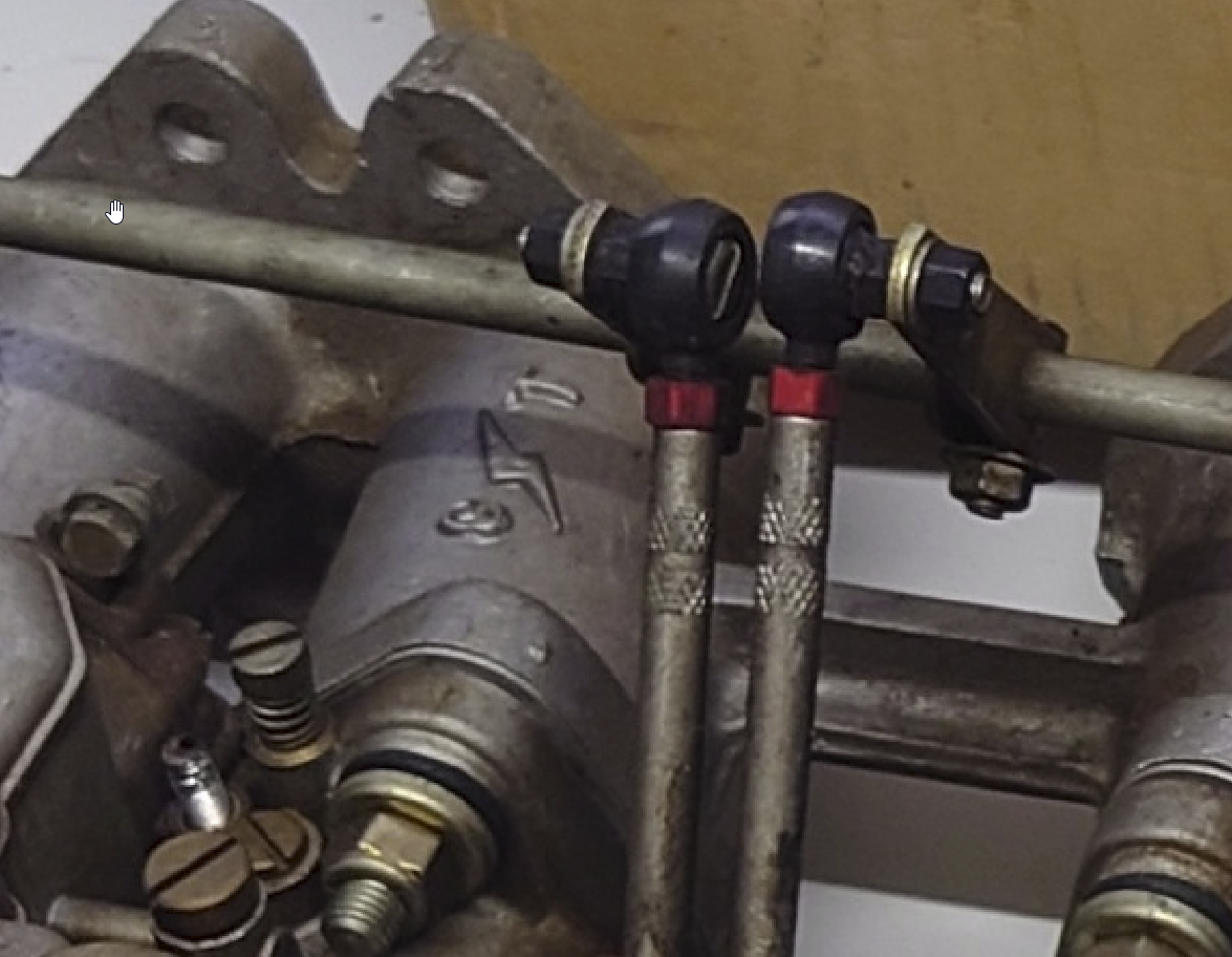

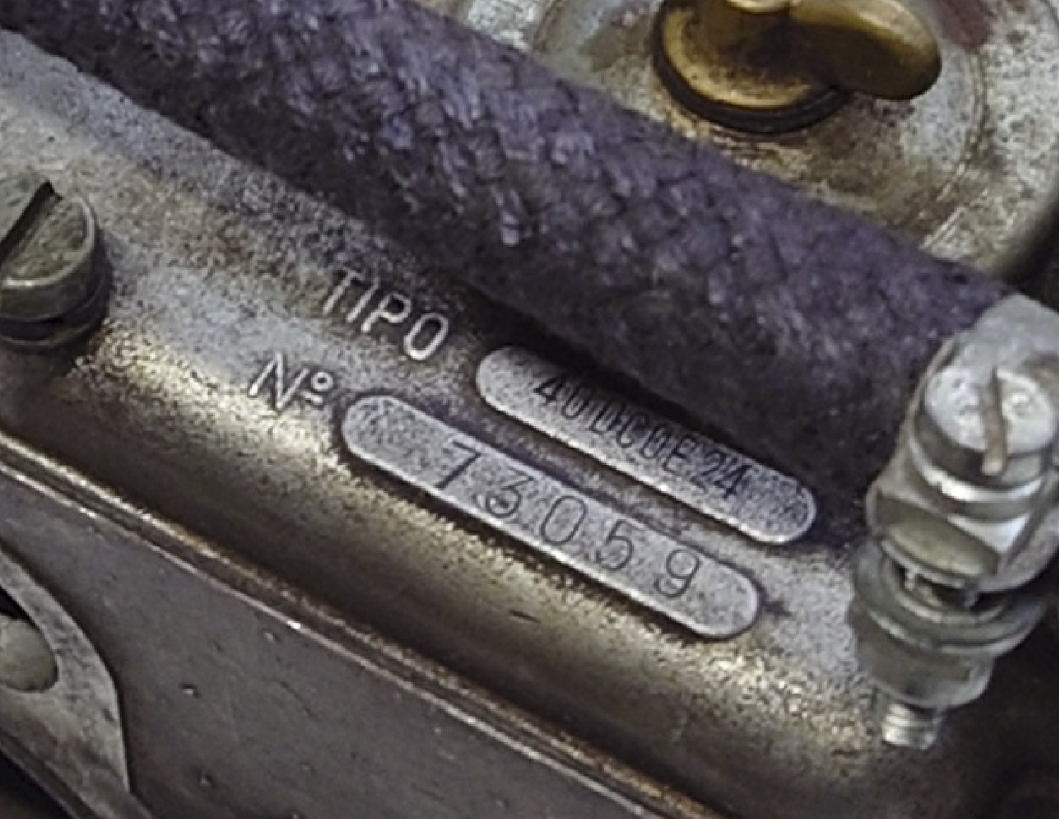

March 4, 20232 yr Author comment_651027 13 hours ago, HS30-H said: A cool part of DSSA history. Thank you for showing it to us. Intriguing! I'm surprised that they chose to use 40DCOE-24 series carbs. Weber's own recommendation as a conversion 'road' kit for the L24 engine was three 40DCOE-18 series and the 24 series was actually only offered as stock (factory) equipment on the 1600cc ALFA Giulia Super. The 24 series had 27mm chokes and 0.35 pump jets, whereas the 18 series had 30mm chokes and 0.45 pump jets. The 18 series also had an accelerator pump stroke more suited to the L24 than the 24 series did. My best guess (take that for what its worth) is that they sourced the 24 series carbs from ALFAs and/or already had them available. The manifold is a new one on me. I can't ever remember - even as a Londoner - seeing the name 'LONDON' cast into a manifold. Your illustration from the Janspeed catalogue shows the '470' casting that - I have always been told - was cast and supplied by Mangoletsi. Janspeed, and others, often supplied the Mangoletsi manifold with their conversion kits. I wonder if the 'LONDON' manifold was also something cast by Mangoletsi for a specific customer? However, I can't think of any L6 specialists in the London area or using the London name. Curious. Here's a Mangoletsi '470' casting manifold that I have in my loft, for comparison. Casting quality is - I have to say - fairly rough: Hmm very interesting. thanks for your inputs Alan. Here' are two more closeup pics. First a detail of the carbs, clearly visible as 40DCOE24: Secondly, the casting marks on the other top-side of the manifold, saing C / T. It may look like a "G" in this photo, but i verified in some other pictures and it's definitely a "C". The casting quality is not that "rough" as the one from Mangoletsi / Janspeed in your pictures (which looks exactly as what is in the Janspeed 1981 catalogue). But the one in the DSSA setups looks like somebody refinished the casting on the bottom side with a coarse file or something. My friend is trying to contact the previous owner to get some more details. I'll keep you updated. Edited March 4, 20232 yr by JDMjunkies.ch Link to comment https://www.classiczcars.com/forums/topic/44860-my-two-swiss-s30z-fairlady-restoration-build-thread/?&page=60#findComment-651027 Share on other sites More sharing options...
March 4, 20232 yr Author comment_651028 A little Update: I found this Post wich mentions the "C/T & London" casting marks refer to a London based company named "Conversion & Tuning", of which i've never heard before: http://www.turbosport.co.uk/showthread.php?t=211869 this page has a short background information about it and an 1971 catalogue with lots of company photos and background information. the logo seems to match: https://mk1-performance-conversions.co.uk/conversion_tuning.htm Unfortunately this 1971 brochure does not contain any Z-related stuff (maybe they just added it later to their lineup), but the catalogue features some other Datsun related parts, so it seems highly likely that it must be this company. Edited March 4, 20232 yr by JDMjunkies.ch Link to comment https://www.classiczcars.com/forums/topic/44860-my-two-swiss-s30z-fairlady-restoration-build-thread/?&page=60#findComment-651028 Share on other sites More sharing options...
March 4, 20232 yr comment_651030 3 hours ago, JDMjunkies.ch said: Secondly, the casting marks on the other top-side of the manifold, saing C / T. It may look like a "G" in this photo, but i verified in some other pictures and it's definitely a "C". Yes! You've got it. Definitely 'Conversion & Tuning Centre Ltd' of Brixton, South London. I didn't see the 'C T' logo cast into the manifold in your previous post. Very distinctive. The only other big London-based specialist supplier of carburettors, inlet manifolds and conversion kits from that early 70s I can remember was Chris Montague Carburettor Co. in North London (my side of town), and which I am old enough to have been a customer of. Gone now. They really knew their stuff. I bought my John Passini-authored Weber 'bibles' from them in the late 1970s. My *guess* is that Mangoletsi may have cast some manifolds for C & T London with their logo on them. It probably would have been too expensive for C & T London to have commissioned their own castings with such a relatively small market already covered by Mangoletsi. I would say - judging from the photos - that the C & T London version looks like a neater casting than my '470' Mangoletsi, but that may have been down to batch quality differences? Having said that, other '470' manifolds that have passed through my hands in the past (often from period 'Samuri Conversions' cars) are equally poor castings, so they seem to have been pretty consistently poor. Could C & T London have insisted on a better casting, with their name on them? Seems feasible. Just as an aside for your friend; if he uses this 40DCOE-24 setup on an L24-based engine he might want to try changing to short (10mm) accelerator pump rods and 0.45 accelerator pump jets, as used on the 40DCOE-18. I have recommended this a few times for others with positive results. The Nissan L6 seems to 'like' a short, sharp accelerator pump action on the DCOEs. John Passini covered the topic in his books. Recommended.   Link to comment https://www.classiczcars.com/forums/topic/44860-my-two-swiss-s30z-fairlady-restoration-build-thread/?&page=60#findComment-651030 Share on other sites More sharing options...
