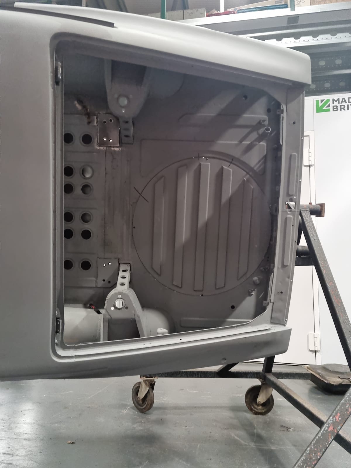

September 12, 20231 yr comment_656960 I didn’t know that Mizukami Auto produced such a nice roll-bar! I would like to see it in person if I like to have it in my car. A set of flat plates which is going to be welded on the rear floor as for securing the bottom brackets isn’t not shown, is that included? I attached a picture of genuine roll-bar which was sold on Yahoo auction, I still regret that I didn’t make a bid. Recently I became to know that the seller of the roll-bar was my GTR friend! This original set was also missing a set of flat plates. Maybe it was very difficult to take off the plates from the rear floor. Kats Link to comment https://www.classiczcars.com/forums/topic/44860-my-two-swiss-s30z-fairlady-restoration-build-thread/?&page=65#findComment-656960 Share on other sites More sharing options...
September 12, 20231 yr Author comment_656961 Beautiful rollbar you found there. It's not often they pop up for sale these days. Yes the two detachable plates are included. see grey plate in the picture below from my Mizukami replica: Link to comment https://www.classiczcars.com/forums/topic/44860-my-two-swiss-s30z-fairlady-restoration-build-thread/?&page=65#findComment-656961 Share on other sites More sharing options...

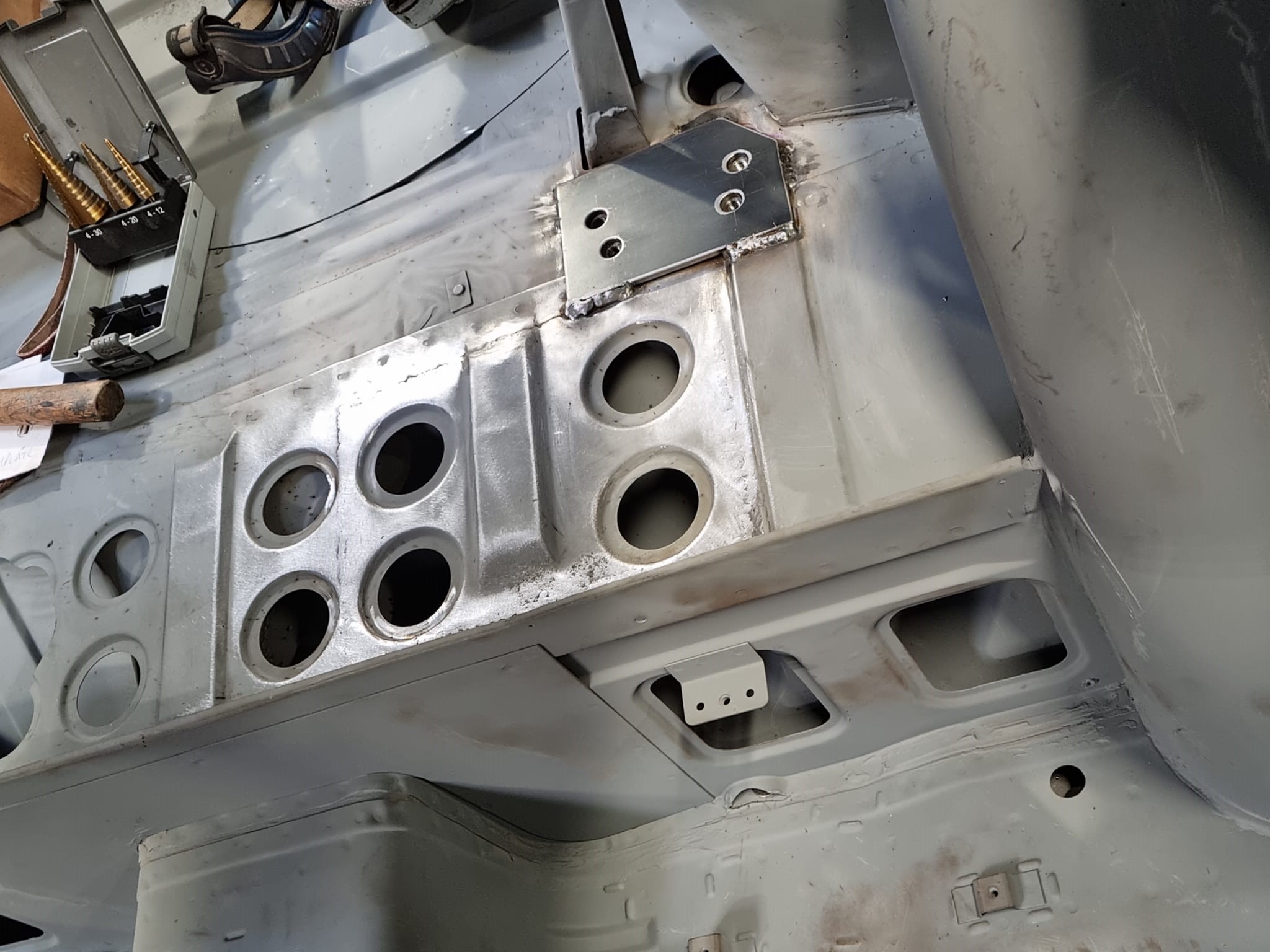

September 12, 20231 yr comment_656963 2 hours ago, kats said: This original set was also missing a set of flat plates. Maybe it was very difficult to take off the plates from the rear floor. 1 hour ago, JDMjunkies.ch said: Yes the two detachable plates are included. see grey plate in the picture below from my Mizukami replica: Technically, I believe the two flat plates that sit underneath the two vertical drop mounts were meant to be welded to the rear deck floor. That would be a good reason for them often disappearing when the bars were removed from cars and sold on. I've got a 'normal' Nissan Sports/Race Option 4-point bar kit in my 432-R replica car, and an original Nissan Works rally version in my ongoing Works Rally 'Test Car' replica project. The difference is that - on the Works Rally type - they moved the two vertical drop bars and mounts further apart so that two stacked spare wheels/tyres could be carried onboard, and they added a steel arrestor strap and a hinged clasp to hold them down (adjustable for one, or two, spares). All the side mount points are in every car, so they are a bolt-in. It's just the vertical drop mount plates that need to be added. Here's how the Works style plates were welded into my 'Test Car' project: Link to comment https://www.classiczcars.com/forums/topic/44860-my-two-swiss-s30z-fairlady-restoration-build-thread/?&page=65#findComment-656963 Share on other sites More sharing options...
September 12, 20231 yr comment_656966 59 minutes ago, HS30-H said: Technically, I believe the two flat plates that sit underneath the two vertical drop mounts were meant to be welded to the rear deck floor. That would be a good reason for them often disappearing when the bars were removed from cars and sold on. I've got a 'normal' Nissan Sports/Race Option 4-point bar kit in my 432-R replica car, and an original Nissan Works rally version in my ongoing Works Rally 'Test Car' replica project. The difference is that - on the Works Rally type - they moved the two vertical drop bars and mounts further apart so that two stacked spare wheels/tyres could be carried onboard, and they added a steel arrestor strap and a hinged clasp to hold them down (adjustable for one, or two, spares). All the side mount points are in every car, so they are a bolt-in. It's just the vertical drop mount plates that need to be added. Here's how the Works style plates were welded into my 'Test Car' project: Super fascinating Alan!! I wish I could have either type of roll-bar, it is a long way to achieve it. Thanks for the pictures JDMjunkies.ch and Alan, I am (I am sure we! ) looking forward to seeing the both car when complete. Kats Link to comment https://www.classiczcars.com/forums/topic/44860-my-two-swiss-s30z-fairlady-restoration-build-thread/?&page=65#findComment-656966 Share on other sites More sharing options...
