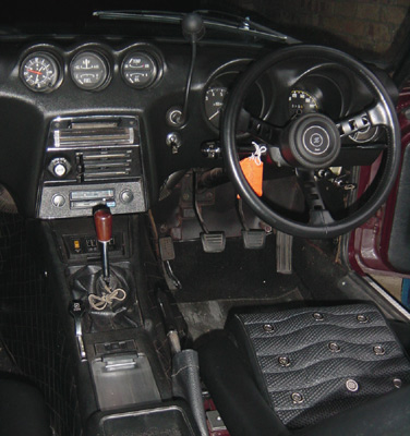

Here's a picture of the controls layout on an RHD car:

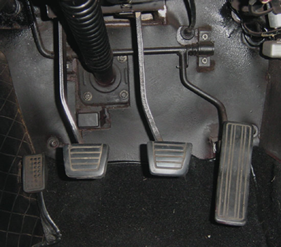

and here's a picture of the pedal layout in an RHD car ( I think you can see that there is plenty of space down there and nothing is difficult to use or unergonomic ). Notice the clutch-foot rest next to the tunnel and the space around the throttle pedal. Its all pretty well laid-out down there.
Apologies for the dirt and dust..........

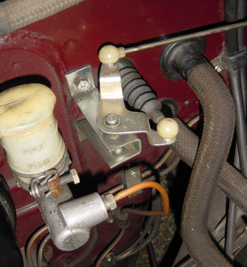

and here's part of the throttle actuating mechanism on an RHD car:
( Again - apologies for the grime. Nothing like a close-up flash photo to remind you its time for a Spring clean.... )

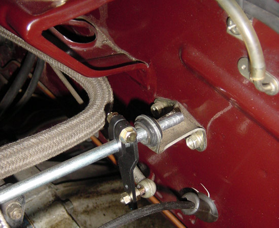

and here's what happens at the other end:
NOTE: Some of these parts were also used in the throttle linkage of the S20 engine in the 432, which of course had its carburettors on the opposite side of the engine to the L-series.
Apologies for the non-standard carburettors on my particular car, but I think the firewall part of the linkage is what's important here. As far as attachment to the original SU's goes, you can see the parts that are different from LHD versions.

With that being said, I'm glad that I'm not driving a RHD with a short reach. Case in point? The heater controls, specifically the fan switch would be a bit of a reach on a RHD car, where in a LHD car it falls easily in hand for most anyone.
The choke control also falls easily in hand in a LHD car whereas in a RHD it could be a bit awkward to use if the car is parked and the e-brake is on, you would have to reach over the handle to use the choke when the e-brake is engaged.
I guess what you RHD owners would consider to be awkward to use in a LHD car, we would also consider some things as being awkward to reach in a RHD car. Mostly it's just a matter of what we have become accustomed to.
I did notice there seems to be very little room for your foot between the "dead pedal" and the clutch pedal. While on the LHD there is plenty or room to move your foot around. You get room on one side while we get room on the opposite side....

Well, Zedrally gets the bonehead of the day award. (All in fun, no offense intended.) From his post in reply to my query as to the ignition switch and the combination switch on a RHD vehicle:
Ignition on the RH side and combination is the same.
From that I gathered that the ignition key would be on the RH side of the steering column and that the lights / indicator assembly would be the SAME as a LHD car. Which as Alan mentioned would be a major PITA to work with, especially in areas / cities that require all turns / changes in lane to be accompanied with the appropriate turn signal.
Alan's pictures on the other hand, clearly show the ignition on the LEFT of the column and the combination switch and indicator stalks CLEARLY REVERSED. As would be proper for a RHD vehicle. I can't make out the writing, but I will suppose that the writing on the light switch is correct and not upside down.
OR.....
Could the Australian RHD vehicles have come out with LHD combination switches and ignition shrouds?
This could become a very interesting thread even more than it already is!
So, maybe Zedrally doesn't deserve a bonehead award.
But it does bring up more questions than it answers.

The throttle linkage for the RHD is extremely interesting. I note that there is an angled shaft that has TWO pivot points behind the brake and clutch pedal BEFORE it travels upward to then pull the throttle rod. Then on the engine side of the firewall, it again has another long shaft. I was hoping to see that the RHD had either eliminated or dimninished the angle of the rods so that it might not have the inherent "throttle jerk" because of the angle imposed. I guess that the RHD cars also suffer from it.
I also note that the Heater Control Panel Levers all go to the left. Just a point that clarifies some of the points I'd made earlier.
This has been extremely informative. Thanks Alan.
On a final note, I note that your Horn Button has a Z instead of Datsun. Yet the year of the console and similars imply that it's a 72-73 240. Care to comment?

I apologize for digressing and to answer the question regarding pedal location; I have not found it to be a problem in 13+ years of driving these cars everyday.:ermm:
Yes, I was about the ask the same thing about Alan's car Escanlon - why do you have a Z pad in the middle of the steering wheel? I thought it should be DATSUN?
As for room between the clutch and the foot rest, there is more than enough room in there - the pictures may look a little deceptive however. Or maybe I just have small feet?! LOL
Escanlon, I dont see how in those pictures you can clearly see the ignition on the left. I think it is just a tag attached to the windshield wiper/headlight stalk? As far as I know the ignition in all RHD cars is on the right. Indicators on the left.

Morning all,
Don't forget that my ZG is a Japanese Home market only model. The Japanese Home market cars had almost nothing on them identifying the "Datsun" branding of the export cars..............
This even went down to the detail of the door sill step finishers, which were plain instead of "Datsun" scripted.
Also, the steering wheel on my car is a rather rare "Datsun Compe" item - and can use the steering wheel boss from the stock steering wheels. I have chosen to use it with the Japanese Home market "Z" script boss - which the car would have originally had on its steering wheel.
Japanese market Z cars hardly had the "Datsun" brand on them anywhere. In fact I'm trying hard to think of a component that had the Datsun brand on it - but can't think of one.
In Japan the Z is a Nissan - not a Datsun.
Alan T.
