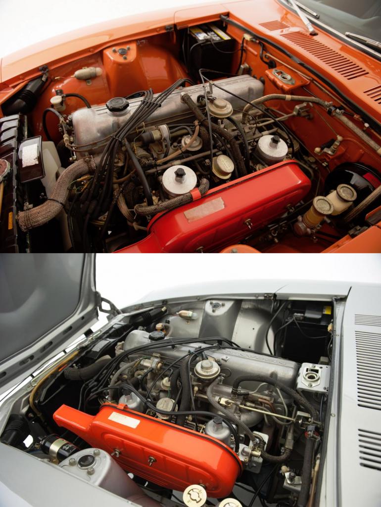

Some photos of the engine compartment that you requested. Original carbs going back on and bad hoses and unoriginal clamps have been replaced already. Car came from same dealer as orange one.
Mark
Hi Mark:
Thanks - very nice looking engine compartment, that looks like a super low mileage example. Of course if you to the original carbs back on - you'll have to install all the original fuel line wraps etc. The yellow dot on your fuel pump shows that it was returned to the Dealer for Fuel System modifications as well.
Look at the Cad Plating on the parts on your engine and then look at the one Advertised. The amount of grime on each, the condition of the blue paint on the block etc. The staining and grime on the valve covers. I'd love to go inspect the Car Advertised...
I still say that even given the super low mileage is correct - the car still needs a lot of elbow grease to bring it up to a standard that could command something above $20K in todays market. I do know a few Collectors that LOVE super low mileage near perfect examples - and they have paid silly money when they find the right car..
FWIW,
Carl B.

Just went through the pictures again. That interior says 8K miles. Very little sag in the seats, clean wood on the steering wheel as well as the black paint, although it may have been touched up. The foot pad on the floor mat is intact and it looks to be the correct carpet. Radio knobs are very clean. Very nice interior indeed.
In spite of the muffler discrepancy, the chrome in the muffler area is very clean. On my ’70 with 97K miles, the exhaust has definitely effected the chrome finish and rubber in that area. The chrome and rubber finishers look to be very clean on this car.
Now, how to explain the engine? So many scenarios here. Owner could have used an engine cleaner on it and not rinsed thoroughly before running motor hot. Car could have been kept in a coastal environment with salt in the air. Maybe in an industrial area where dew point would cause water to be slightly acidic. These last two might also effect the rear muffler. Hard to say. Would really be nice to have a set of eyes trained eyes look at this and report back. Sometimes pictures are very forgiving of a cars faults.
Mark

Hi Mark:
FWIW,
Carl B.

Hi Jeff - Yes, I know the car. It was originally sold here in Florida. Two or Three people that all worked at the same place had owned it one after the other. Our friend in Atlanta talked to all of them before he bought it. I located several of the 240Z's that wound up in his collection. Over the past 15 years or so - I've personally seen about 25 240Z's with less than 25K original miles on them. If they were driven and garage kept - they all had cleaner engines than the subject car being advertised. That Silver car was kept in a Car Port for more than 10 years before it was sold - but it has always been a beautiful example.
Mileage is important but it is only one factor that goes into the value of the car - Condition is perhaps the Top Factor. Our friend in Florida, then our friend in Atlanta owned a White 72 with 16K original miles. I was there when it came off the truck from California. We went over that car for more than an hour trying to find one thing that wasn't perfect - couldn't find it. Engine Cad Plating everything still looked like the day it was on the showroom floor. As clean an undercarriage as the day it was produced..
8K, 18K, 28K original miles doesn't matter - the condition of the engine in the Z that is the subject of the Thread knocks the car out of the Top Money category. Not to mention none of us have a clue what condition the fuel system is in etc etc.
Just my opinion..
