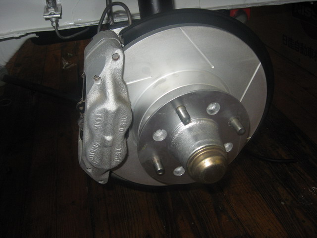

What do you think of the 4-piston calibers, that were available thru Datsun Competition years ago, with stock rotors on a street car?

I think they are unobtainium gold! I've never even seen a set and I've been around these cars since they were new. But speaking to my original point, they are not necessary on a stock car.

Now you have! See attached photo.

Nice. Four piston, not a heck of a lot more mass than the stock Sumitomo's. STILL not necessary for street use. Are these yours?

Yes. I purchased them in the early 90's. The stock backing plate was retained, but notched to clear the
