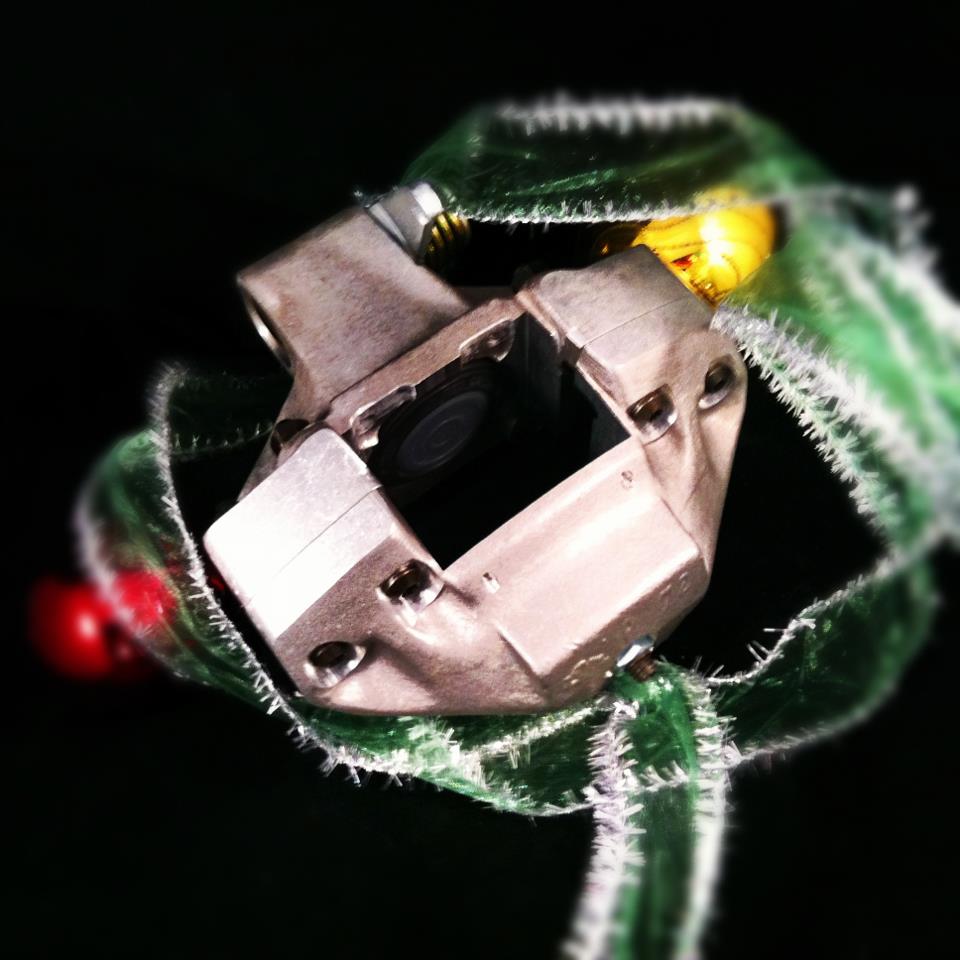

November 28, 201212 yr Author comment_407905 Here is an example of what we are doing with 914 brakes. These are a reverse-engineered set of Porsche brakes. They weigh in at a whopping 3# each and shave 10# off the rear of a 911 or 914. They also happen to be the same brakes fitted to the Ferrari 308 series. Performance numbers are the same with the exception that they give up heat so much faster. We are thinking we might want to do the same with the Datsun Competition Sumitomo calipers if we can get our hands on a set. Pardon the Christmas marketing photo... Link to comment https://www.classiczcars.com/forums/topic/45000-now-thats-a-brake-upgrade/?&page=4#findComment-407905 Share on other sites More sharing options...
November 28, 201212 yr comment_407907 The thing I'd worry about with an Al caliper is deformation, especially with a large brake load applied at high temperatures. The dimensions of something like a Z-car Sumitomo caliper are based on the properties of steel. Was there any structural analysis done on the Al calipers? Any strenuous track testing? Link to comment https://www.classiczcars.com/forums/topic/45000-now-thats-a-brake-upgrade/?&page=4#findComment-407907 Share on other sites More sharing options...
November 28, 201212 yr comment_407909 Caliper flex is not a good thing. Link to comment https://www.classiczcars.com/forums/topic/45000-now-thats-a-brake-upgrade/?&page=4#findComment-407909 Share on other sites More sharing options...
November 28, 201212 yr Author comment_407912 We have engineers. 8) Flex apparently is a function of the fastener. The fastener in this case is more than adequate to prevent flex.Oh, and to answer Leon, yes they are track tested. Link to comment https://www.classiczcars.com/forums/topic/45000-now-thats-a-brake-upgrade/?&page=4#findComment-407912 Share on other sites More sharing options...
