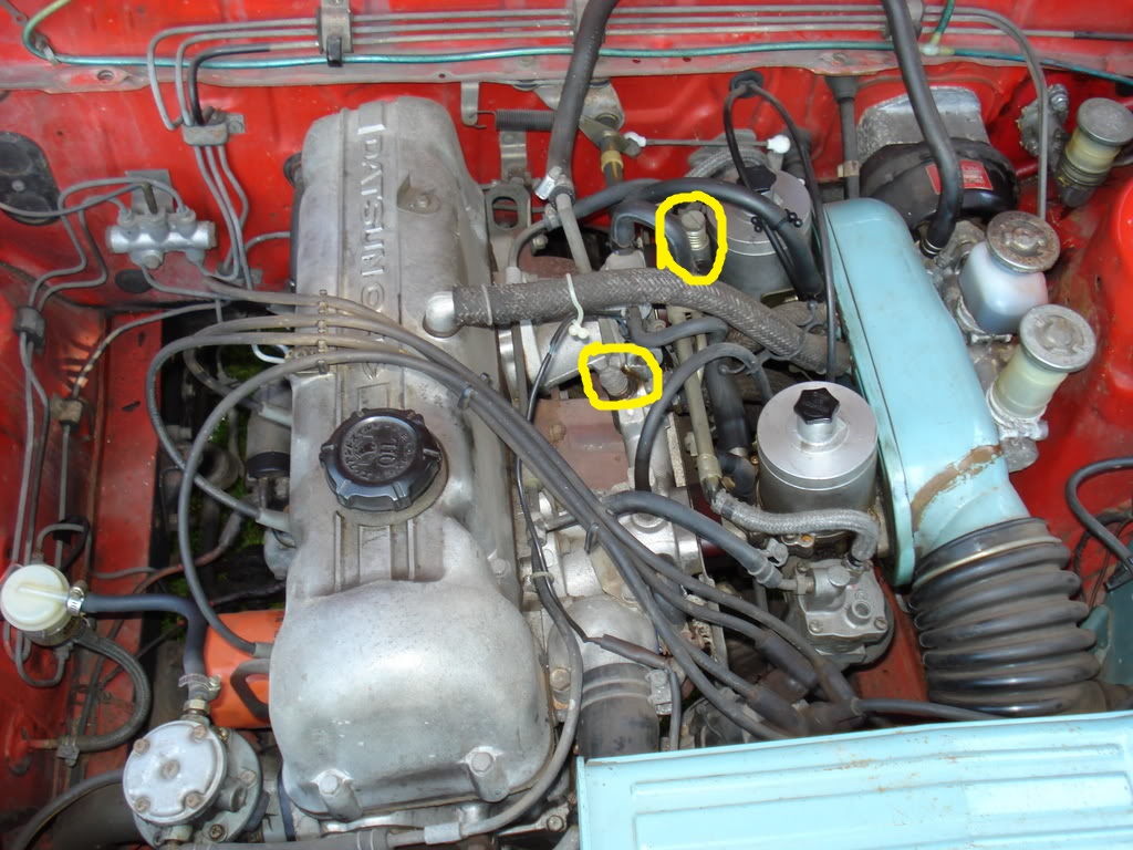

i have a L18 datsun 720 ute with twin flat top su carbs(Hitachi) but i cannot get the idle low+balanced yet everything is loose(undone) 1 su is very unbalanced
i have found how ever there are 2 other screws that no body mentions at all these are outlined in yellow in this pic i have added (note)not of my ute but exactly the same as what i have

The location of the back screw isn't quite right, but look on page EF-19 of the 1974 260Z FSM. You can find it on the XenonS30 website. IIRC, the American flattops are not quite the same as the flattops in other markets, but the manual may help you anyway.
Any time we send out a set of those SSS1800 flat tops we remove the pieces on the bodies just behind the domes and block off those holes so that takes whatever's there out of the mix. What the circled item on the balance tube/manifold is is anybody's guess. Just make sure it doesn't leak.

The circled screw on the rear carb is your idle mixture screw. It meters air around the suction pistons to lean out the mixture coming through the venturi.
The circled screw between the two carbs on the balance tube is your idle speed screw. It meters the idle mixture into the balance tube which is then split for front bank and rear bank.
Not having messed with a set of those carbs personally, I would expect the procedure to be... a) Get it to run well and have it be synchronized above idle. For that you would use the nozzle drop adjustment for mixture and the throttle plate opening adjustment for speed. Then B) Once you have it working above idle, go back and work on the idle performance using the idle mixture and idle speed screws.

so what i have to do is screw in the idle speed adjusting screw(to get low idle) and also screw in the idle mixture adjusting screw(to have air balanced between the carbs), balance the carbs using there idle screws and she be done. i hope it doesnt play havoc with the anti dieseling solenoid LOL
In theory, any changes that you make to the idle mixture and idle speed screws should have the same impact on each carb. The air that is metered by the mixture screw is supposed to be split evenly into the two carbs, and the idle air out from each carb is supposed to be the same as well. In theory at least.
That said, if you crank both of those screws fully down, then your carbs should operate just like all the standard Z round top carbs. Use the high speed idle screw (I assume there is one of those) to simulate an idle circuit and sync and tune just like you would any round top. Then once that is done, you should be able to release the high speed idle screw and open up the idle speed screw instead. You will probably have to mess with the idle mixture to get it right at that point, but if everything else is working right, it should fall into place. The theory would be that you run a little rich at idle using the nozzle drop, and then lean it out again using with the idle mixture screw.
