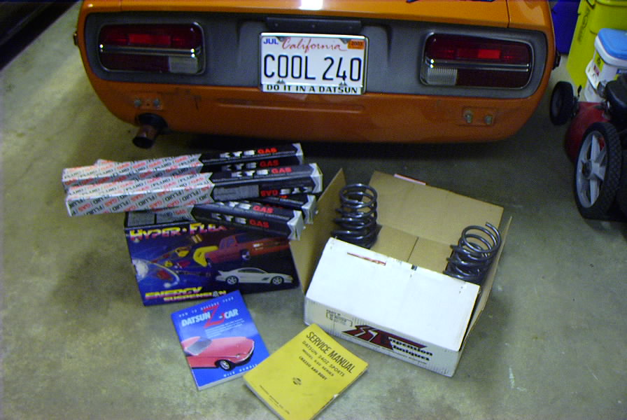

Posted January 31, 200322 yr comment_25124 Well, the UPS driver has delivered all my goodies from shox.com. And very quickly I might add (ordered Saturday, everything here by Thursday). This will be the first time in my life I’ve ever done any type of major suspension work. I scanned through the many archives of various Z car Web sites and learned the value of having a propane torch at the ready to win the battle against the control arm bushings, and the great books of wisdom will be close at hand. Any prayers or additional advice/warnings would be most welcomed before I take the plunge. :eek: Link to comment https://www.classiczcars.com/forums/topic/4503-wish-me-luck/ Share on other sites More sharing options...
January 31, 200322 yr comment_25133 I didn't see a Haynes Manual in your picture. They are handy to have also. Not necessary, but very handy & helpful.Be Careful with the Spring CompressorTake your Time, Examine each item before you disassembleUse the Correct Tools in the correct mannerTORQUE everythig properlyIf anything is questionable, fix it NOW.Use the Torch outside & Have a bucket of water handyStop and ask questions when neededDO IT RIGHT THE FIRST TIME!Good luck! Link to comment https://www.classiczcars.com/forums/topic/4503-wish-me-luck/#findComment-25133 Share on other sites More sharing options...
