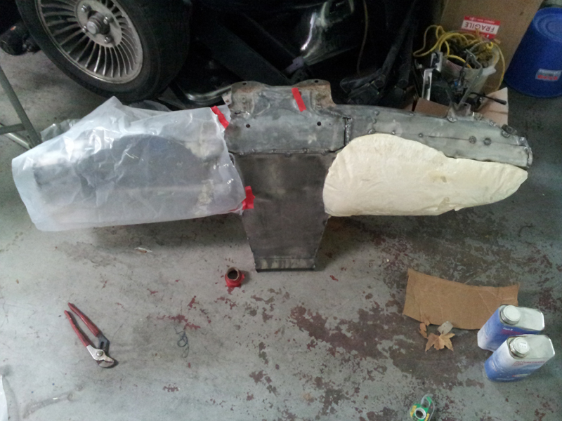

Boom! Driver side panel left of gauge cluster almost done. Space for buttons, and the shroud over the cluster in place to provide a rough base for the foam shroud to follow. Notice on the right side of the shroud/arch thingy that it needs to be cut. This is due to the fact that the dash actually forms a semi circle around the occupants. The gauge panel was welded in at a 90 degree angle (ha.....or thereabouts) to the driver. The shroud was welded in parallel with the panel. But the dash angle as you move toward the center is AWAY from the driver and toward the firewall. So I had to trim down the shroud down on the right to make it meet the left side of the center dash better. See following pics for this.

Shroud Comparison 1. Here is what I'm talking about below in regards to making the right side of the shroud end up further toward the firewall than the left. In this picture it is symmetrical, but look at the angle needed to meet the center dash! It would be nearly impossible to do this and make it look good.

Shroud Comparison 2. Here is where it is finally trimmed and a mock-up made from cardboard is installed. The right side of the cluster shroud is now trimmed further toward the firewall, making the gauge cluster shroud unsymmetrical, but ultimately making the center dash more symmetrical and reducing the need for a crazy angle to meet the right side shroud with the left side center dash. LOL, that was a mouthful.
Looking pretty darn good, in my opinion.
Ugg... Cardboard looks like crap from this angle. They'll be a lot of foam filling in the left side of the shroud curve. Don't worry, LOL.

Shroud Comparison 3. NICE! Love this shot. Really shows the angle cutout on the right side cluster shroud. :D
That's it guys, let me know what you think. I was gonna post a video of me grinding down the frame in prep for the shroud, but it was just too long and boring. :(

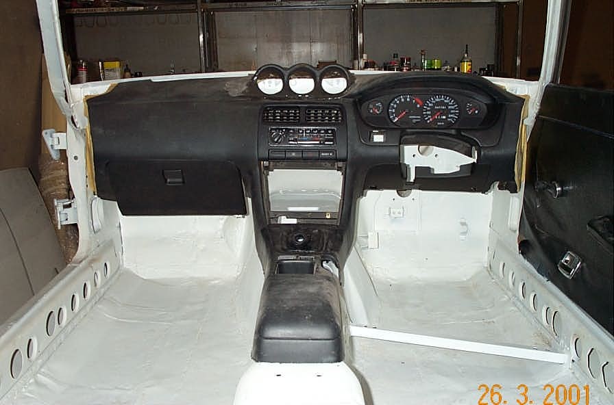

Whoa! Yes it does, but I really wanted to go out there as far as the passenger dash and center console does. The 240sx also has a rounded instrument cluster, as do many 90s cars, but they're either hard to adapt or don't have the modern curves. This dash should be clearly set very apart from other dashes, and better yet, will bolt right in. :D But yes...takes a lot of work.
Are you working on a mercedes dash swap-in right now?

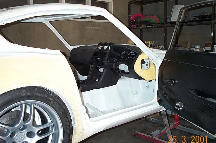

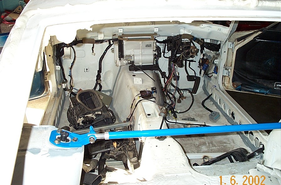

No, its not my project. I just stole someone's dash swap pics off the net. This 200sx dash swap looks like the old z dash with the 3 gauge pod on top but more modern. It looks like they cut off the ends. Probably a real pita putting ends on that one. It was done in oz if I remember correctly.
I do like the addition of the airbag with the more modern dashes. The 200sx heating and a/c unit looks close to the 280z unit doesn't it?

Oh sweet, that looks great! Yeah the heating component does look really similar. This dash opens up so much space in the dash I believe I will be forced to modify a much more modern heating and A/C unit. Might have to pull one out of those smart cars, Ha! :D Actually, hoping to go with a GTO or infiniti A/C and heating if it will fit. I would love to fit an airbag in the dash and steering wheel, but I'll be upgrading to a racing wheel and my car will have a full roll cage, so the harness should keep me inside....hopefully, LOL.

So what I finished doing was the right side of the instrument cluster and the center dash. I really don't like how the right side of the cluster turned out because it looks like a dent, so I am going to go ahead and foam in that area and level it off close to the center dash curve. The dash is now out of the car, as you will see in later pics. It came right out with no problems, even after all that welding. :)

Center panel installed for a test run of what it will look like and maybe what the general curve will be.
Ugg, that dent I "made" on the right side of the cluser looks bad. Definitely going to be using a lot of foam to level it out with the left side of the center dash.
Might be able to actually fit this center console in here, maybe....
