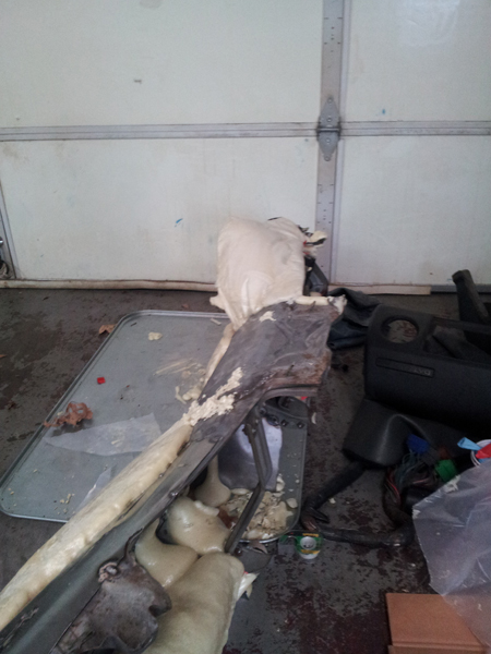

Hi all! Here are some updates on the dash. I apologize for the delay. I went ahead and have been doing work on the dash without doing updates. Medical school just started again today, so I am stretched for time like crazy now. With my BMW project done and my buddy back from break, we'll try to work hard on it over the weekends. Just not going to happen that much during the week as I need to study. Here's where we are now:

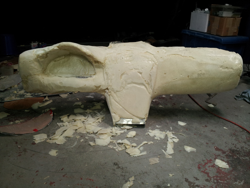

  • I finished foaming the entire thing

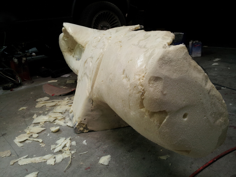

  • I shaved and sanded the foam to shape
  • Jon (fellow student) and I started applying bondo and finishing the last shapes
  • We poured a little extra foam over the instrument hood because it was just gonna be too much bondo. :P

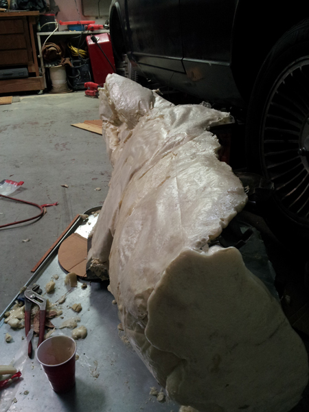

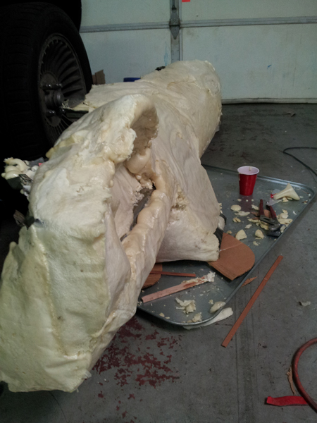

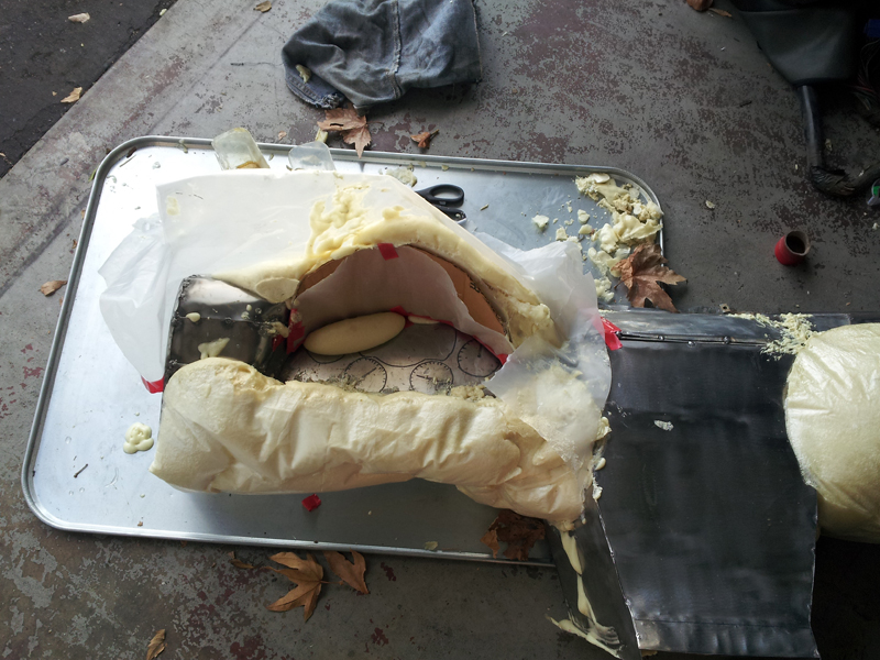

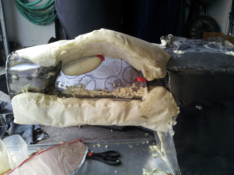

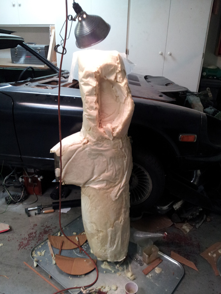

Starting to pour the center part of the dash. This was actually the most fun in my opinion because it transformed the dash so much...
Edited by ZohanIsBack

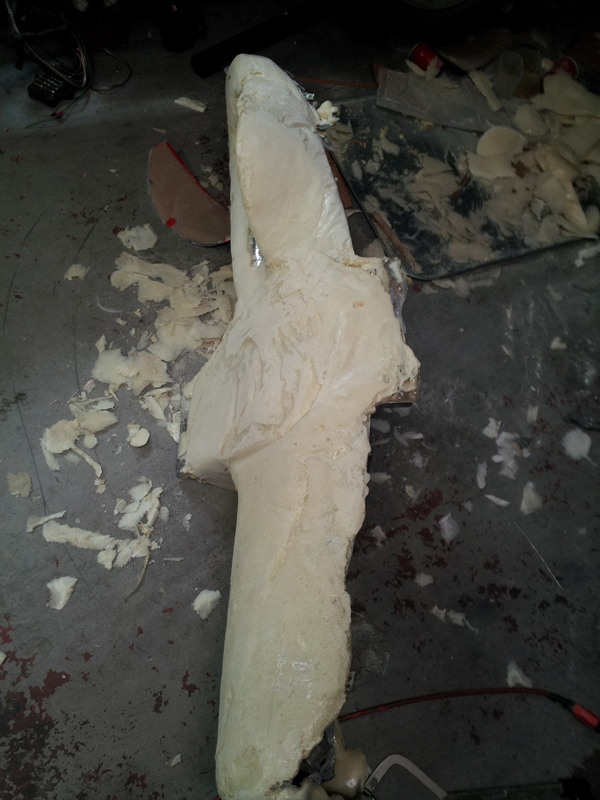

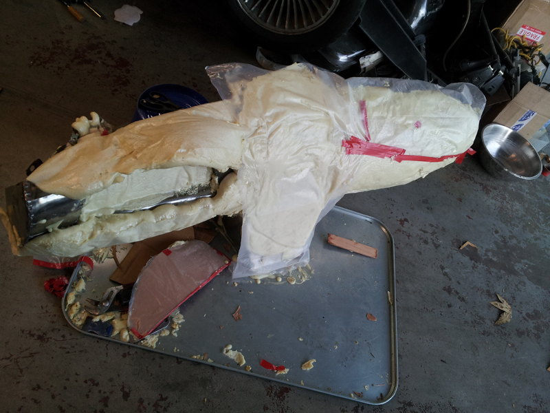

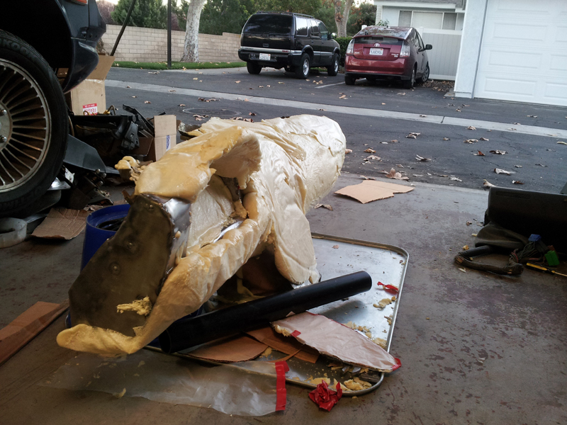

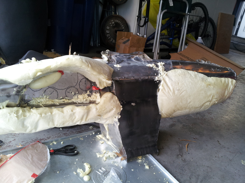

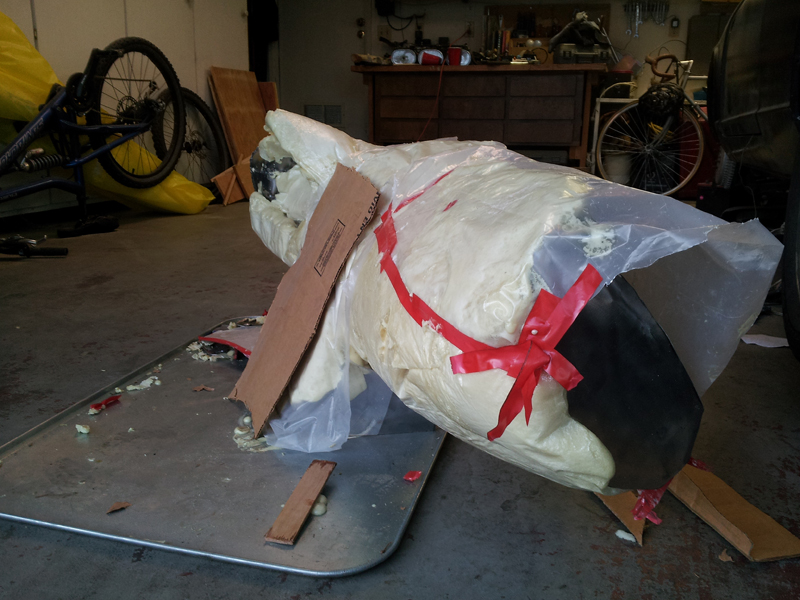

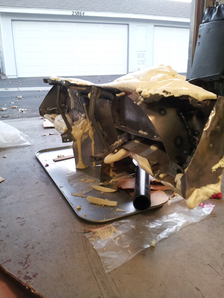

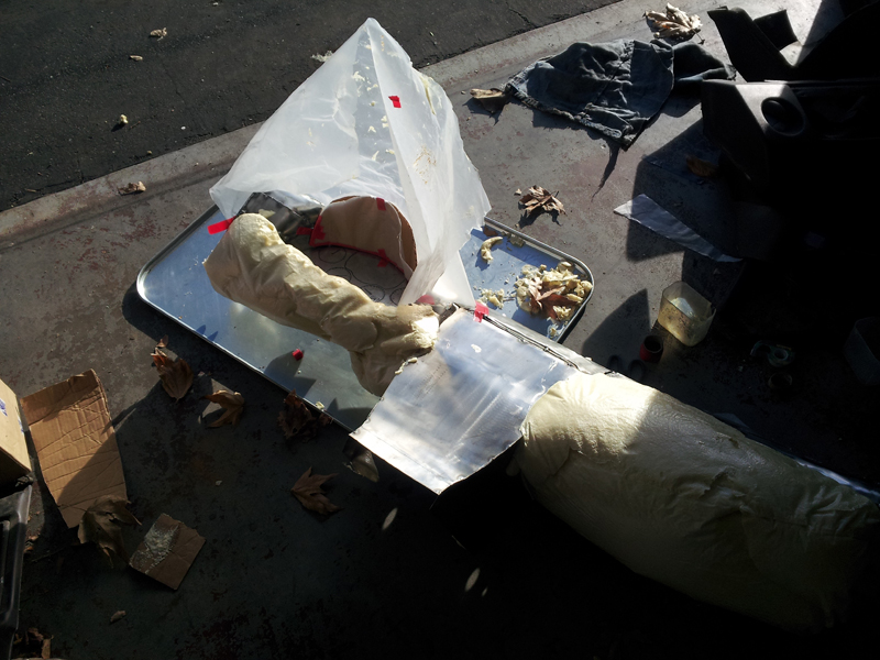

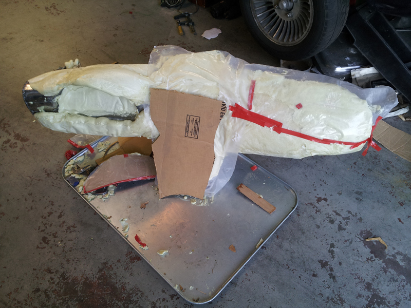

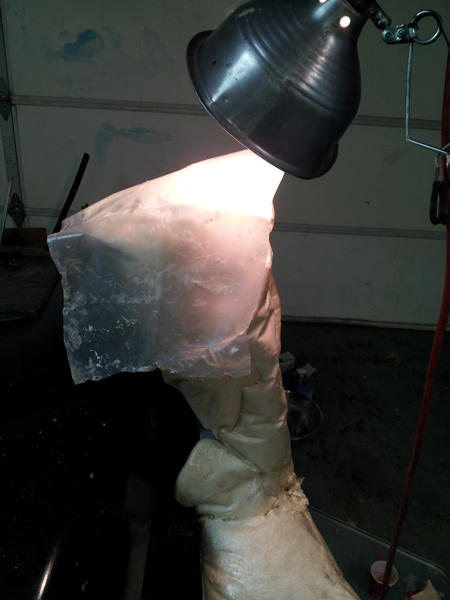

Plastic piece leftover after the pour. The cardboard is what I use to keep the foam from expanding really think, and instead expand vertically. The foam actually exerts quite a lot of pressure, and when pouring this stuff in pontoons, they have to cut relief holes to keep it from damaging the pontoons. :o

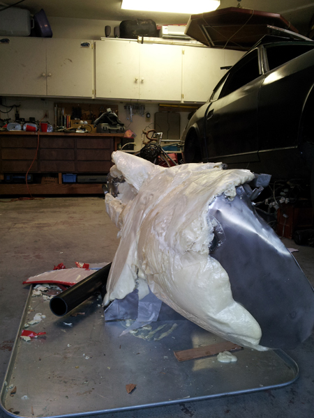

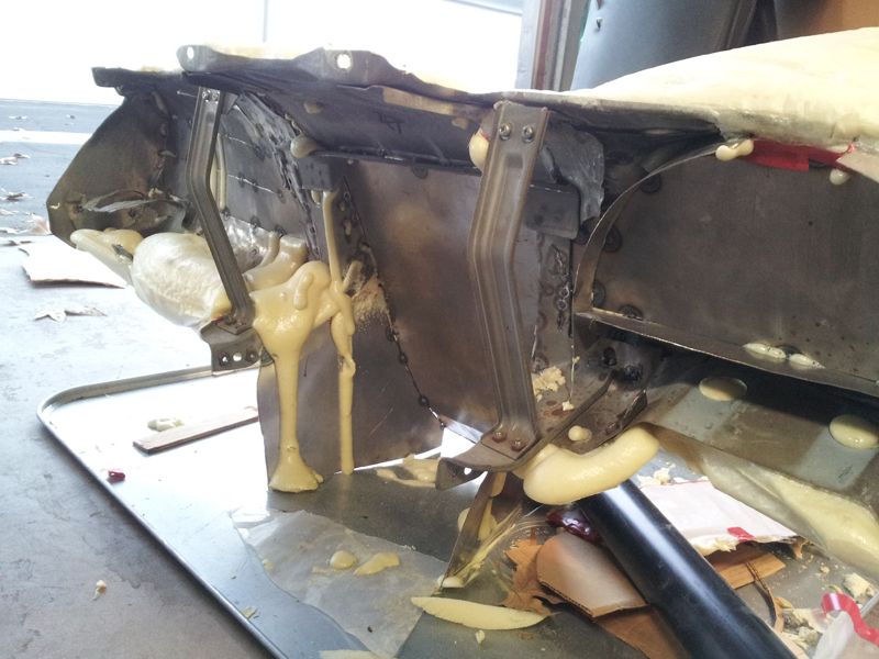

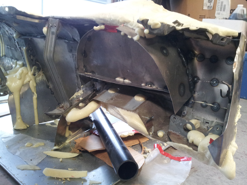

A little behind the scenes sneak peek at what the metal work looks like. So glad that is done! :)

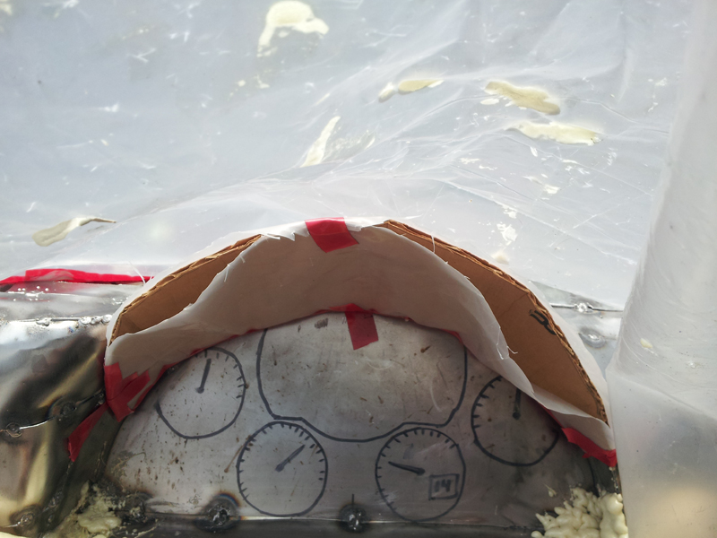

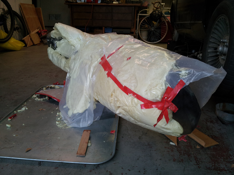

A heating technique to preheat the metal, then keep the foam warm for maximum expansion and curing speed. It's amazing the difference heat makes. I wasted so much of this stuff by not knowing how to pour it correctly the first few pours. By the time I got to this part, I was spot on pretty much every time.

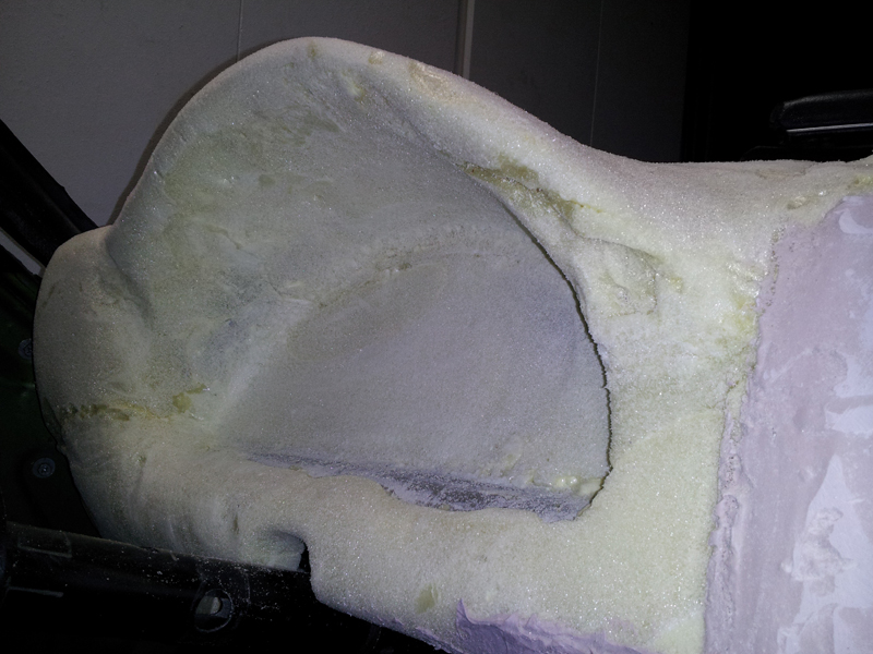

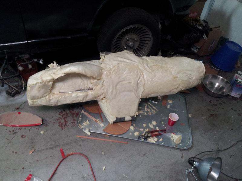

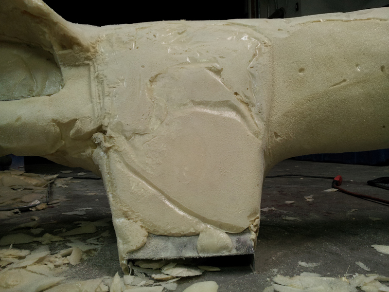

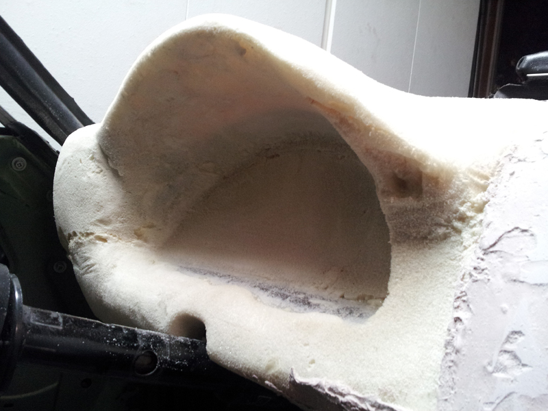

Left side of instrument cluster foamed in. End caps of the dash all foamed.

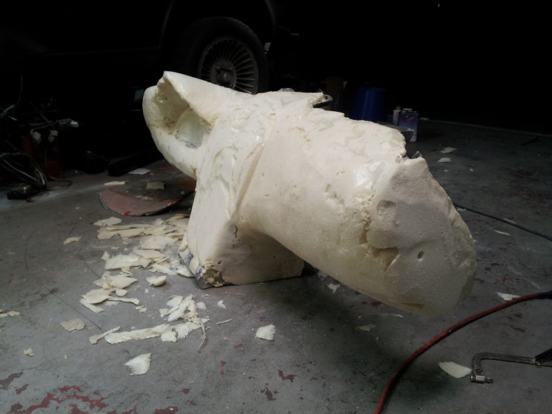

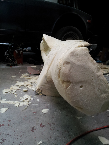

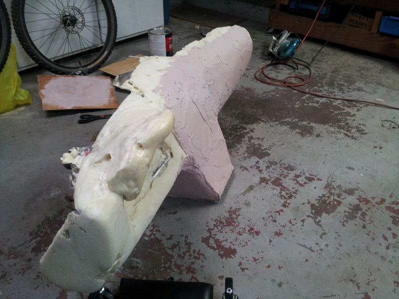

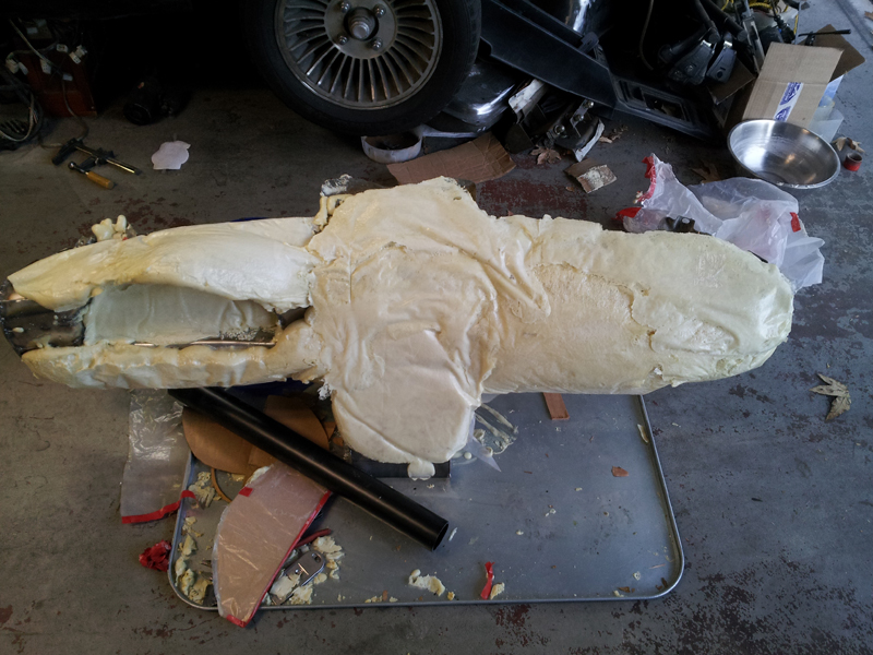

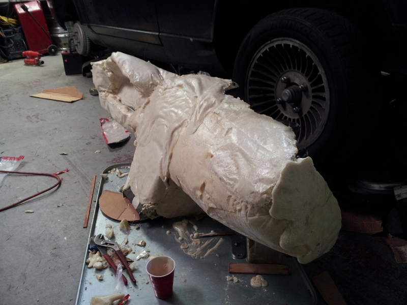

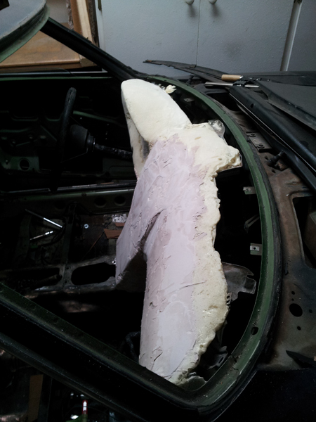

First pass sanding. Final shape on the passenger side pretty much all set. I'm very pleased with the way this turned out. Driver side still needs tons of work. I like the curves from the center dash to the bottom passenger side and will attempt to mirror (though at a higher level) on the driver side.
Side views
Closeup of the center. Needs some body filler. LOL

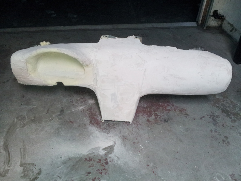

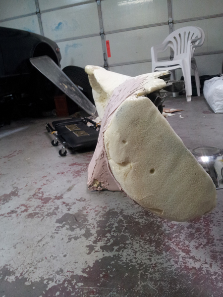

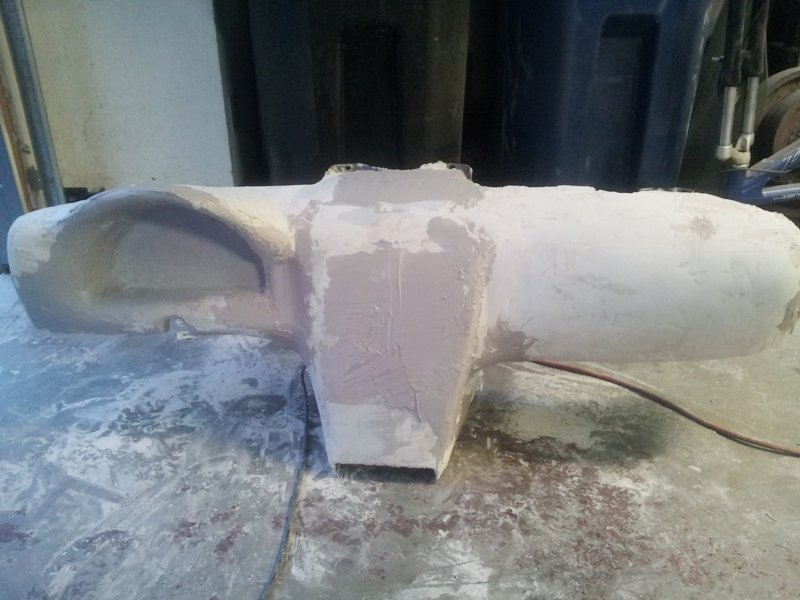

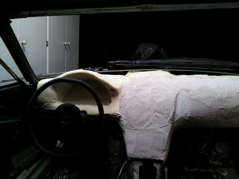

Here's the good stuff! :D Body filler going on last night and tonight (technically also last night since its now past midnight. . .) LOL.
Second pass sanding the end caps. Still a little tight in the car. Might go down another few mm on each side. More foam added to the top of the hood to shape it better.

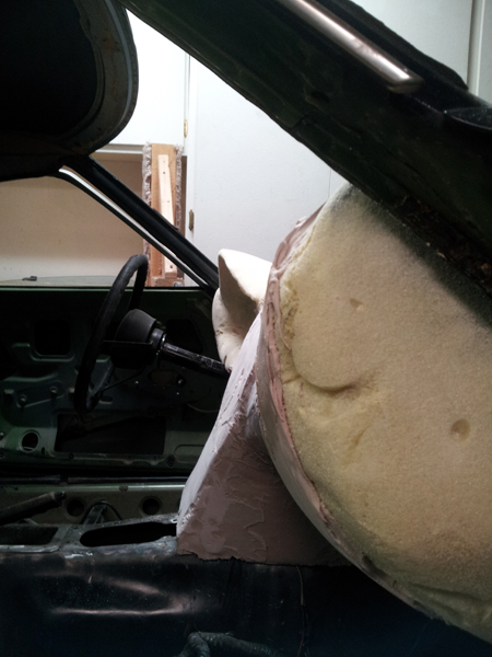

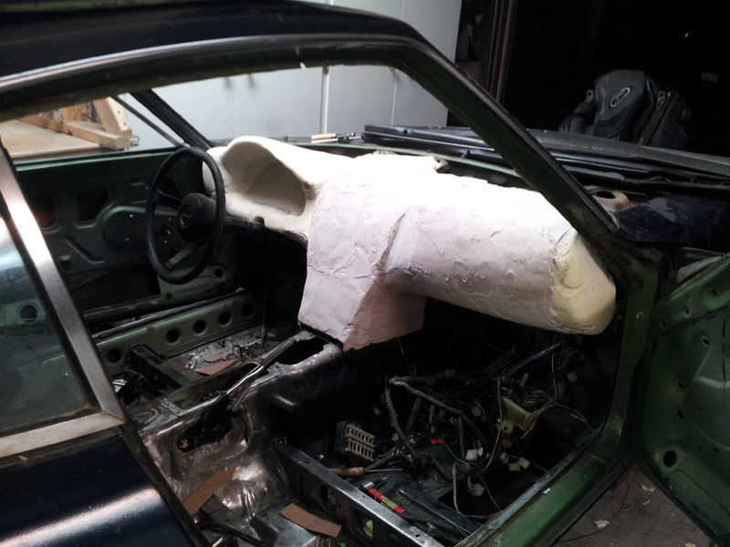

So sorry for the slow updates guys! Medical school is back in full swing, and we're working our butts off again. I didn't get to the dash last weekend, but I WILL be doing more to it tomorrow for SURE! May not be huge steps, but we'll see what I can crank out. I've been building a rotisserie for the datsun, so of course that takes time, too. The main problem we're having is the fact that the dash is technically below the window trim in the center. We wanted a v shaped look to it both from the top and front, which is what we did, but unfortunately now we have to built a small extension running across the dash. It will be a "bar" basically that covers the window seal and finishes off the look of the car. Not to fear, many cars have these, including the RX8 I'm modeling it after. I just didn't think it would be necessary. But...I was wrong. Here is a picture of what one of these bars might look like:
Now, on to the good stuff. :D I did get the dash gauge cluster formed and it FINALLY test fit in the car. :) Tell me what you guys think. More bondo to come!

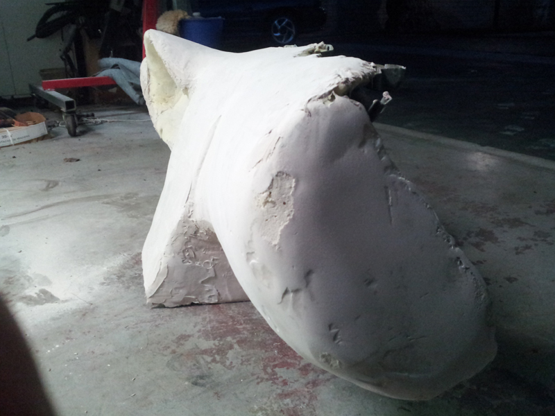

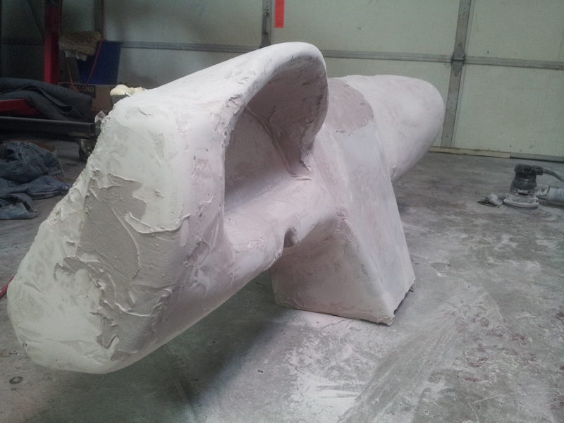

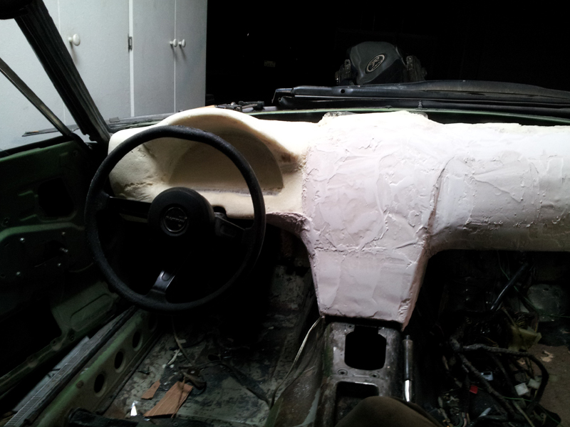

Sorry for the delay guys. School took top priority up until about two weeks ago, so I had to lay this project aside for a bit. Kinda the story of my life, LOL. Plan is to have the plug done this weekend and reverse mold within a few weeks. From there I need to make the gauge pod, then it's done. Here are a few more picture updates and a video update!

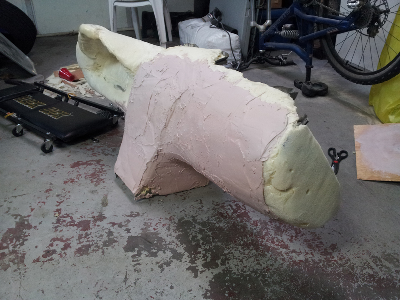

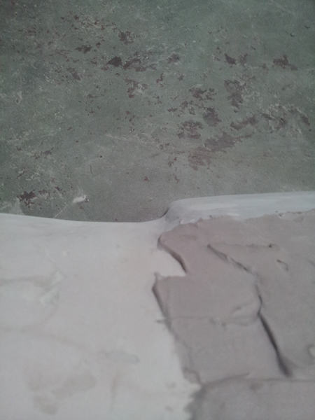

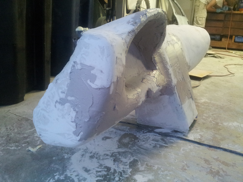

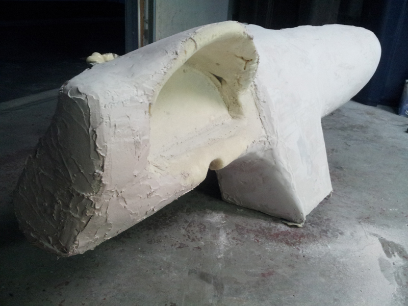

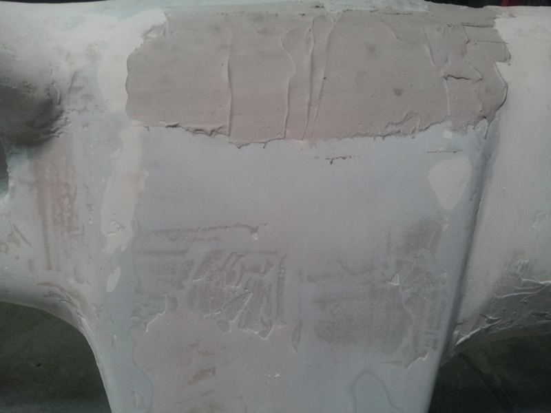

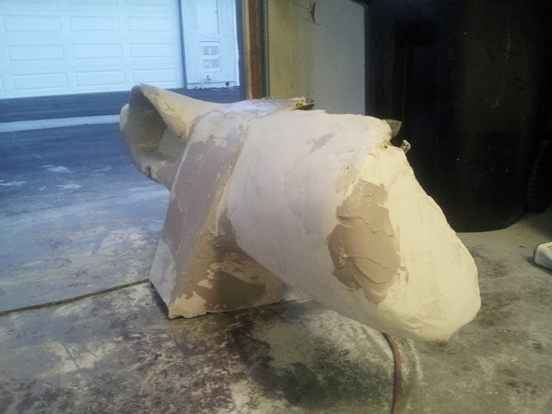

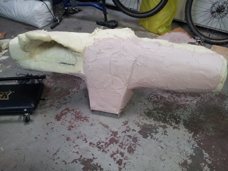

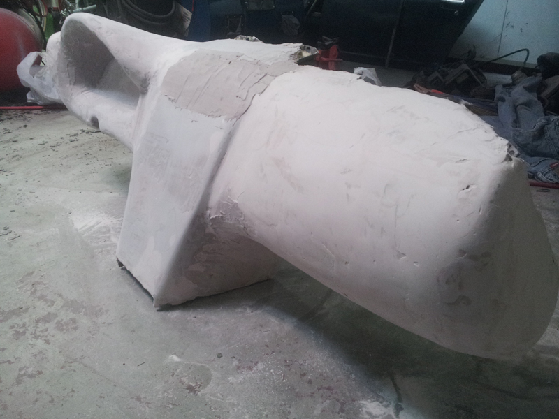

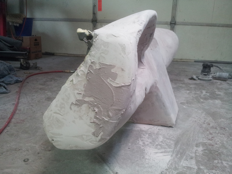

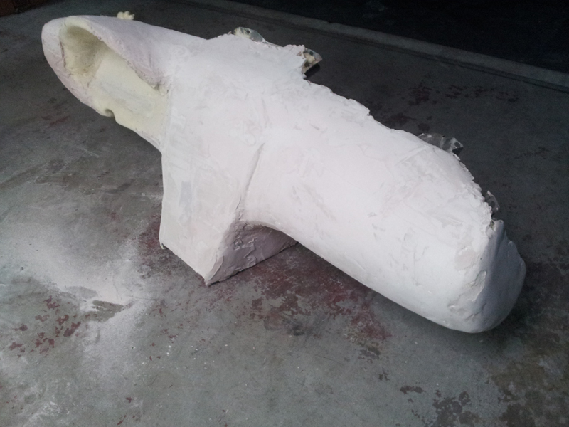

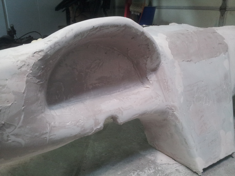

The main thing I did in the last 4-5 days was added more bondo and started sanding like crazy on it. It's starting to come together pretty good now, actually. Just filling on where I cut the foam too much (ugg) and sanding down where I had too much. Then sanding the bondo coats and getting it as perfect as possible.
Alright guys, I got the pics from last night pulled off and another video put up. The entire dash has bondo on it. The corners and the transition line to the passenger side dash are not complete. As I mentioned, I decided against the symmetry on either side of the center dash when it comes to the lines, in favor of asmmetry which I felt ties the center dash and gauge cluster together. Making a "V" out of the center dash sides would have been cool, but in the end I think this will also give more styling options.

Pretty good so far here. The gauge shroud is the bane of my existence, but Jon did a good job laying the bondo. One more layer and a good sand and it should be pretty close. *fingers crossed*
