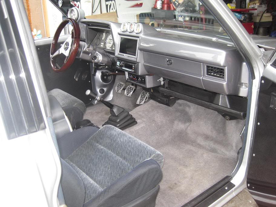

On that note, for any fiberglass buffs, I'm making a three gauge pod cluster just like the 370z above the center dash. Should I incorporate it into my plug and mold, or just make it once I pop a dash out of the mold?
Thanks!
You might ask this guy over on ratsun about the 3 gauge pod.
he added one to the top of his fiberglass datsun truck dash.
Custom 720 dash - 720 - Ratsun Forums
