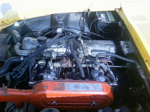

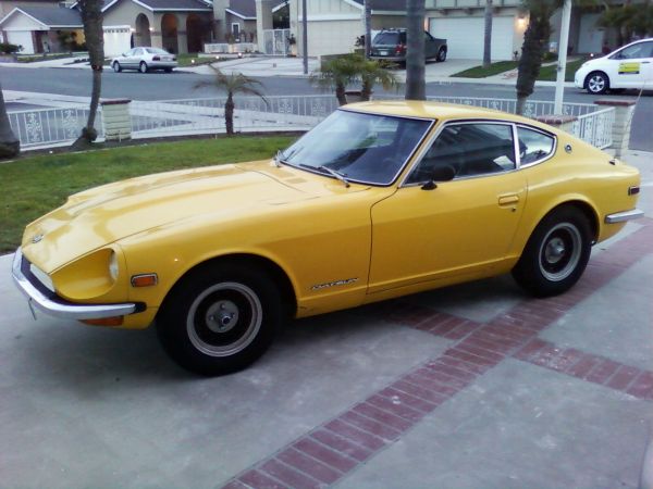

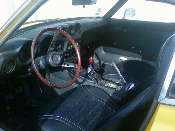

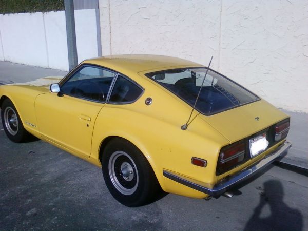

I have been searching through my local craigslist for quite some time looking for a Datsun 240z. I came across this good looking 73 Z. The seller is asking $4500. My question is: Is this a reasonable price? This is the sellers description of the car:
Pink slip in hand, 83k original miles, second owner
I bought new round top ztherapy carbs that need to be tuned, on the car one month ago $1k
New alternator, fuel pump, some console/shift knob accessories, other than that the car is all original
Got the car back from Mike's Zshop in Whittier a couple days ago, car runs great now. $200
The fuel system/regular maintenance are up to date.
No rust anywhere, car has always been covered and garaged.
Yes, air pump/ac still attached.
Is there anything in particular I should ask? There are four attached photos.

if the "no-rust" is true, that's worth big bucks right there-but in CA you might be used ti that. SU carbs are a nice upgrade from stock. Need to be tuned seems questionable, unless the owner doesn't know what he is doing. The carbs should have been bolt on and go for the most part.

All in all it does not look like a bad find. However the description and pics raise some flags. It does look like the car has a little rust on the driver side rocker panel. Go over the car with a flashlight and find tooth comb. If you can, take a body guy with you or someone that is familiar with Z cars to look it over good. Very few of these cars are truly rust free. Second, Z Therapy carbs are supposed to be near perfect out of the box. Hard to believe they still need to be tuned. Besides, if he had spent $1K on those carbs why would he not spend the 10-15mins getting them tuned, they should not need much unless there are some possible issues with the engine. Interior looks okay but where are the passenger side door components? The under hood area has been spray bombed black and pretty crappy at that. The next big question is do you like the color? If you have addressed these questions and satisfied with the answer then $4500 might be reasonable. However in my opinion it looks more like a $3K - $3500 car. I know others will chime in as well.
I'd say the car has been repainted - I don't think 920 Safari Gold was offered in '73, plus the black paint in the engine bay suggests a color change. Door handles painted? The interior looks pretty decent, a few cracks in the dash are to be expected, radio antenna cable hanging by the tunnel. All the hardware is missing from the right door - why? Anything else missing? Call Mike's Zshop and see what they did for $200 and do they have any comments on the car. I'd say this car needs a good pre-purchase inspection for paint quality, rust, suspension, brakes, equipment operation - all the usual suspects.

i seen that car too, offered trade for my 99 blazer but he didn't accept . I seen some posts on here or hybrid from that car with issues with the carbs, But doesn't seem too bad. Car looks decent from the pictures. THough I am not a fan of why the engine bay is black and not matching body color.

My first thoughts after looking at this car are, looks like a decent start but I agree with previous comments that paint looks suspect. I noticed the painted door handle and wondered also.
