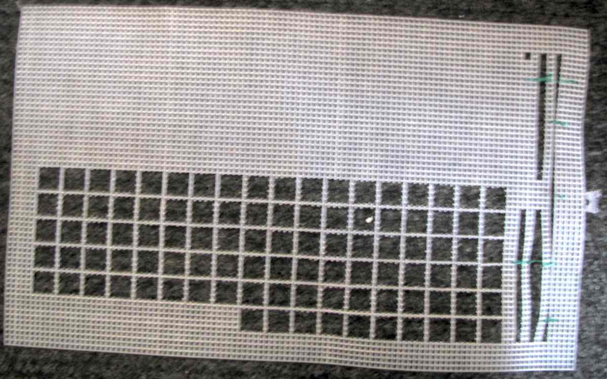

I don't know if this is worth mentioning but when I was making a drawing of the frame of my car I would sometimes take pictures with flash with a square pattern overlay to get accuracy with odd shapes. I used something called plastic canvas (see below) available here at a fabric store. It was tedious work breaking out the little squares but I could take a picture of an area of the car and then count the squares to a particular joint in the frame to get accuracy with the drawing. I imagine this could be used to verify placement of metal work in some situations:
