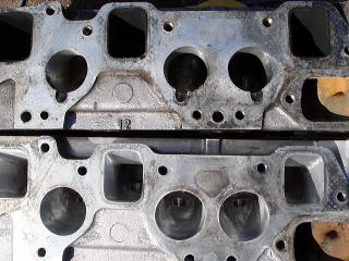

December 11, 201212 yr comment_409012 I've had a couple N42 heads that were cast without the injector reliefs and were drilled only for carb manifolds. Don't know what Nissan application there were used on but both came on N42 blocks. Link to comment https://www.classiczcars.com/forums/topic/45145-n-42-carburated-head/#findComment-409012 Share on other sites More sharing options...

December 14, 201212 yr Author comment_409222 I've had a couple N42 heads that were cast without the injector reliefs and were drilled only for carb manifolds. Don't know what Nissan application there were used on but both came on N42 blocks.I was back at the owners place today and this is the head it was, an N-42 w/out the injector reliefs.I still didn't buy it ha! Link to comment https://www.classiczcars.com/forums/topic/45145-n-42-carburated-head/#findComment-409222 Share on other sites More sharing options...
December 15, 201212 yr comment_409239 The N42 was used in Europe, SA and Australia/NZ with carbies on the 260Z until the 280ZX in 1979. They also used leaded fuel. It could be a import head. Link to comment https://www.classiczcars.com/forums/topic/45145-n-42-carburated-head/#findComment-409239 Share on other sites More sharing options...
