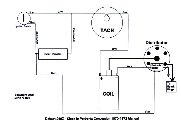

The Pertronix or an equivalent (if there is one) is likely the easiest and will work with the stock tach. The '79 distributor might be better but is not easier and it will not work with the stock tach.

Sorry, this is the file I meant to upload earlier...shows how to simply hook up the Pertronix and have the stock 240z tach work. I followed this approach & haven't had any issues. Please note that you'll want to ensure the rest of the distributor functions as designed without much slop in the shaft.
