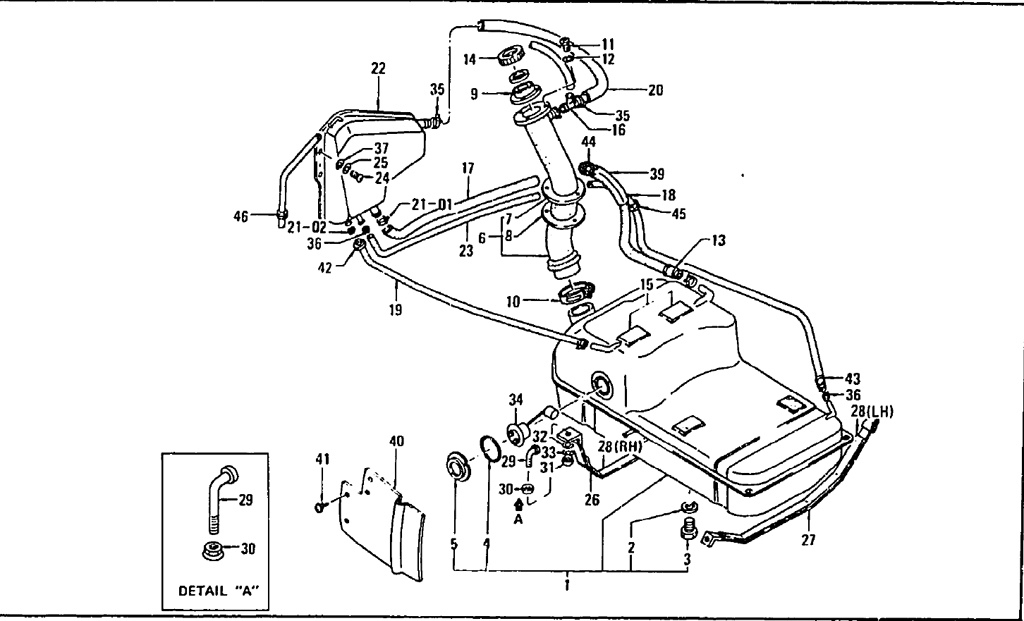

In Your Picture titled "5 Wires".
"A" - Connectors wrapped in Blue Tape on wiring harnesses - were not originally used in your car. However in some cases they can be used.
The Black & Green Wires can be jumped together - with a jumper wire that includes an inline fuse holder - to send power to the connectors by the Fuel Tank - to power an electric fuel pump. If you want to add one. The connectors at the fuel tank are also wrapped up in the wiring harness back there.
hope that helps..
