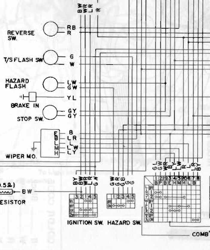

The combo switch connects the ground for the wiper motor. So, if you connect 12VDC+ to one of the positions on the switch and turn on the switch, you will always blow a fuse.
Now for the rest, I assume you have a pre-73 wiper motor and no amplifier.
Take a look at the 72 wiper circuit.
Note that the 12VDC+ goes from the fusebox to the wiper motor via the blue/red wire at the B terminal.
The L, M, and H terminals are connected to ground at the combo switch.
The L & M terminals connect to ground at position 1.
The M & H terminals connect to ground at position 2.
So if I don't miss my guess (using the 78 wiring diagram for the combo switch)...
The yellow/green on the combo switch should go to the M terminal.
The yellow/black on the combo switch should go to the L terminal.
The blue/yellow on the combo switch should go to the H terminal.

The relay is just for parking. You pass through low speed before going to off, hence the reason to use that wire to the relay.
Here is the issue as I see it. The Nissan and Honda wiper motors are wired to be grounded through the combo switch. The wires that are grounded dictate the speed. The wiper motor does not get its feed through the switch. So you would have to bench test and re-engineer the wiring to get it to work with the positive going through the switch.
OR you could make sure you are getting the signal wires from the wiper motor back to the combo switch (as I described above), just as it was designed to do. You would have to provide a 12VDC+ fused source to the wiper motor.

Are you planning on using the stock amplifier for the windshield wipers? If not, you can't. If you know how to read wiring diagrams, it's all laid out in the FSM how to make it work. If you haven't already, download the manual from XenonS30 (URL below). In the 1977 FSM, it starts on page BE-60, and that is page 556 of the PDF file. I think there is also a color version of the 1977 wiring diagram at Blue's site, and there may be a color wiring diagram floating around on this site somewhere. I'm not saying it's easy to read the windshield wiper circuits, though. The thing is that the "Painless" kit is probably designed to work for American cars from the 60s. Since intermittent wipers were not in production cars at that time, the painless kit isn't really designed to work with something so "exotic". You might be able to brute force the Honda wiper motor because it doesn't have an intermittent function.
