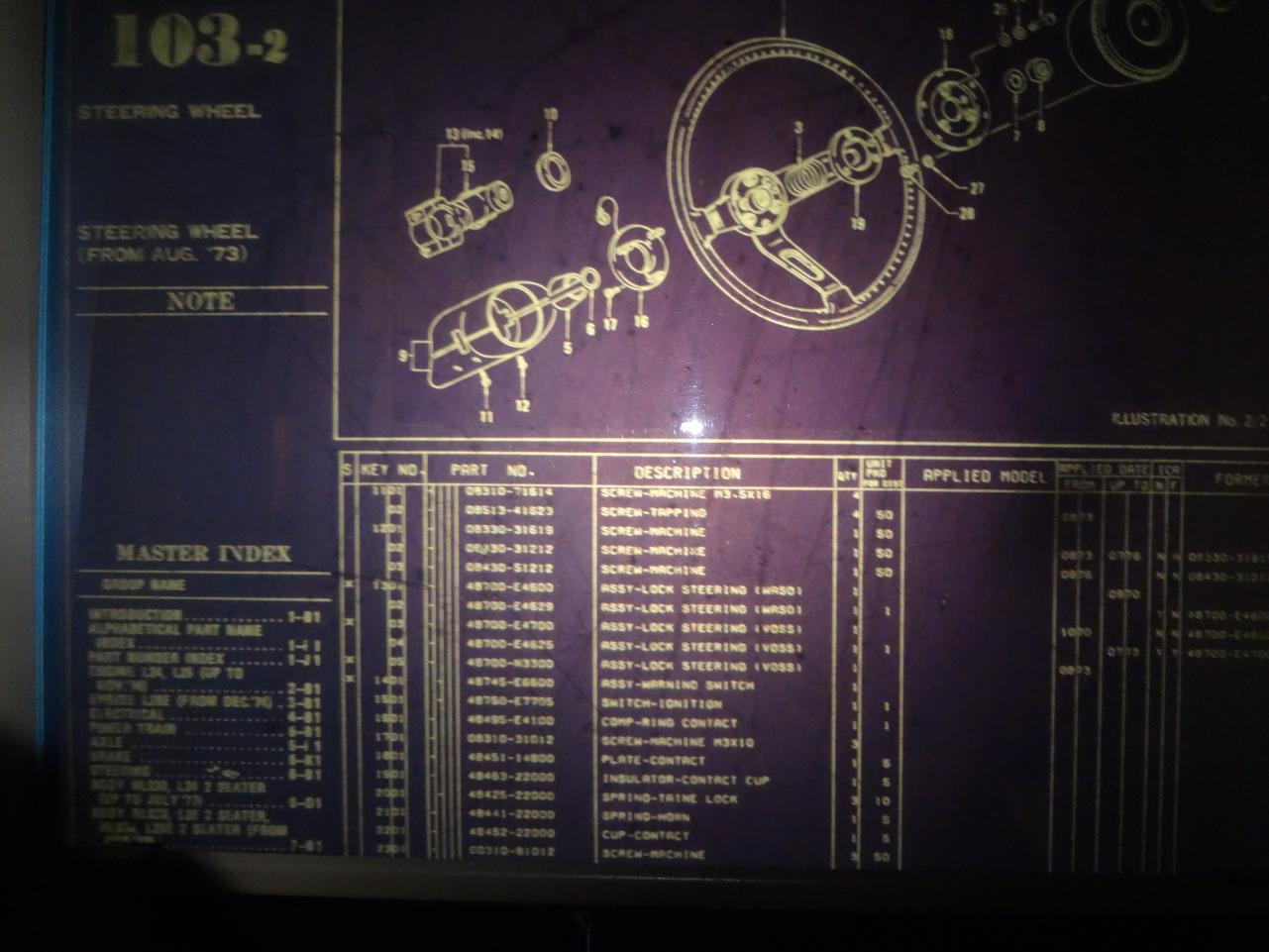

The clamshell screws shown in the US/Canada Parts Catalog 1970-1973 as well as the microfiche show a machine screw used up to July '73 (M3.5 X 16).
Aug '73 is when the revision is found, changing to a self tapping screw. Not that critical, so just use what you have that is a good fit and does the job or if you want the part number, it can be found below in the 'fiche if you want to check for availability.
EDIT: Kind of a crappy pic, the part number is 08513-41623
