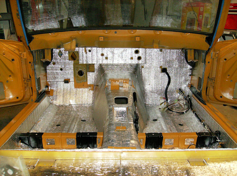

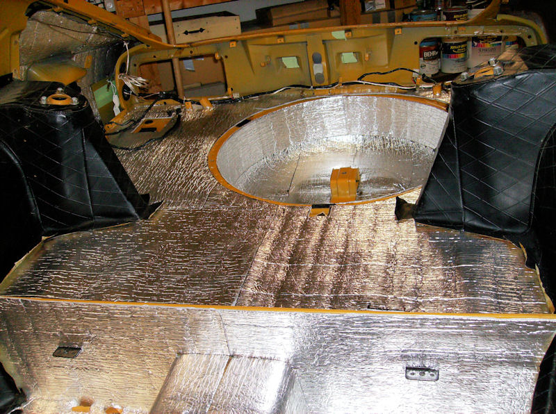

I used a product called Prodex from Insulation4less ( http://www.insulation4less.com/ ). It is a closed-cell polyethylene foam core with reflective aluminum foil coverings. it has a R16 rating and noise reduction of 19dB. Unlike bubble insulation, this stuff does not collapse under pressure or aging. Installation was pretty easy with 3M spray adhesive. I used about 60% of a 100' roll of 72" wide product.
