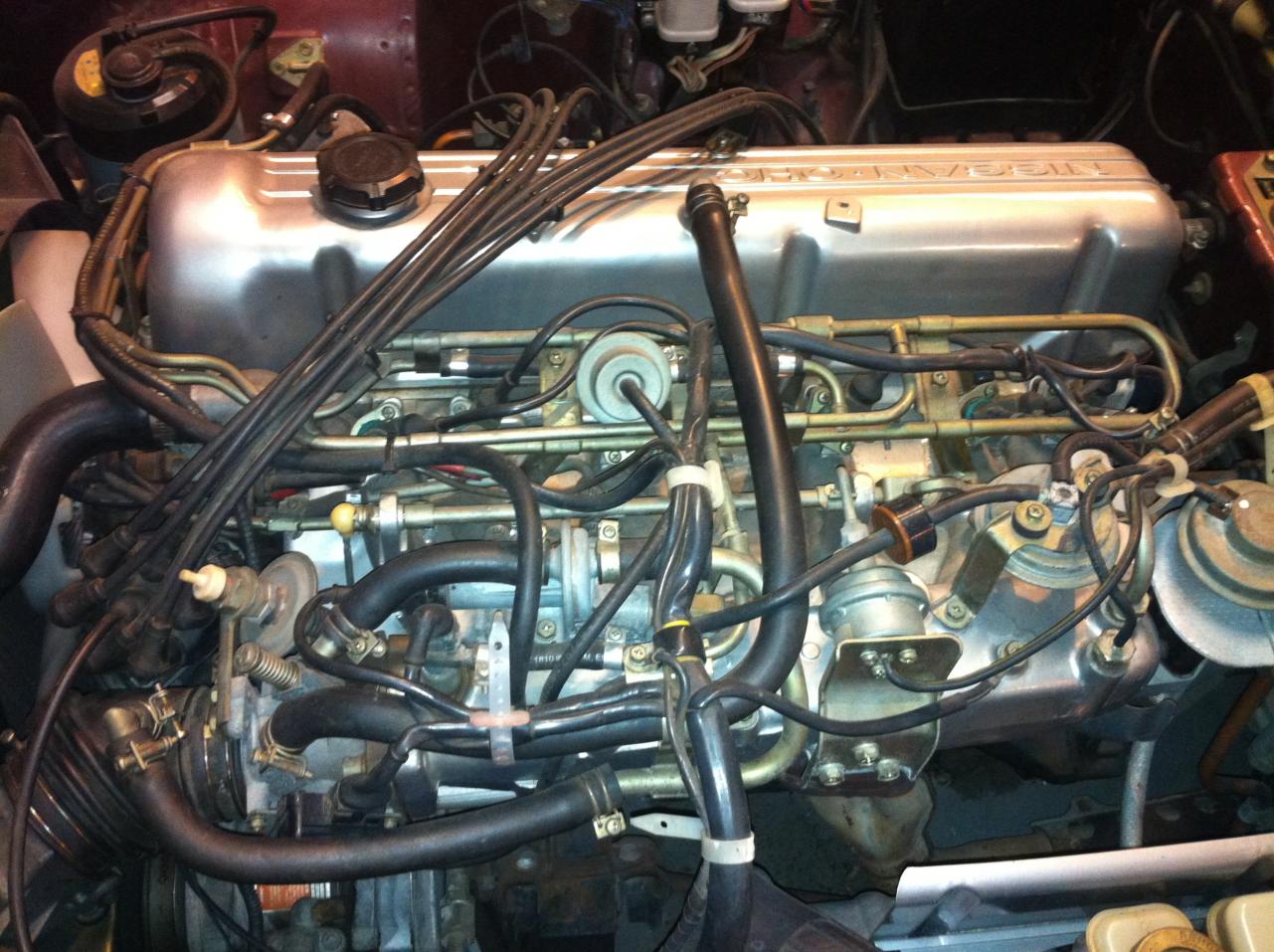

January 4, 201312 yr comment_410868 Grretc, nice find. I'm partial to '73's. I would start with removing all brake cylinders and calipers. Your rear drums are probably seized-you'll need to shoot some lubrancant in there wherever you can and start tapping the drums off from the interior side. Use a wood block for this so that you don't break the drums. I know you want to keep it original, but I would consider removing all smog equipment/egr, clean up the balance tube, and plan on swapping out those carbs for roundtops. The more variables you can remove from the system, the easier the car will be to get running and properly tuned. Make sure all your suspension parts articulate properly and inspect/replace bushings as needed.Good luck on your project. Link to comment https://www.classiczcars.com/forums/topic/45319-1973-240z-refreshening-thread/#findComment-410868 Share on other sites More sharing options...

January 5, 201312 yr Author comment_410941 Hey guys, thanks for the kind words. I think I'm going to take tlorber's advice and remove the smog equipment, but not off this motor. I have a spare l28 with an n42 head that came off a running Z I'll throw in this one. So that one will run on round top carbs while this motor remains untouched. If I ever wanted to go back to completely original, it will be there waiting for me. Hardway, I looked up what you were talking about and came to this link: http://www.jrdemers.com/280ZX/tankvents/tankvents.html If that's what you're talking about, I'll probably take care of it once I know the car and move and stop under it's own power. jonathanrussell is right. I don't want to dig myself too deep with this kind of thing. I know people who regret digging too deep into their z and have made it a 10 year project. My goal is to enjoy driving it, not enjoy working on it. His advice basically said get it up and going, which is what I plan to do. Then I'll tackle the suspension and cosmetics. One thing that is for sure..when it's time to paint, it will be 113 green Link to comment https://www.classiczcars.com/forums/topic/45319-1973-240z-refreshening-thread/#findComment-410941 Share on other sites More sharing options...
