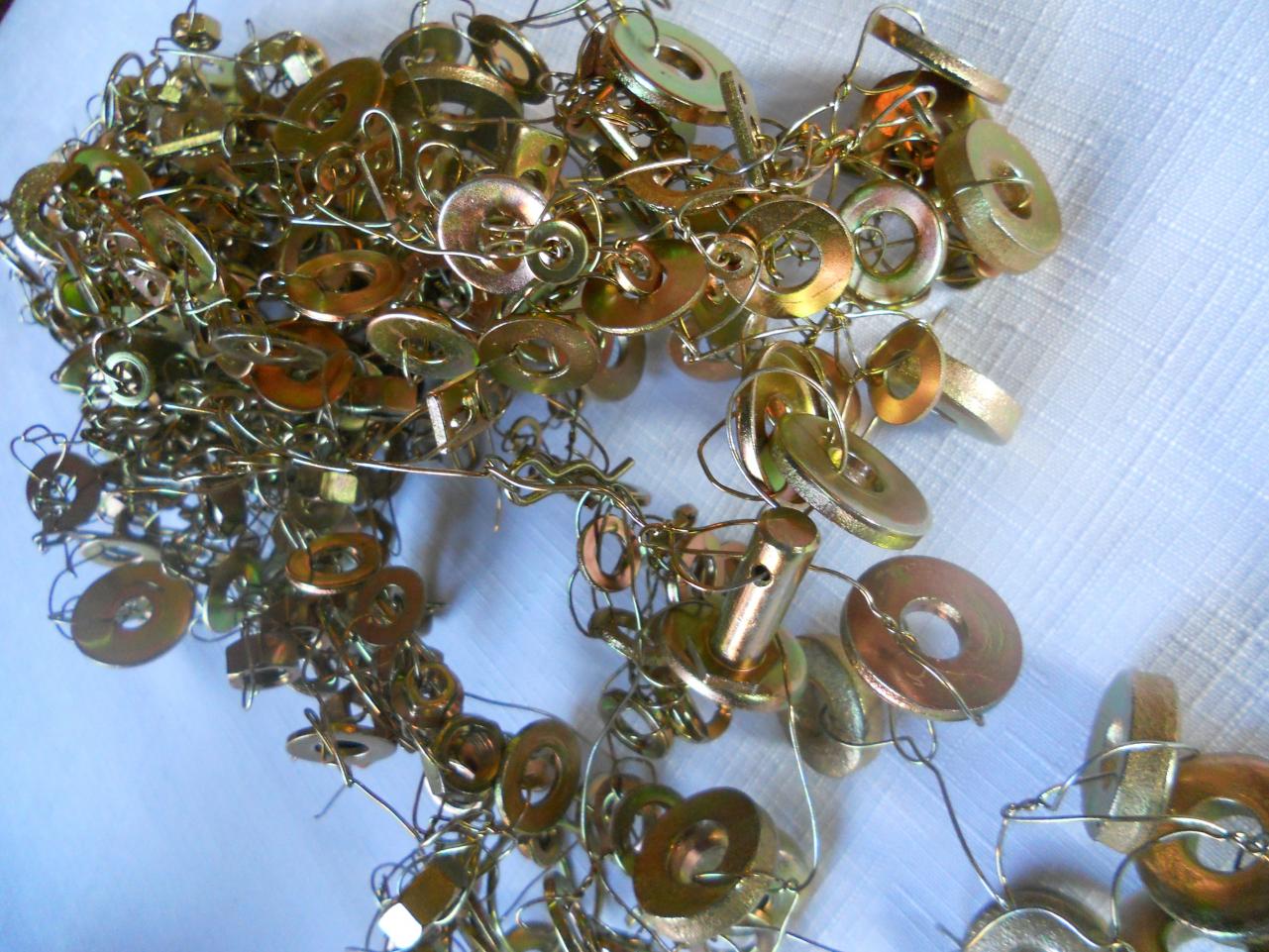

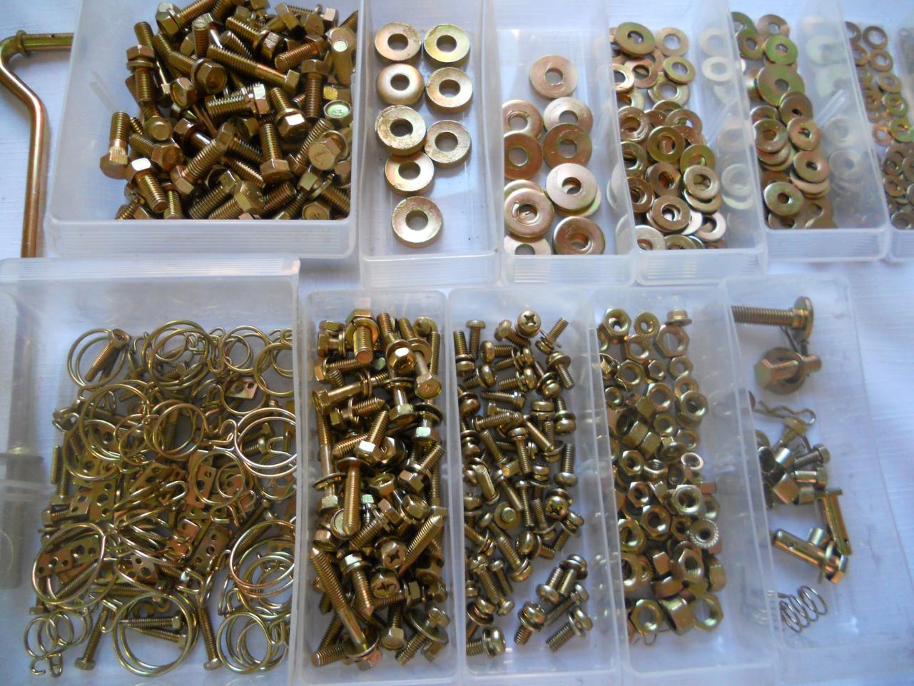

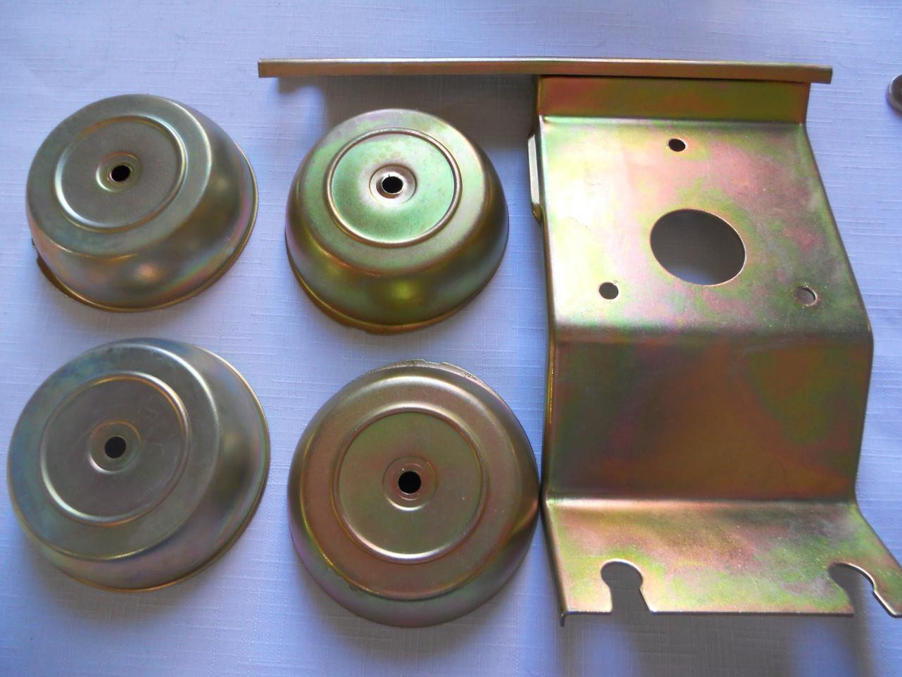

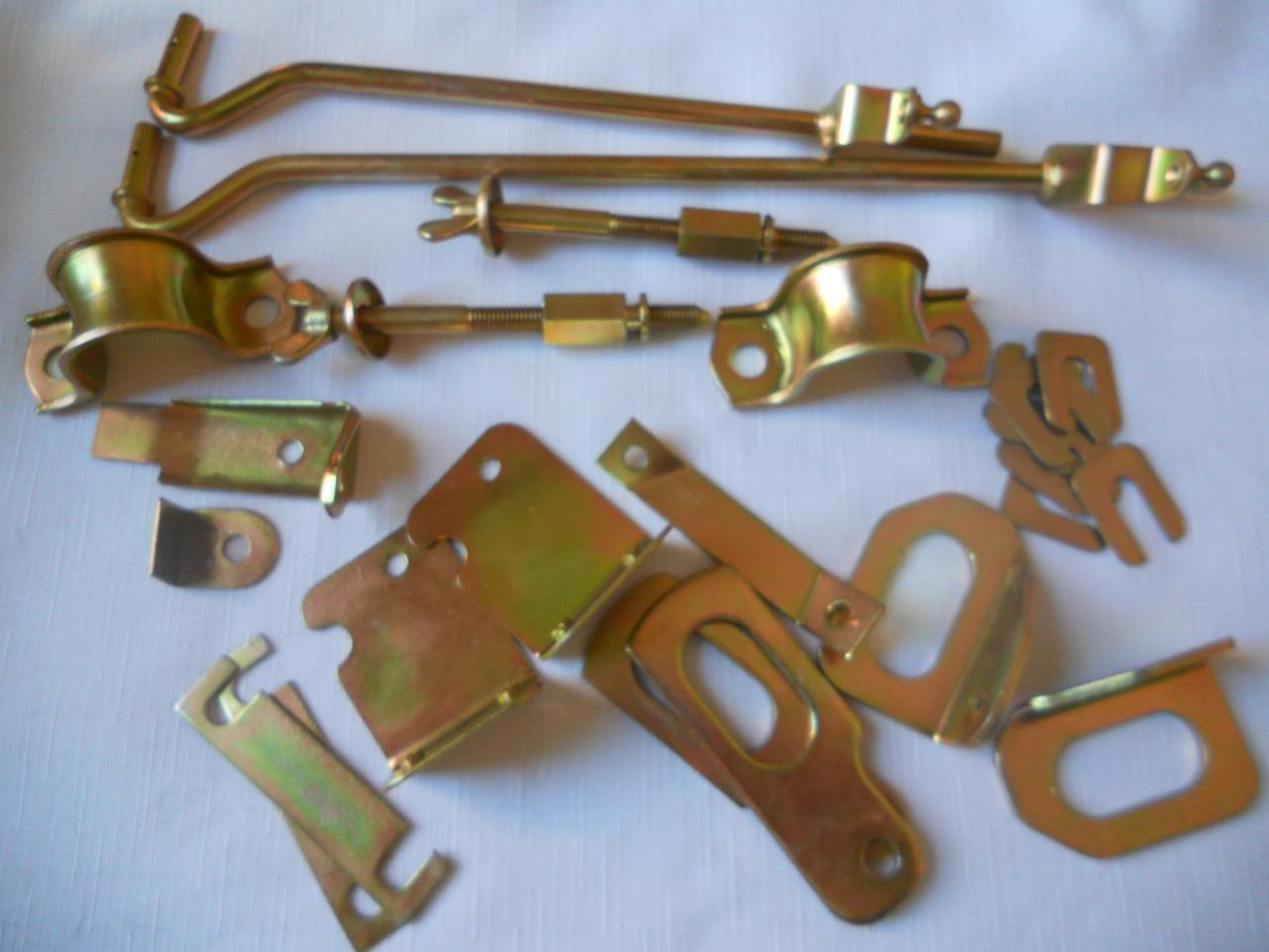

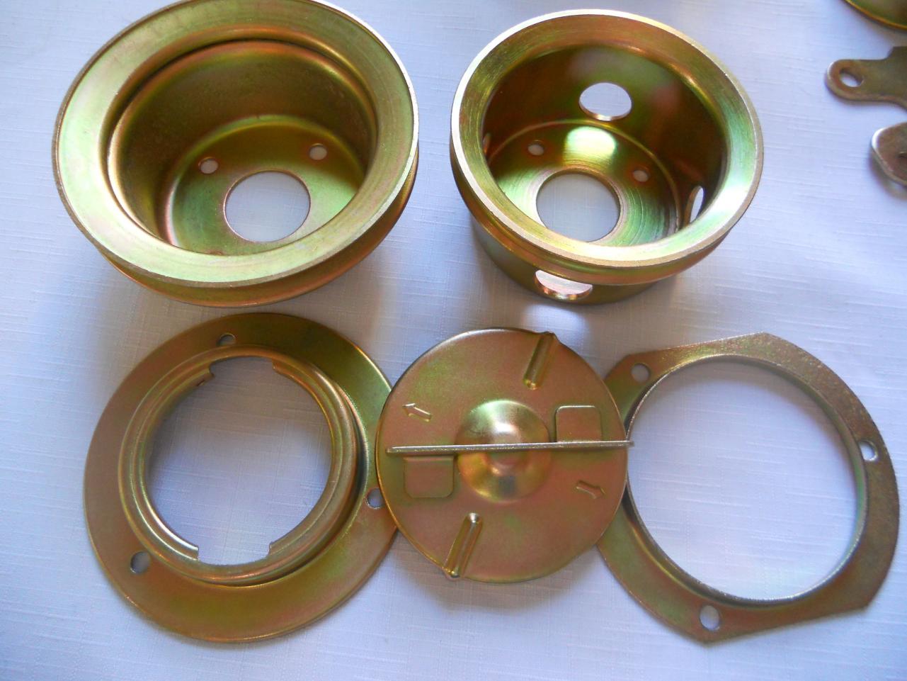

January 7, 201312 yr comment_411137 Picked up my parts today from the plater, I did not get my clear or black zinc parts ready in time to drop them off so I will have to make another trip to Muncie in the near future. I am very happy with the work. I took some pictures of the small parts which I daisy chained together prior to taking them loose. They came back in a tangled ball but the process worked out well. I had been told that the outcome of the process would be equal to the prep-work. This process was labor intense but well worth the outcome. Link to comment https://www.classiczcars.com/forums/topic/45325-nuts-and-bolts-what-to-do/?&page=2#findComment-411137 Share on other sites More sharing options...
January 7, 201312 yr comment_411140 Wow, those look fantastic, Jerry! Link to comment https://www.classiczcars.com/forums/topic/45325-nuts-and-bolts-what-to-do/?&page=2#findComment-411140 Share on other sites More sharing options...

January 9, 201312 yr comment_411315 Picked up my parts today from the plater So about the plating... What process was used for the original factory plating? I know pretty much nothing about the subject, but I've usually heard it referred to as "cad plating", and (because that's what I always heard), I propagated that term. Is it cadmium or zinc? Are those parts you just got back done with the same plating material and process as OEM? PS - Those parts are beautiful, regardless of the details! Link to comment https://www.classiczcars.com/forums/topic/45325-nuts-and-bolts-what-to-do/?&page=2#findComment-411315 Share on other sites More sharing options...
