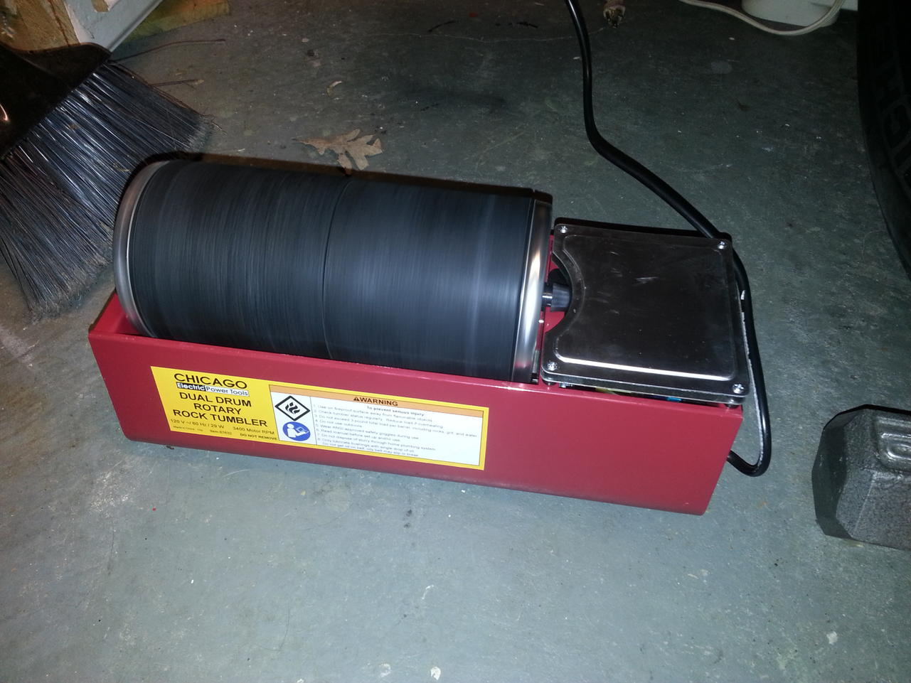

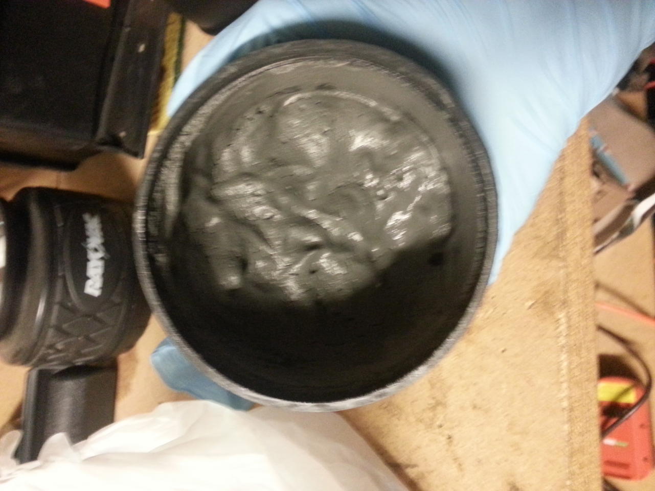

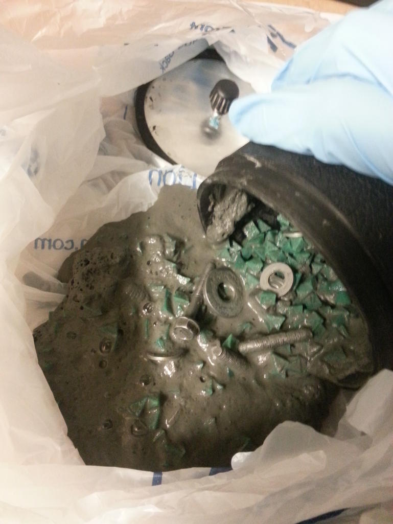

February 4, 201312 yr comment_413952 I too have investigated the plating process. So far I have been using a large wire brush mounted to a bench grinding machine. Laborious holding a bolt for a while at all angles; but it does make them shiny! The cheapest fake self plating kit I saw was about $54 for a three stage zinc/cadmium kit from Eastwood with less than stellar reviews on Amazon. It's looking like many of my nuts and bolts will either be clear coated or painted Datsun engine blue to contrast the polished aluminum parts. I recently purchased the double barrel rock tumbler from Harbor Freight Tools. Looking back, I could have gone with the single barrel. I bought some rust removal product from the same store, as well as a 40/70 glass mixture. I filled the barrel about 2/3 of the way with the rust removal product (small glass feeling pyramids with a funky smell), put water up to that level, then threw my bolts, nuts, and washers in. I wrote down which ones they were. They were pretty greasy, and the ones that weren't greasy had some rust in the threads and on their heads. After 24 hours of it running in my garage, I checked out the bolts and they looked pretty clean and most of the rust-removal product had turned to a dirty sludge. I decided to stop the machine and rinse all the parts off and to restart them in the 40/70 grit mixture. It says it won't harm soft materials, and I'm hoping it'll polish them a little bit. I'll check on them in another 12 hours or so. Overall I'm happy with the results so far and it lets me do other stuff while the machine is running. It's not too loud. Link to comment https://www.classiczcars.com/forums/topic/45325-nuts-and-bolts-what-to-do/?&page=4#findComment-413952 Share on other sites More sharing options...

February 5, 201312 yr comment_414057 [ATTACH=CONFIG]60756[/ATTACH]After 24 hours of it running in my garage, I checked out the bolts and they looked pretty clean and most of the rust-removal product had turned to a dirty Overall I'm happy with the results so far and it lets me do other stuff while the machine is running. It's not too loud.What will you do with them once they are clean?? Once you have removed all of the zinc with the tumbling process you will be down to the bare steel. Anything not protected after this will rust unfortunately. Link to comment https://www.classiczcars.com/forums/topic/45325-nuts-and-bolts-what-to-do/?&page=4#findComment-414057 Share on other sites More sharing options...
