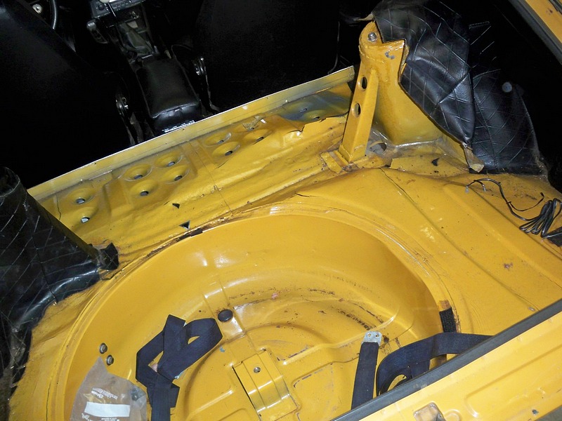

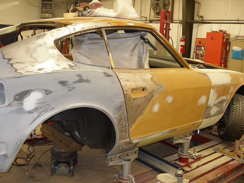

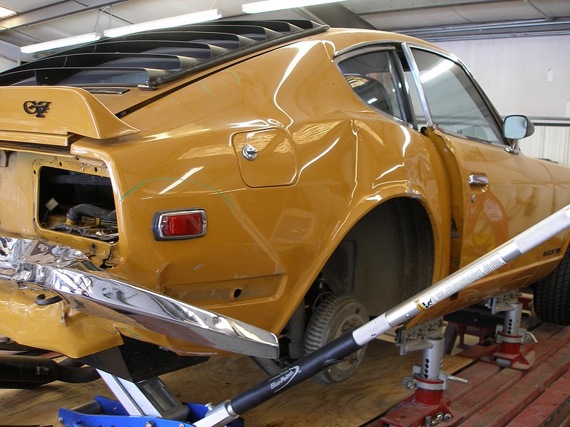

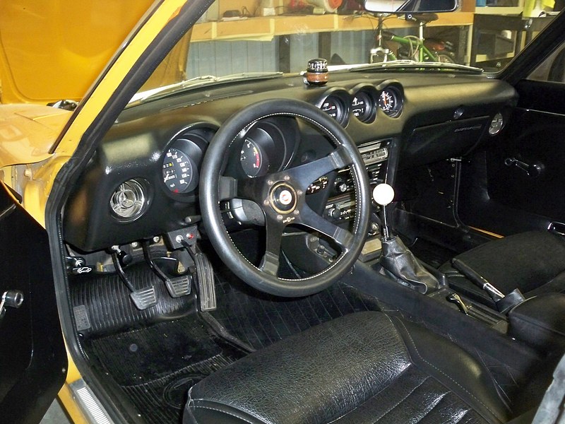

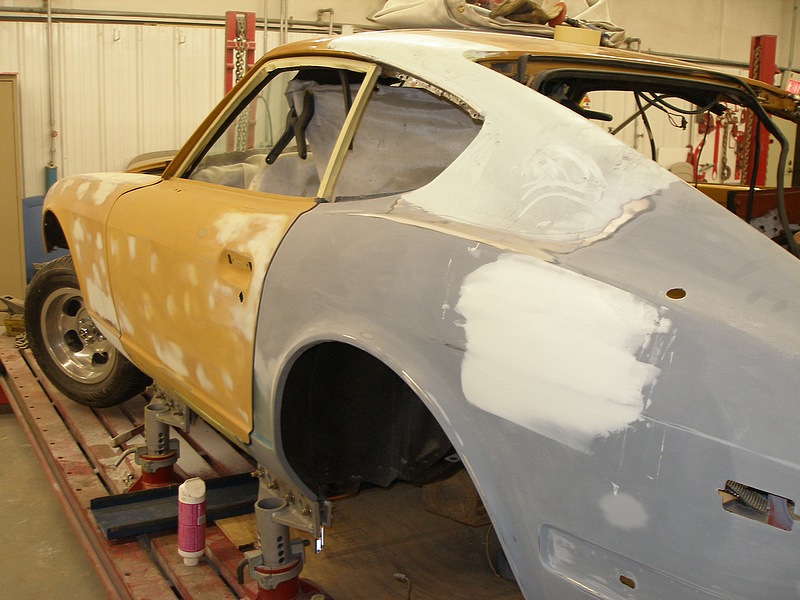

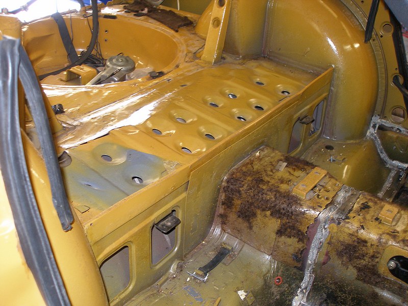

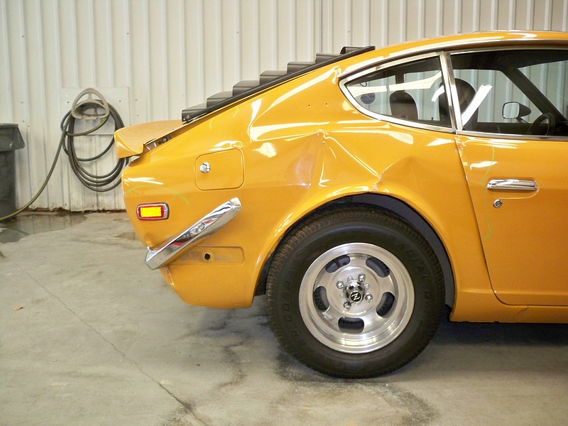

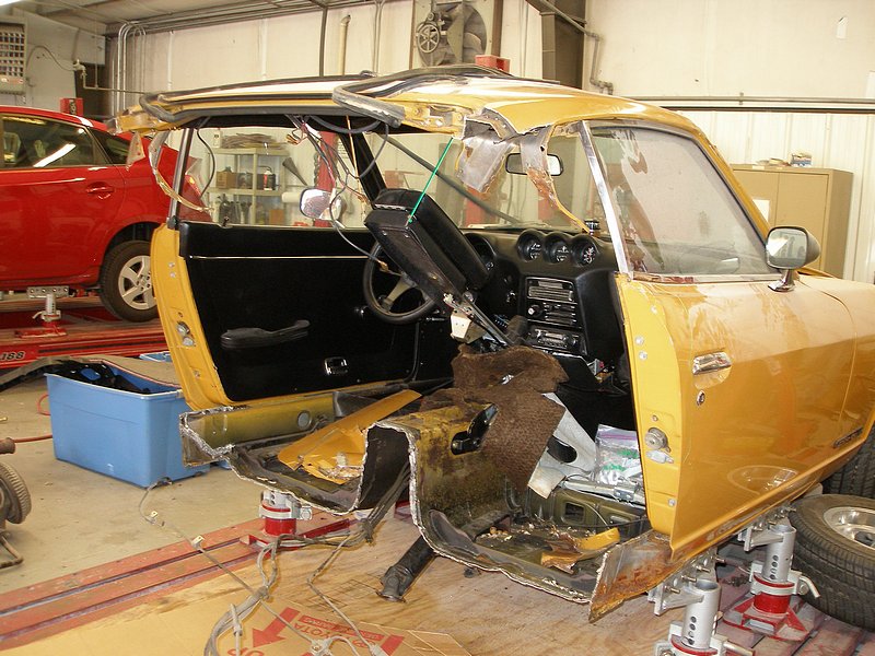

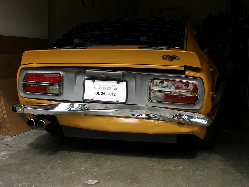

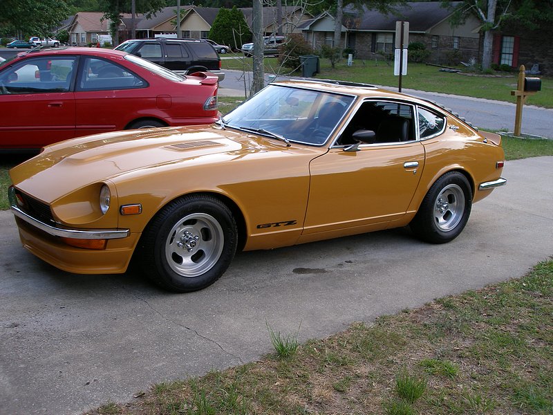

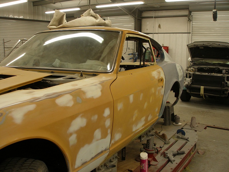

The body shop has had my car for 7 months today and still another month they say. The only thing that saved this car from the scrap pile was having an appraisal to show the value. The long story short was we were sitting at a red light for almost 45 seconds or better and we heard screaching tires and bam, he told the cop I only looked down for a second...I bet he was texting:finger:. The hardest part was trying to find a useable donor without any rust for parts and after a 3 month search a suitable donor was located thanks to our very own hls30.com, much appreciated :). The pictures show the before and how it is today, another week and should be ready for some paint LOL.

Most body shops out there would have pulled that out and just put a new quarter panel on. I'm surprised they went to this extreme. They
must have a frame guy thats really good at putting on clips.
I thought the same thing about just replacing the quarter panel but the floor pan and frame rail was bent to bad . They tried to pull it out but didn't have any luck. The body is square according to what the frame machine laser align computer read out shows. so hopefully it will be okay. This car was always garage kept since the day it was new and still had the original paint and interior with no rips or tears, the dash is still perfect with no cracks...only 112K original miles. The car appraised at 24K and the estimate to repair is at 11K so it is cheaper for the insurance co. to fix.
In the pictures you can see how the floor pan is wrinkled.
