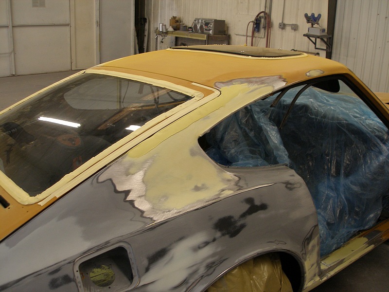

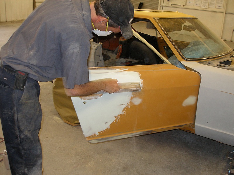

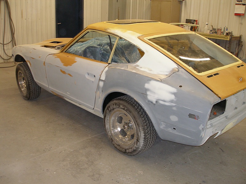

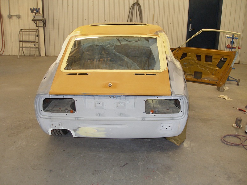

The body shop finished putting the rear suspension back together and it is rolling again LOL Now the body man is finishing up the bondo work and should be primed by friday...so glad to see the car back in one piece and the end is in sight.

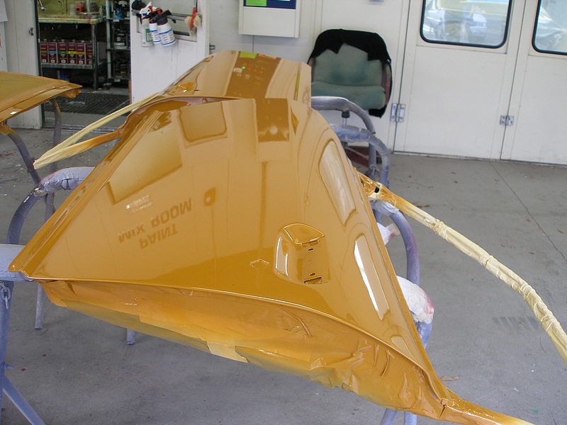

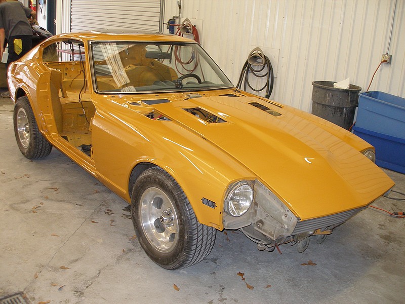

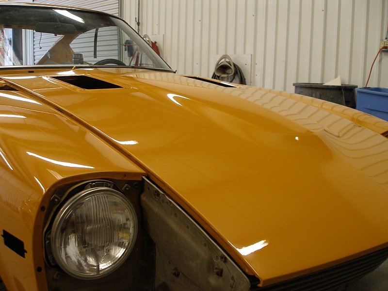

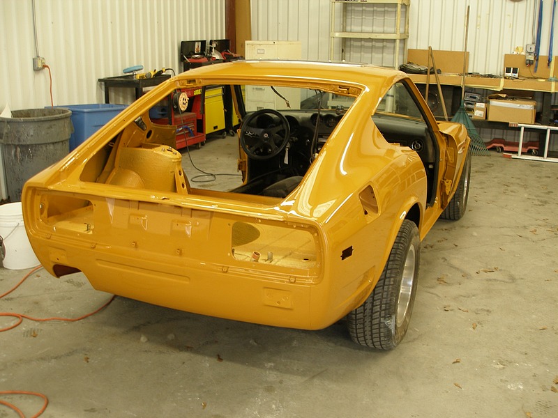

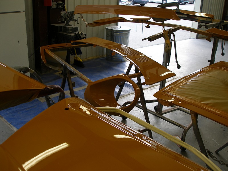

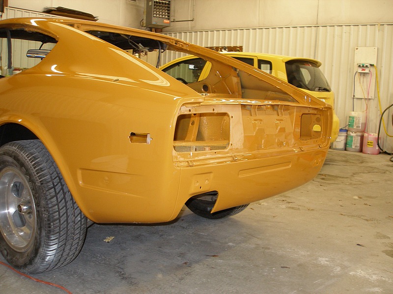

Big surprise today when I went to look at the car, it's been painted:D. They did lift the rubber around the windshield and back glass so paint could get under the seals. They tell me that they should about have it back together by friday...can't wait to see it in one piece again...7 months has been along time.

I'm very impressed with this. It appears very straight in the photos.
