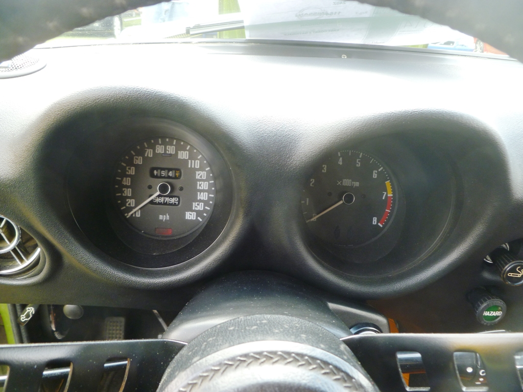

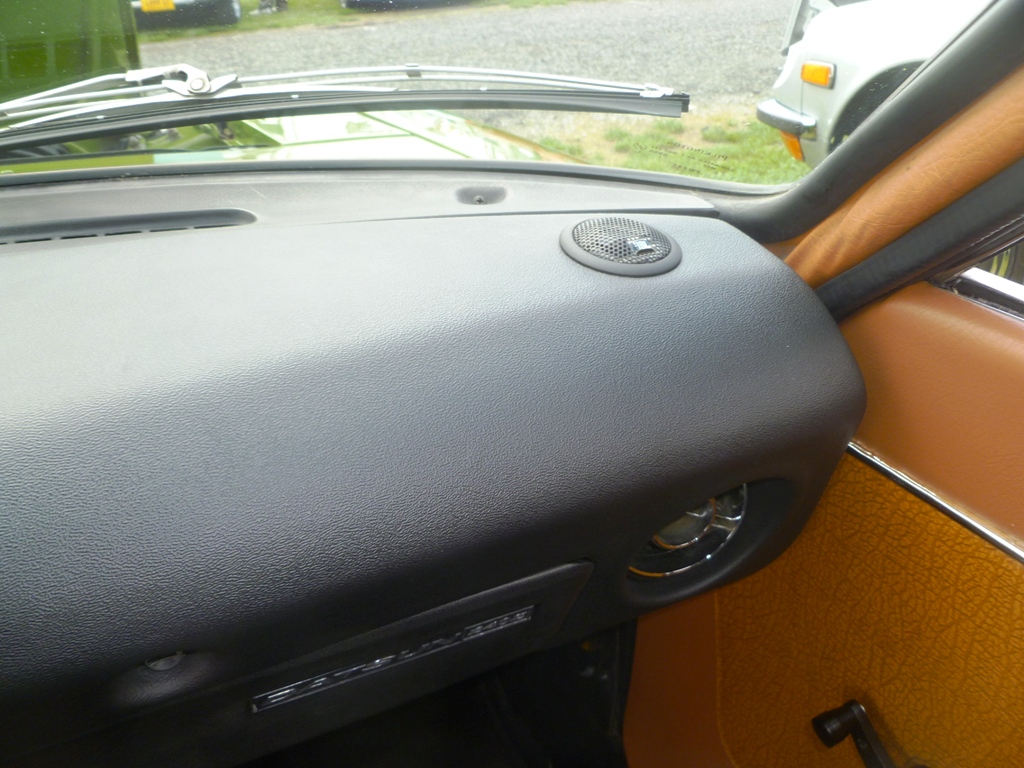

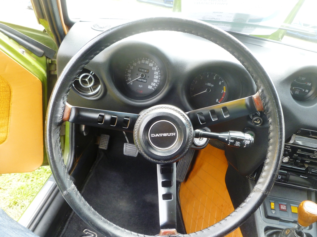

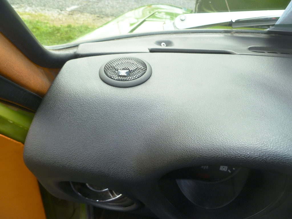

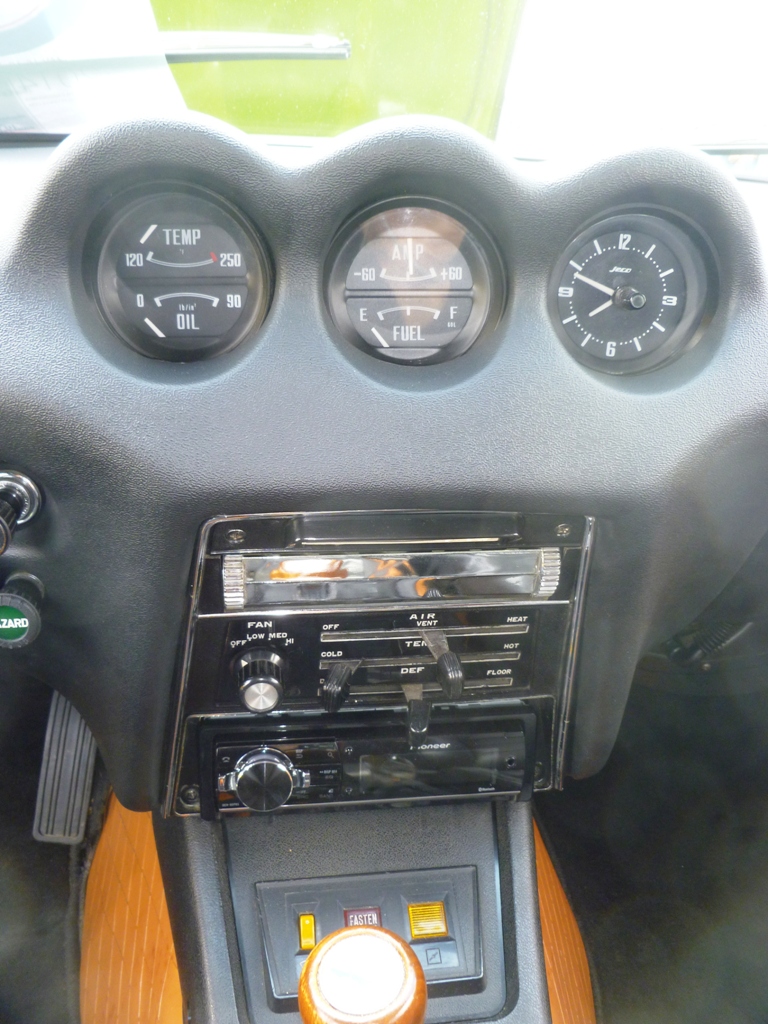

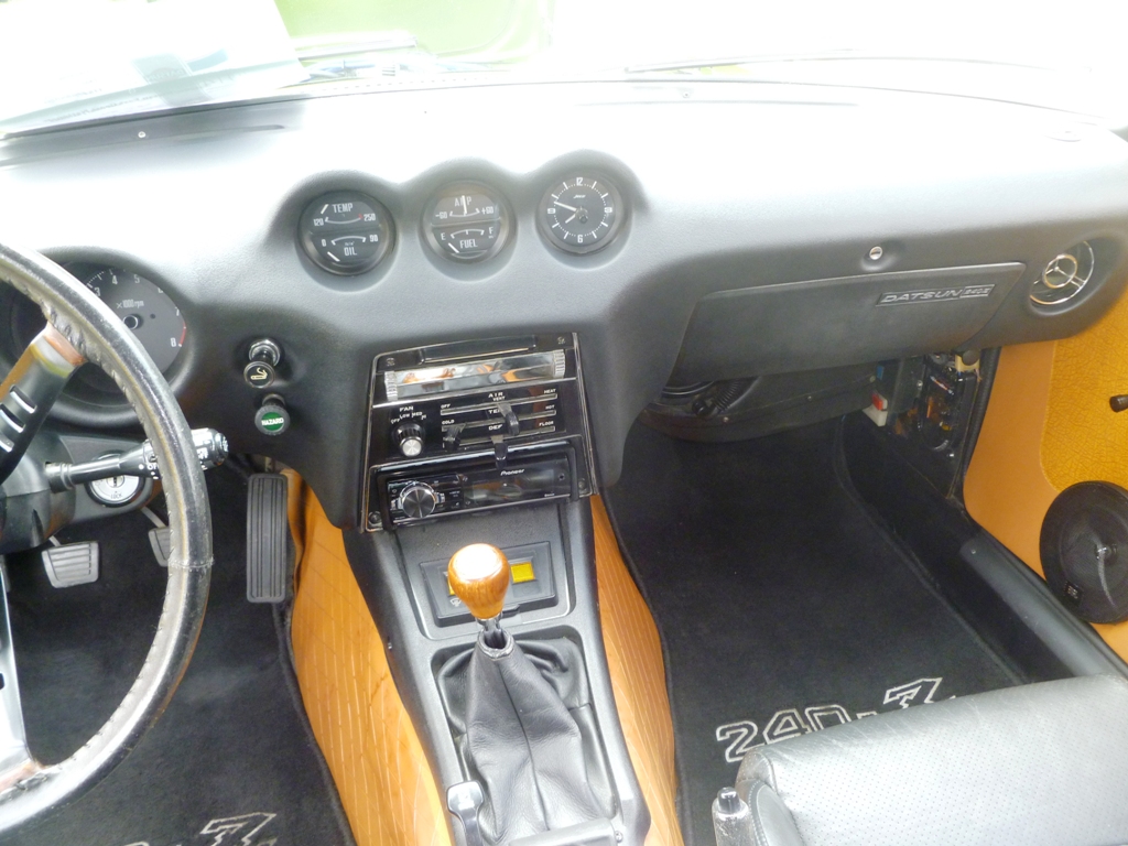

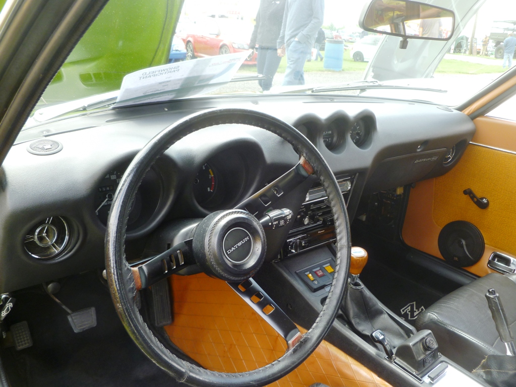

June 15, 201410 yr comment_449854 Attached are some pics of the final installation (I also refinished the metal spokes of my steering wheel and my wood shift knob): Link to comment https://www.classiczcars.com/forums/topic/45347-full-dash-cover-installation-help/?&page=4#findComment-449854 Share on other sites More sharing options...
June 15, 201410 yr Author comment_449856 Looks great Link to comment https://www.classiczcars.com/forums/topic/45347-full-dash-cover-installation-help/?&page=4#findComment-449856 Share on other sites More sharing options...

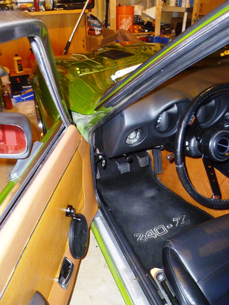

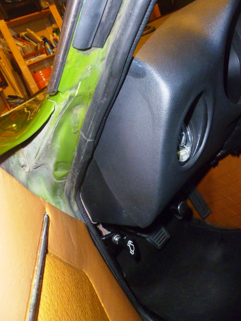

June 15, 201410 yr comment_449860 Nice job, great results. Your attention to planning and detail has really paid off. I'm curious about the extent of coverage this cap provides on the ends of the dash (i.e. the surfaces visible only when the doors are open). If you get a minute, what you mind posting another photo or two?Also: 1. As you know, there's conflicting advice about where to apply the adhesive. Which approach did you choose? What adhesive did you use?2. Do you think the cap installation clearances would have tolerated a layer of 1/16" open-cell foam between the dash and the cap? I'm thinking that the foam might provide a bit of cushioning for areas where the dash and cap don't actually meet. Maybe just use in the broad top surfaces? Link to comment https://www.classiczcars.com/forums/topic/45347-full-dash-cover-installation-help/?&page=4#findComment-449860 Share on other sites More sharing options...
June 15, 201410 yr comment_449870 Bob, I took a couple of pics for you. Normally, you really don't notice the edges of the dash cap. The flash used to take these pics make it a lot more noticeable. 1. I followed the directions / used the adhesive provided. I applied adhesive around the edges of the dash cap (i.e at the ends, near the windshield, at the bottom of the dash cap and around all openings). 2. I see no need to add a layer of foam. Just leave as is. Link to comment https://www.classiczcars.com/forums/topic/45347-full-dash-cover-installation-help/?&page=4#findComment-449870 Share on other sites More sharing options...
