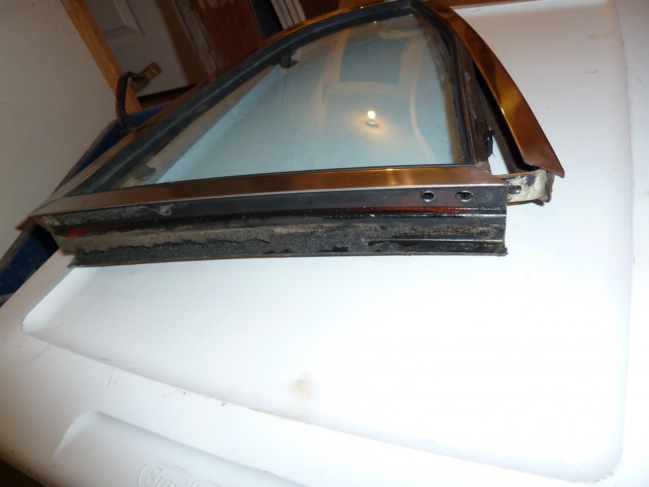

I'm refurbishing my quarter glass windows on both sides. I have the new seals and the urethane sealer that you put on the surfaces. I cleaned up the stainless frames very well.
My question is, what is attached to the forward edges next to the door? There appears to be either or both a corner piece around the forward bottom corner or and piece that attaches along the entire forward edge. Either way something black either paint or a piece of rubber appears to have exist along this edge at one time. I have a set of 72 quarter glass as well, and there is some thick residue of some kind along those edges. It looks like old rubber. It doesn't seem logical that Nissan left this edge bare. My understanding is the the 280Z quarter windows had a rubber component riveted onto the forward edge. Black Dragon Automotive (bottom of page 13) shows a part #4 Seal-Front Quarter - LH & RH for 70-78 Z's. Anyone used this part?
So I'm a bit confused as to what was actually there. I'd appreciate some help.

Thanks. Well I know there was something black on the entire surface, it was not bright stainless.
If your frame has the 4 screws on the leading edge, (under your current black stuf,...then it came with the full length molding. If it is the 2 screw version, then it came with just the smal tabs.
I cleaned my up really well while I was polishing teh stainless.

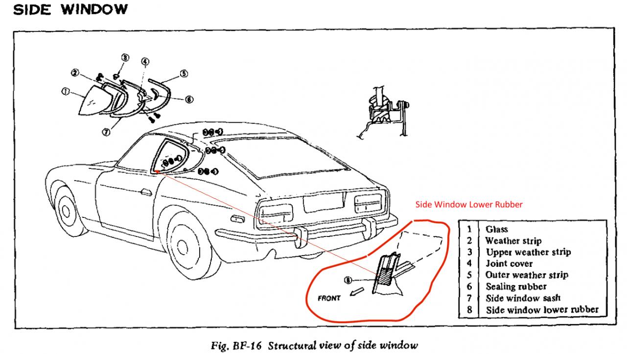

Item 6 in the drawing "Sealing Rubber" can be reused from the original.

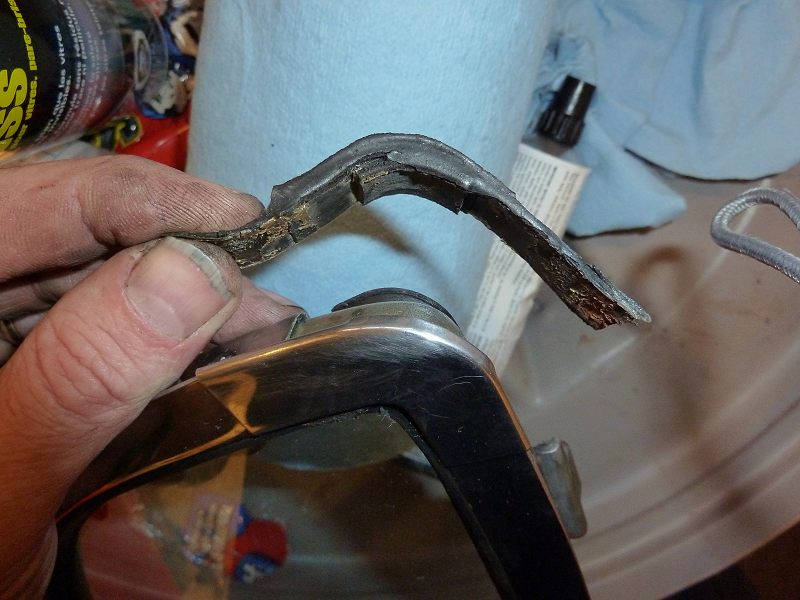

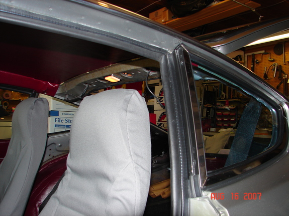

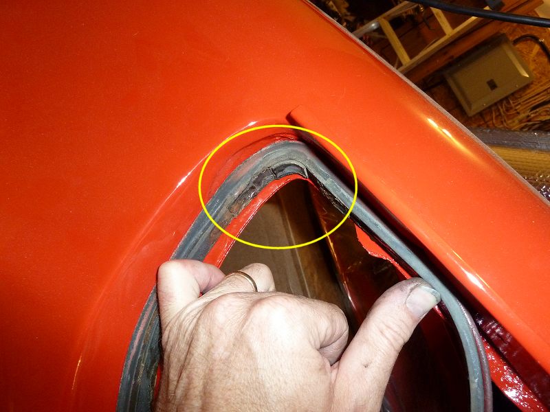

It is difficult to see as it is squished and bonded. Here are two pics to help:
Pic of old seal in place... if you look closely you can see the "Sealing Rubber"
Here is is after liberation (it is two pieces of flat rubber):

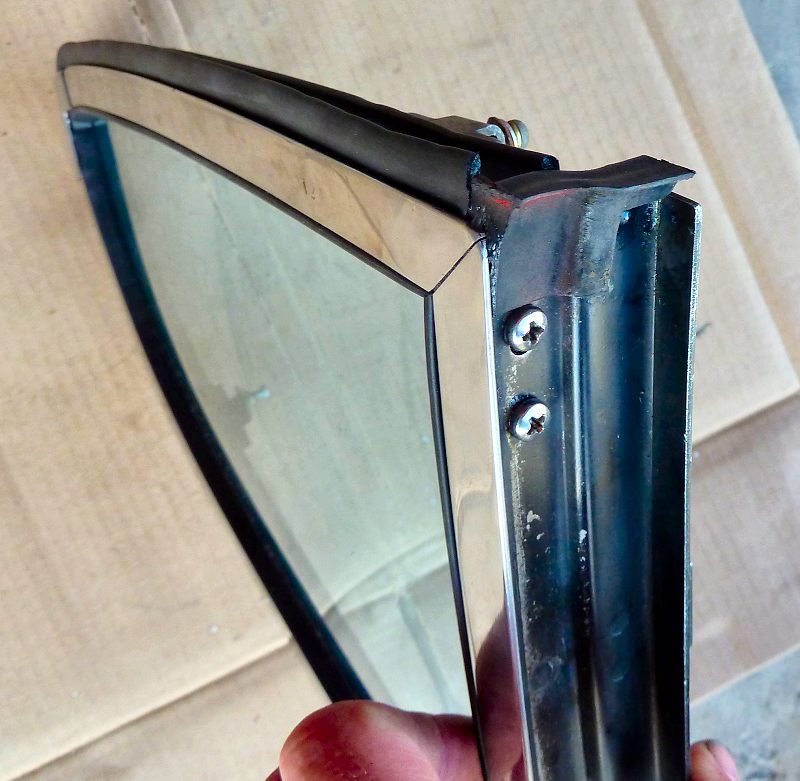

Here is the "Upper Weather Strip" at the top of the side window. (Item 3 in the drawing above)
See the dark finish along the edge? That's what I mean. Looks like it was painted. I'll probably reuse that built up part again instead of trying to fab it, because they appear to have tapered the rubber sections in the stack.
Edited by bpilati

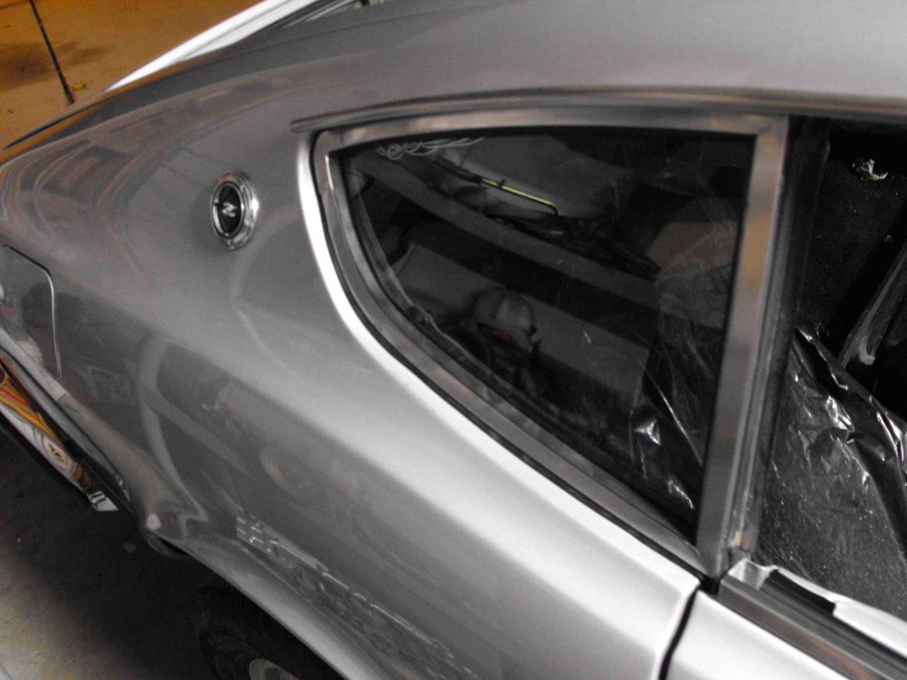

Jan 71 240z.
[ATTACH=CONFIG]59777[/ATTACH][ATTACH=CONFIG]59780[/ATTACH]
[ATTACH=CONFIG]59778[/ATTACH][ATTACH=CONFIG]59779[/ATTACH]
[ATTACH=CONFIG]59776[/ATTACH]
What's that rough residue along the forward edge in second photo?
