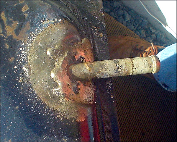

January 5, 20178 yr Author comment_509707 Hello ladies and gents Well the most dreaded thing has happened, the unit itself is now leaking. I replaced the o ring a few months back and everything was peachy. Came out this past Monday to find a fairly largish puddle of fuel under my car. Took it to the shop today and long and behold the unit itself is leaking. Being that's its a 76, it appears that these aren't really available anywhere. Does anyone have any suggestions other than JB welding it? Is there a aftermarket replacement I can use? Cheers Jan Link to comment https://www.classiczcars.com/forums/topic/45405-sending-unit-leaking/?&page=2#findComment-509707 Share on other sites More sharing options...
January 6, 20178 yr comment_509711 Plumber's solder. Edited January 6, 20178 yr by 240260280 Link to comment https://www.classiczcars.com/forums/topic/45405-sending-unit-leaking/?&page=2#findComment-509711 Share on other sites More sharing options...
January 6, 20178 yr comment_509728 On 12/18/2016 at 10:31 AM, Zed Head said: You might try some fuel tank liner, like Red-Kote. Just a dab instead of a tank full. +1 this is good stuff. cover the inside of the sending unit and you should be good to go Link to comment https://www.classiczcars.com/forums/topic/45405-sending-unit-leaking/?&page=2#findComment-509728 Share on other sites More sharing options...
