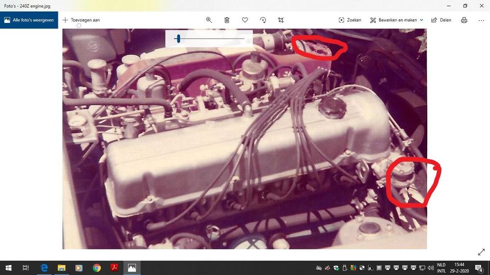

Was just looking at a picture from the first owner in late 1970's.. seems my 240Z originally had the steel riveted fan ( early ).. somehow must have been changed to the later plastic one some point in time.
Also the air cleaner is different, but it didn't came with that one anyhow when I bought it. I now have the early one without that winter choke thing or what is it?

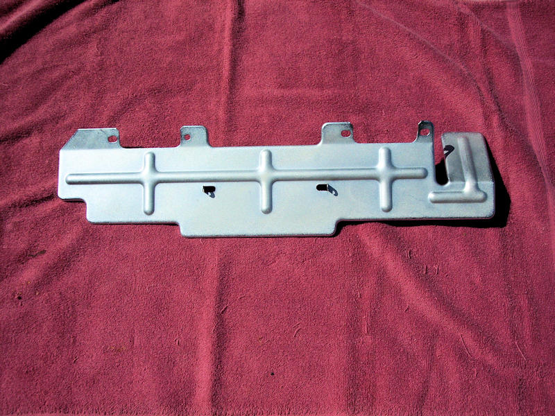

A while back I picked up a large group of used parts that included several heat shields.  One of them was unique in that it had no notch for the heat riser tube to the air filter (1st pic).  In checking with some friends, I got a comment from Carl Beck suggesting that the heat riser was added somewhere around VIN 6,000.  It was the heat riser feature that caused the air filter change for the butterfly flap.  All the parts catalogs I've seen only show the heat riser version of the heat shield - one of those constant improvements in the production cycle.  So... assuming Carl is correct on the VIN change, your car has the early version of the air filter.  Check your heat shield to see if it has the notch.

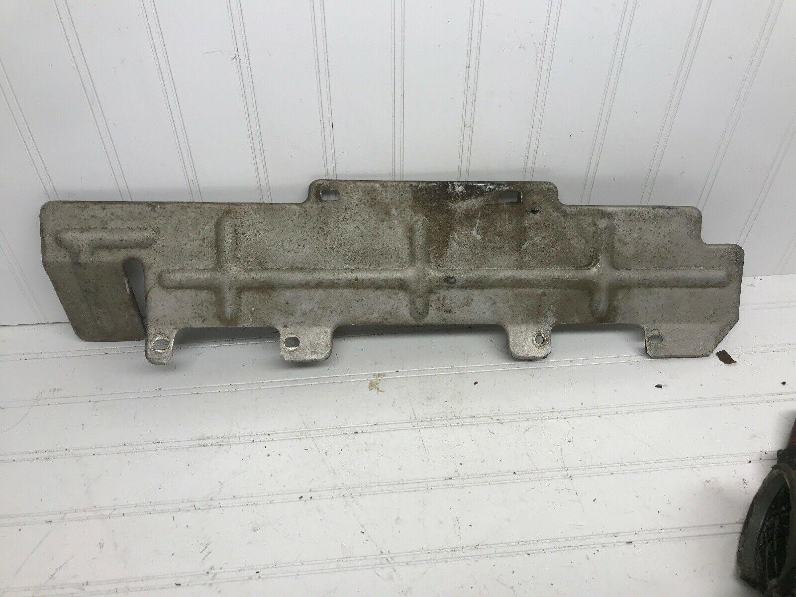

My #6521 car also has the early heat shield, picture attached. I noticed that the retainers for the throttle return springs are lower on mine and the picture from Phillip than Jim's.
rn
Yes, I noticed the higher attach points on this shield when I had it, could never figure out why.  The same goes for the unique fuel rail I have that has different mounting tangs and a much larger opening for the fuel return orfice.

Okay. I will check the shield when taking it out of storage. But the picture I posted above must be how it came from the factory, this is only a few years after he bought it new ( maybe 5 ). So the air filter house pictured with the flap must and the metal radiator fan must be the correct one that came with the car.
The later plastic fan I have now was allready on, and the air filter was a wrong 73 one for the flattops, so I found this early one, but this is without the flap.
I might source a metal fan, and put it on, just for the correct ness, but the air filter i'll leave this way, hate the flap thing.
