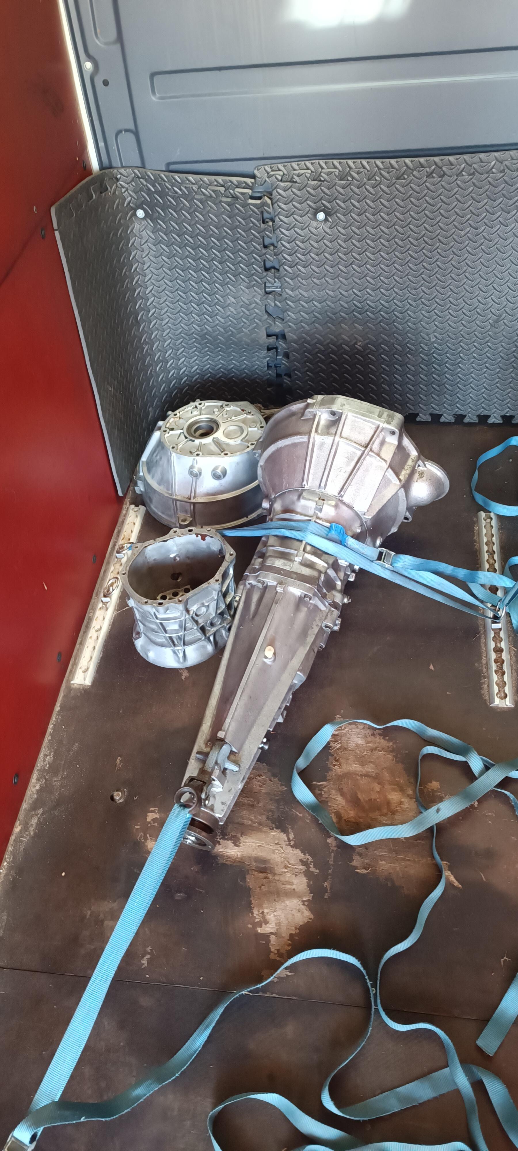

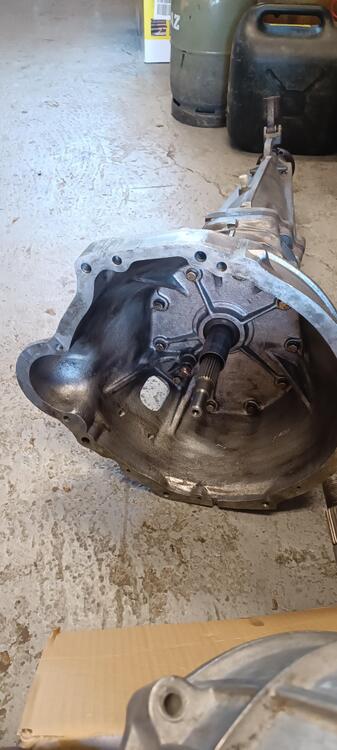

May 14, 2024May 14 Author comment_665448 I finally picked up the A type....5 speed today.... rebuild.. I won't install it this year anyhow, but then I have it laying around, the guy who rebuild is going to retire and close his shop next year, so I was just in time... Link to comment https://www.classiczcars.com/forums/topic/45423-my-datsun-240z/?&page=50#findComment-665448 Share on other sites More sharing options...

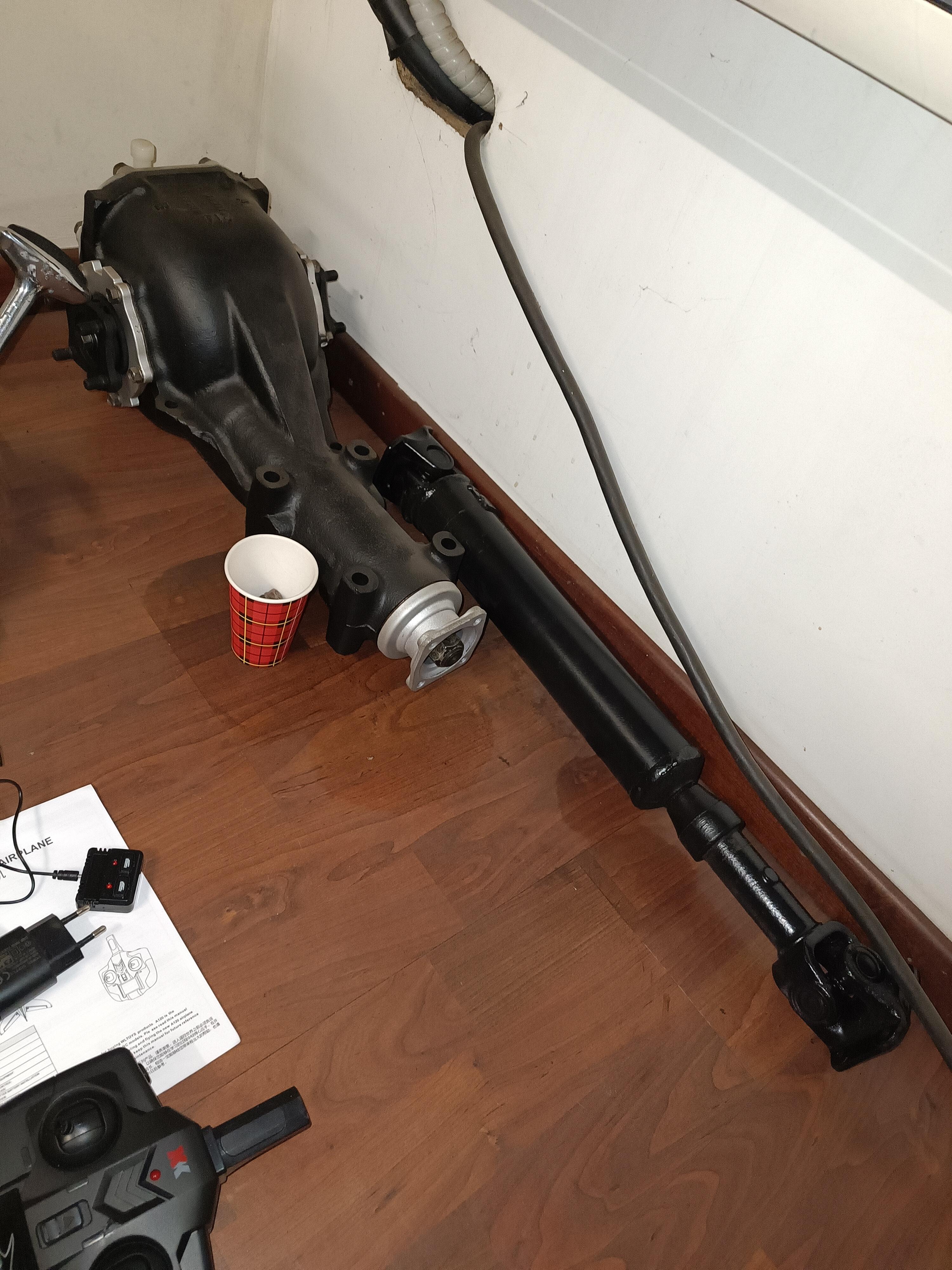

May 17, 2024May 17 Author comment_665593 To be sure ? I assumed the 3.900 diff ratio came behind this FS5C71A and not the 3.36 or 3.75 ( automatic ? ) Does somebody have a manual or something to check it out ? Link to comment https://www.classiczcars.com/forums/topic/45423-my-datsun-240z/?&page=50#findComment-665593 Share on other sites More sharing options...
May 17, 2024May 17 comment_665594 21 minutes ago, bartsscooterservice said: To be sure ? I assumed the 3.900 diff ratio came behind this FS5C71A and not the 3.36 or 3.75 ( automatic ? ) Does somebody have a manual or something to check it out ? As standard equipment on the S30-series Z range, FS5C71-A was usually paired with 3.9:1 ratio R180 in all markets except USA & Canada (including Japan). It was also paired with 4.44:1 ratio R192 LSD on Japanese market PS30 Fairlady Z432 and PS30-SB Fairlady Z432-R. Link to comment https://www.classiczcars.com/forums/topic/45423-my-datsun-240z/?&page=50#findComment-665594 Share on other sites More sharing options...
May 17, 2024May 17 Author comment_665603 4 hours ago, HS30-H said: As standard equipment on the S30-series Z range, FS5C71-A was usually paired with 3.9:1 ratio R180 in all markets except USA & Canada (including Japan). It was also paired with 4.44:1 ratio R192 LSD on Japanese market PS30 Fairlady Z432 and PS30-SB Fairlady Z432-R. Okay, thanks ! Then the diff I found with it is correct Link to comment https://www.classiczcars.com/forums/topic/45423-my-datsun-240z/?&page=50#findComment-665603 Share on other sites More sharing options...
May 17, 2024May 17 comment_665610 3 hours ago, bartsscooterservice said: Okay, thanks ! Then the diff I found with it is correct Very likely to be from an original European market variant pairing, yes? Have you got the correct double-flanged sliding-joint propeller shaft to join the two together? Link to comment https://www.classiczcars.com/forums/topic/45423-my-datsun-240z/?&page=50#findComment-665610 Share on other sites More sharing options...
May 17, 2024May 17 Author comment_665611 34 minutes ago, HS30-H said: Very likely to be from an original European market variant pairing, yes? Have you got the correct double-flanged sliding-joint propeller shaft to join the two together? Yes.. Link to comment https://www.classiczcars.com/forums/topic/45423-my-datsun-240z/?&page=50#findComment-665611 Share on other sites More sharing options...
May 17, 2024May 17 Author comment_665614 Btw... What side of the propeller shaft goes to the transmission? Link to comment https://www.classiczcars.com/forums/topic/45423-my-datsun-240z/?&page=50#findComment-665614 Share on other sites More sharing options...
May 17, 2024May 17 comment_665620 1 hour ago, bartsscooterservice said: Btw... What side of the propeller shaft goes to the transmission? Fat (male) end to the back, skinny (female) end forward: Link to comment https://www.classiczcars.com/forums/topic/45423-my-datsun-240z/?&page=50#findComment-665620 Share on other sites More sharing options...
