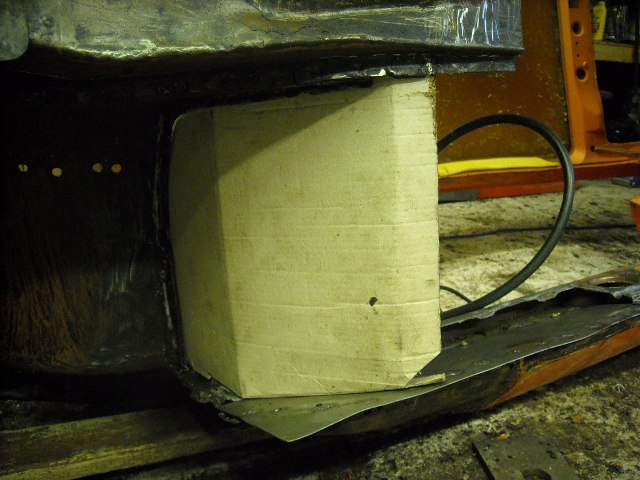

Had to cut out the rear seat mounts cause I couldn't find any other way to get through the layers
and I already removed the bottom layer before I cut out this section,
Here I've started to prep for floor pan fitment, I was hoping that I could keep the forward seat mount in place and fit from underneath but I'm not sure I'm going to be able to do that.

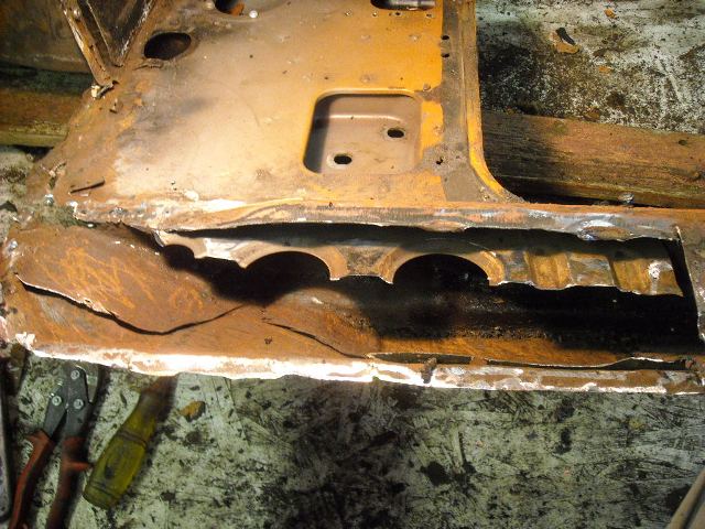

Parts of the rockers need work too but if the floor is out at the same time as the rocker I'll have to take it off the rotis and block it up horizontal to keep proper spacing.
When I'm I going to learn, VISIBLE RUST IS ONLY 10% OF WHAT IS THERE!

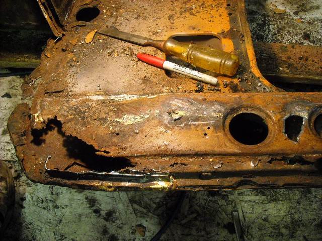

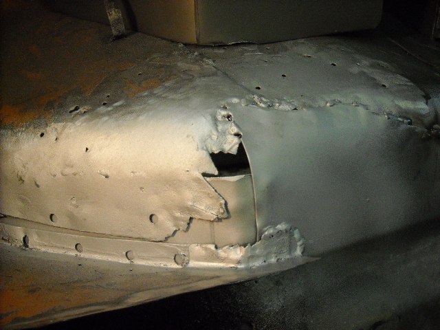

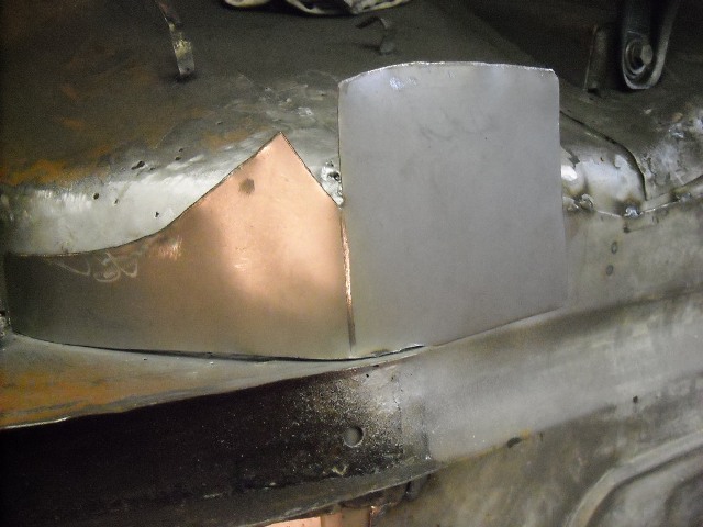

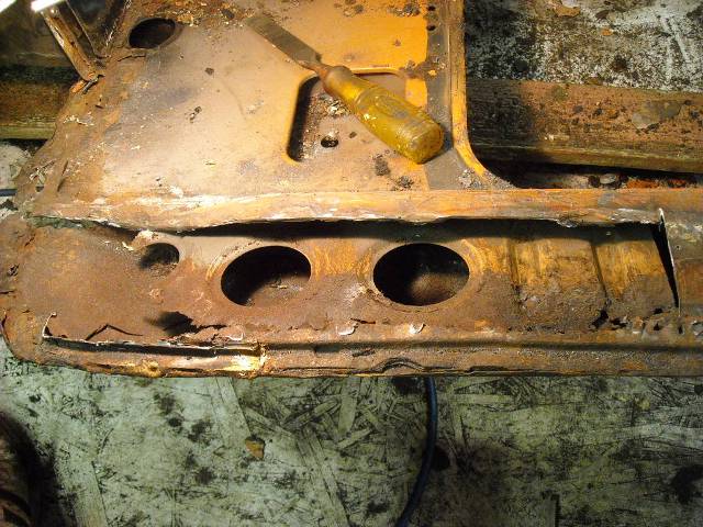

Started work on the Passenger side inner rocker, it's in bad shape but no one makes these pieces yet so I'll have to fab them out of panel.
The second panel in is actually the inner panel above that goes up to the dash support and down to the bottom of the rocker,
Here I have cut off the rusty bits off the inner panel, now I can clean everything inside before building it back up. The inner panel is 20 gauge and the next one out (or in depending on how you see it) is 16 gauge. All I could find is 18 ga so I'll use that for both and should end up with the same strength.
Before I do that, can anyone tell me if two layers of 18 ga equal one of 20 ga and one of 16 ga ?
You can also see the what is left of the original rocker, still not sure if I'm going to cut all of that out yet or not. It does add strength but is also a source of rust, maybe I'll flood it with phosphoric acid to convert the rust then flood it with POR15

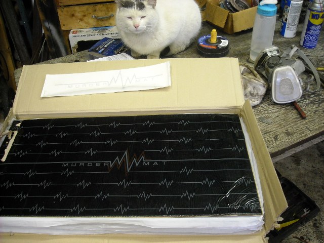

And I got what I ordered just 2 days ago, Murder Max, I've read a couple of reviews and both were glowing.
Multi layer, reflective aluminum foil inside and the price beats everyone else for sound deading.

You should be fine with 18 gauge. I'm not even sure where they used 16 except the frame rails.

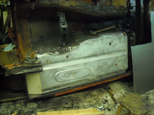

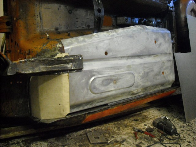

Well just plugging away at it, starting to fit the passenger side pan and create a template for the forward foot panel.
I know these pans are normally installed from inside but I really don't want to remove the seat mount/brace. I'm just afraid of the rocker sagging away and so far I can't see any draw backs to mounting from underneath.
If anyone knows of any I would like to hear them.

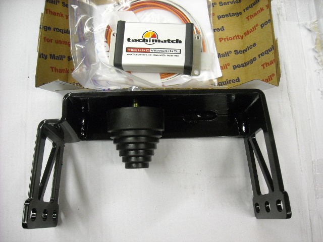

Got my Technoversions R/T mount and Tachadapter today,

I don't think there is a set way of putting in floors -either from the bottom or the top-just get er done;)
If i could have flipped my car over I think I would have gone your route. If you were also able to save the seat rails, then good for you, less work for later.

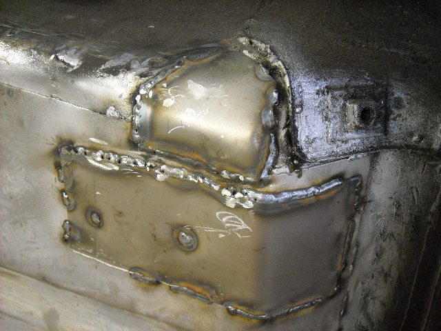

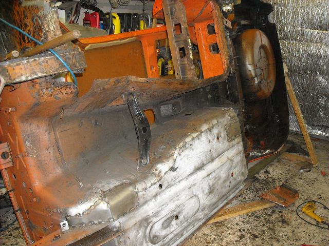

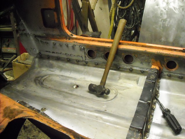

Here I'm almost finished welding in the passenger floor, I forgot to take a pic of the finished inside rocker but you can see it here.
The ragged edge is from the first guy 30 yrs ago, hard to make this kind of patch look good,
Fitting new patch,
and this side almost done just need to add the rails, so I've started on the driver side floor.

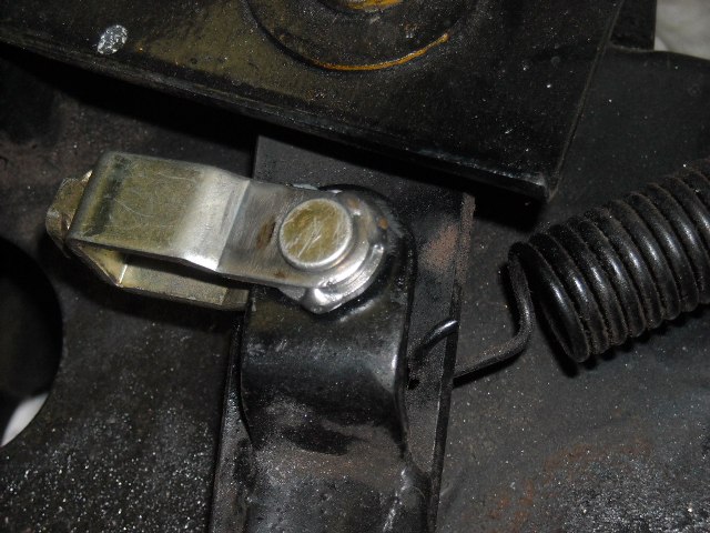

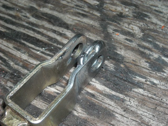

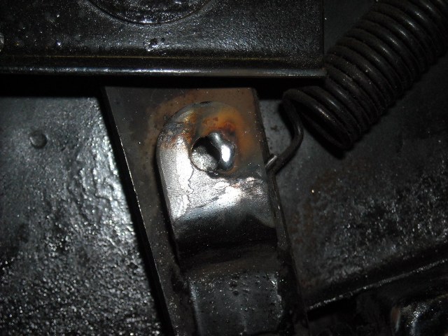

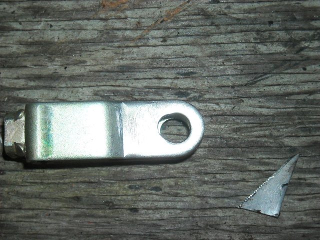

The clutch pedal pivot wash elongated from so many years of wear so added a bit of weld that I'll file round again.
Clutch M/C connecting piece was the same way,
All together with no slop.

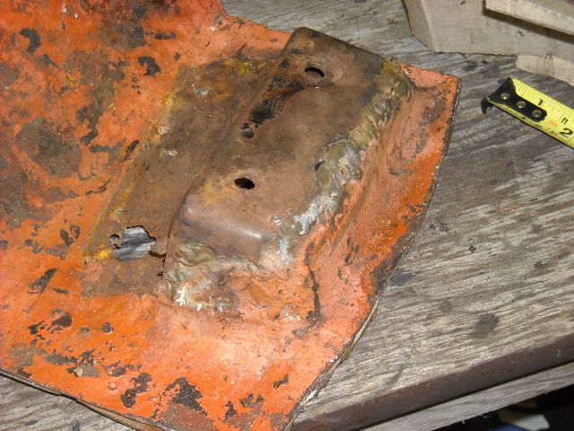

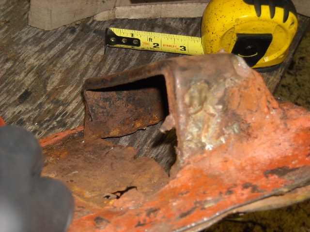

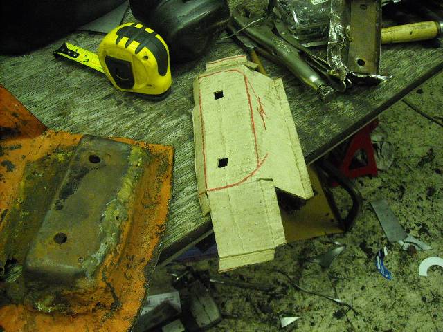

I have been lucky that all but one of the seat mounts were restoreable but not this one, too far gone,

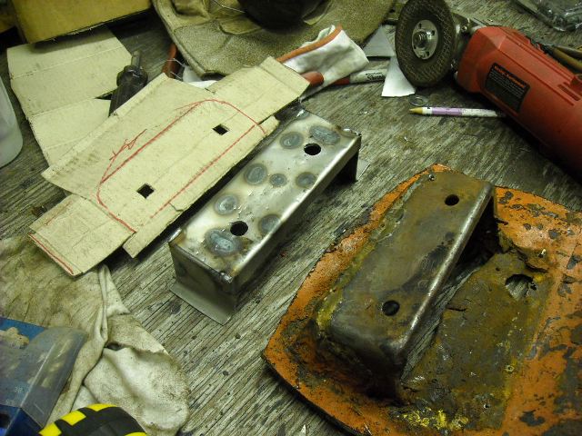

so made a template,
and welded the new one up this morning, once it's in I'll add some bracing.
