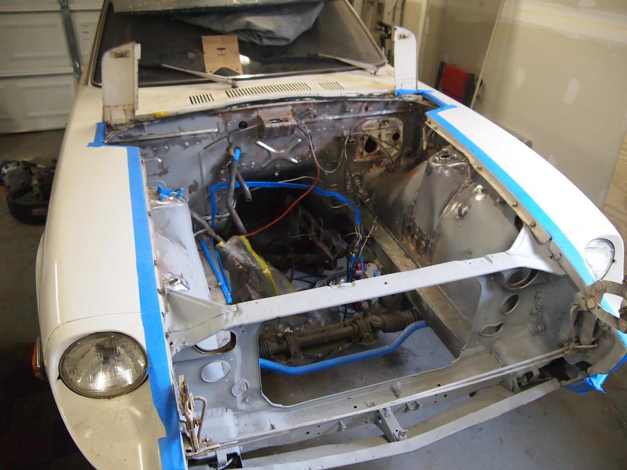

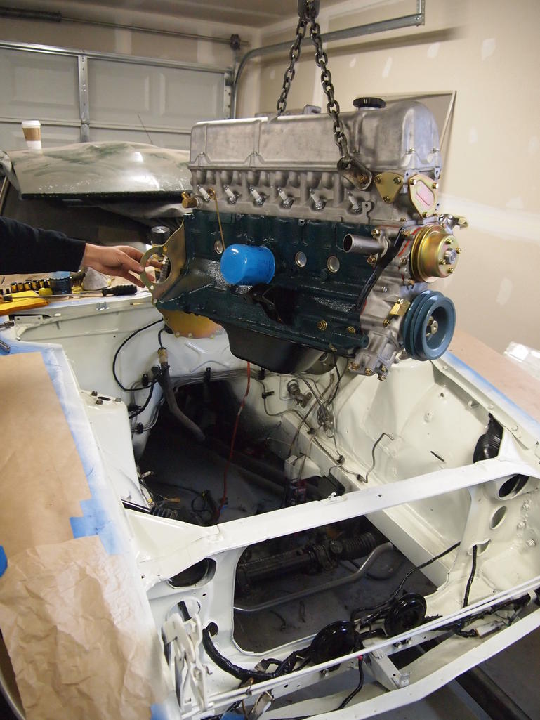

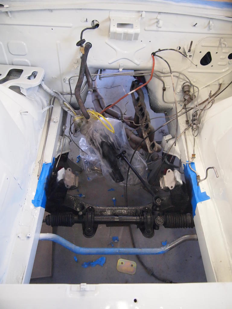

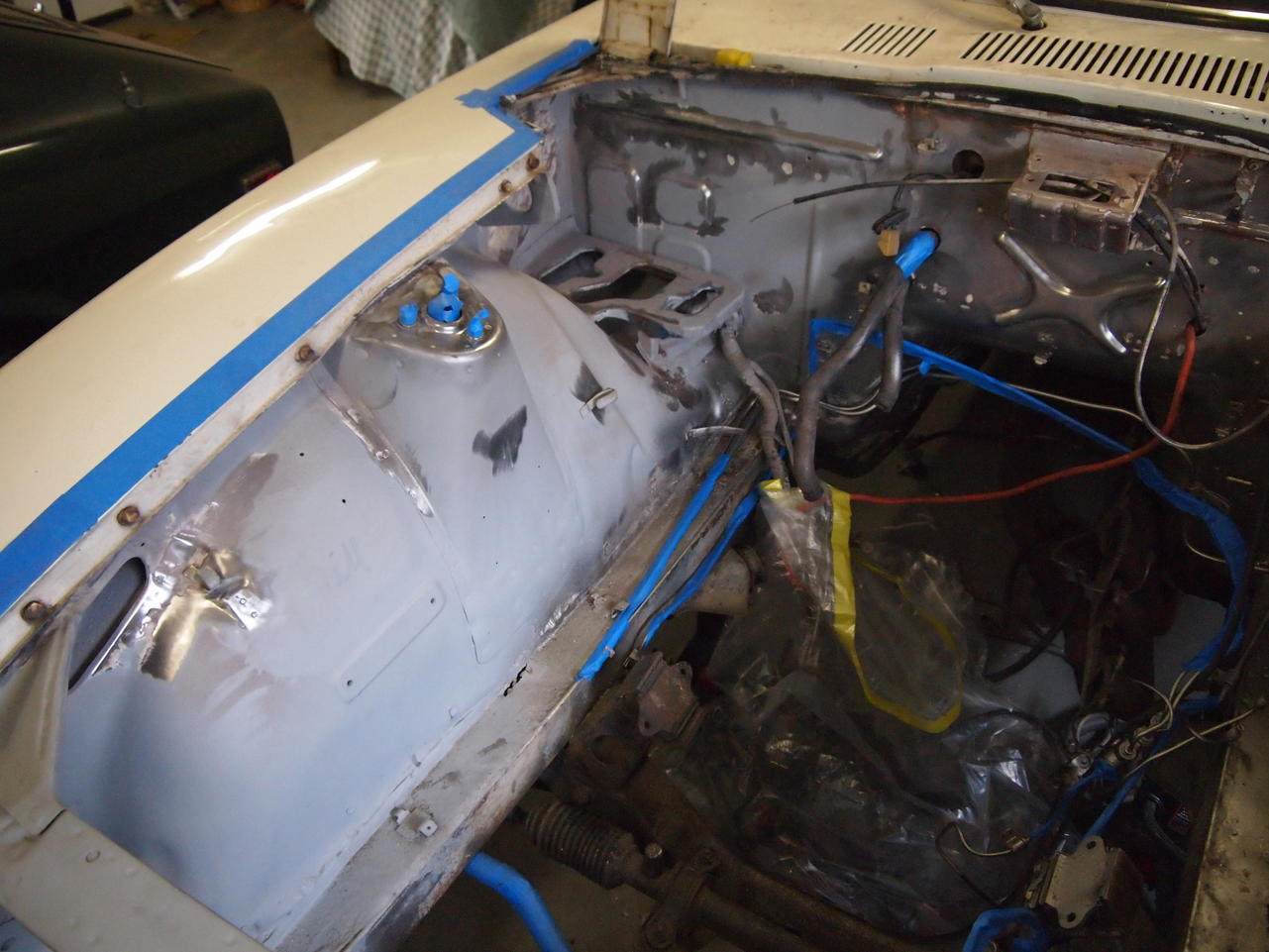

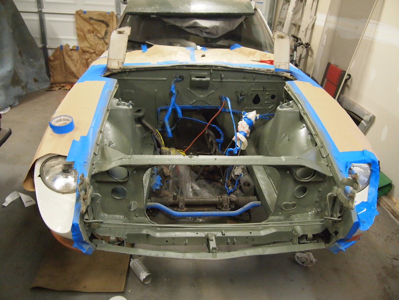

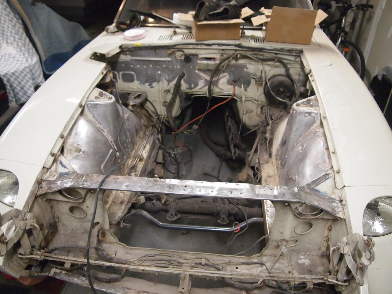

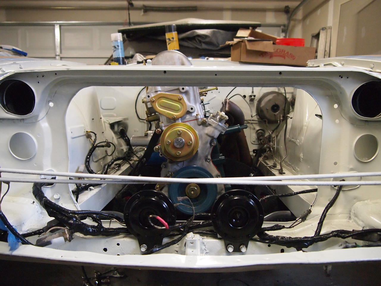

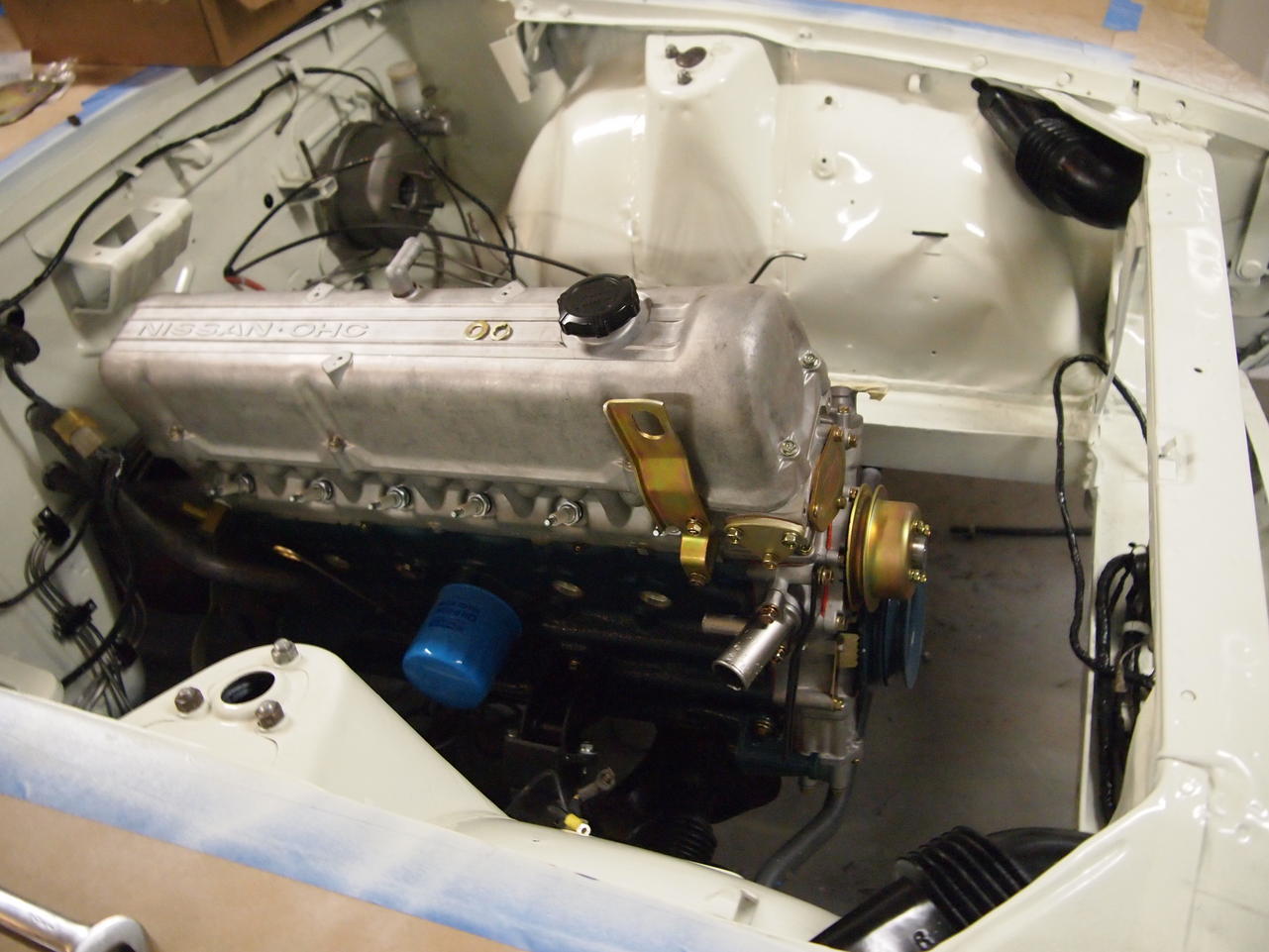

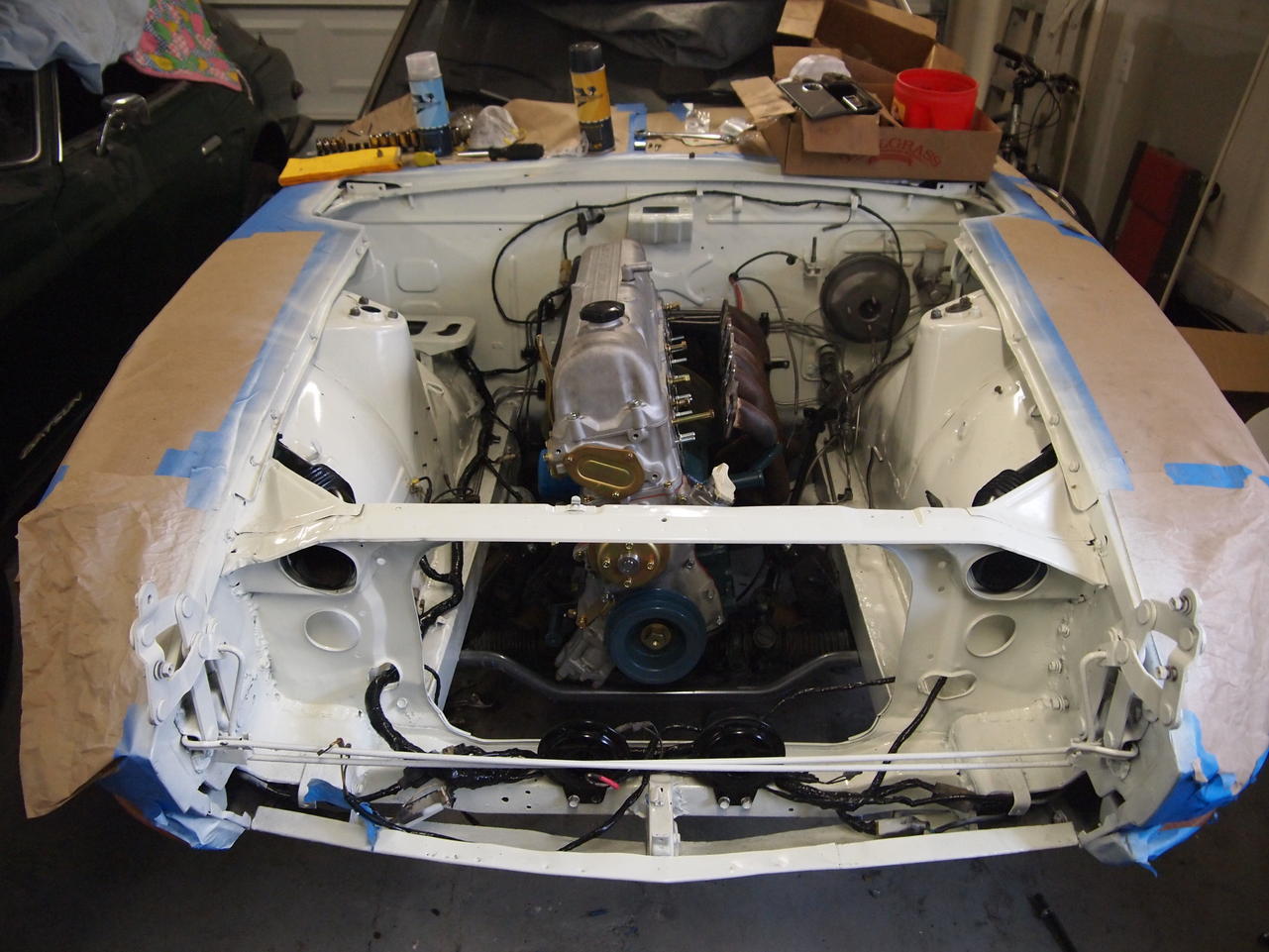

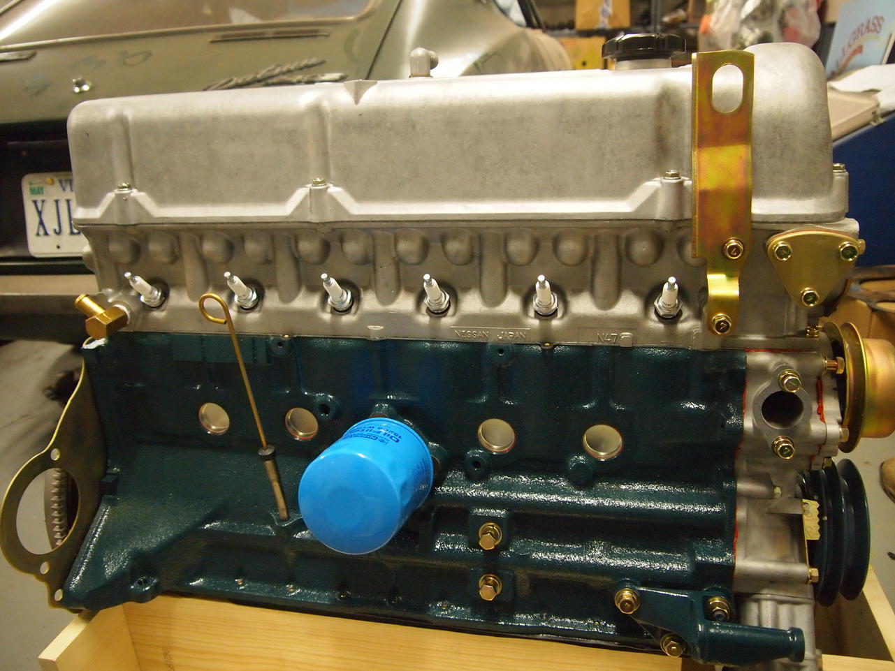

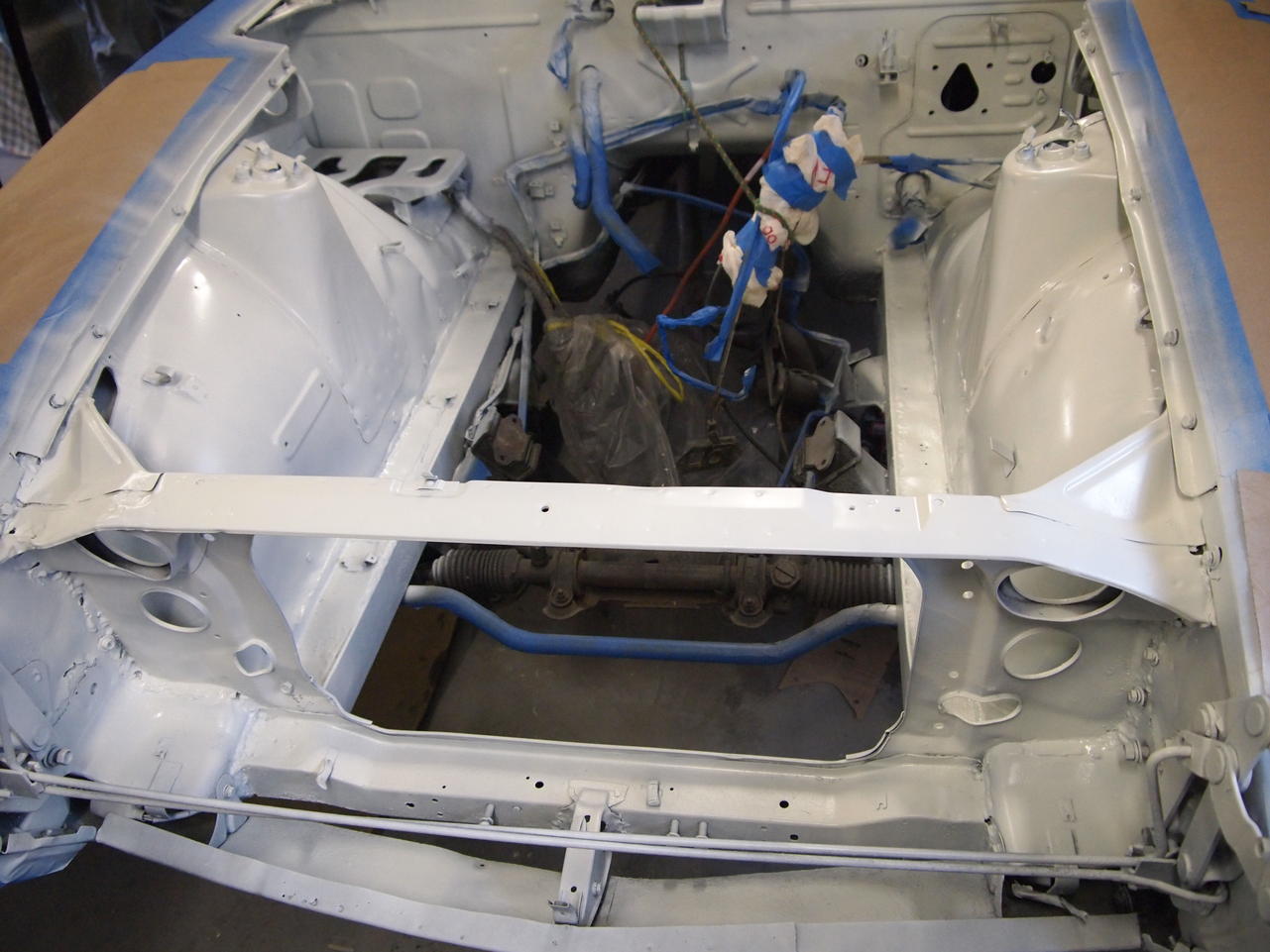

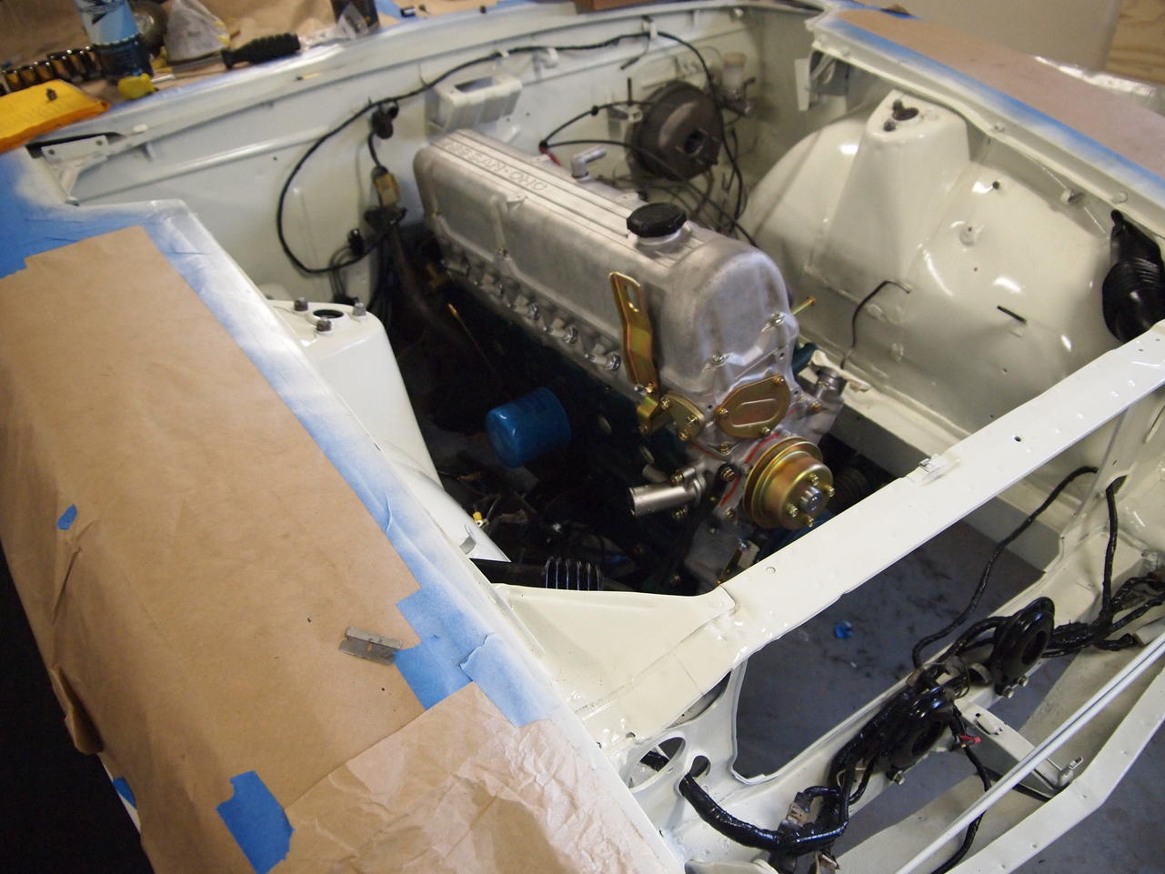

Restored the engine bay before dropping in the new motor. Ordered paint from AutomotiveTouchup.com and used Polar White, #215. It's not the same color as the exterior, but hopefully I can get the body repainted in the near future, and at least I'll know what color to use.

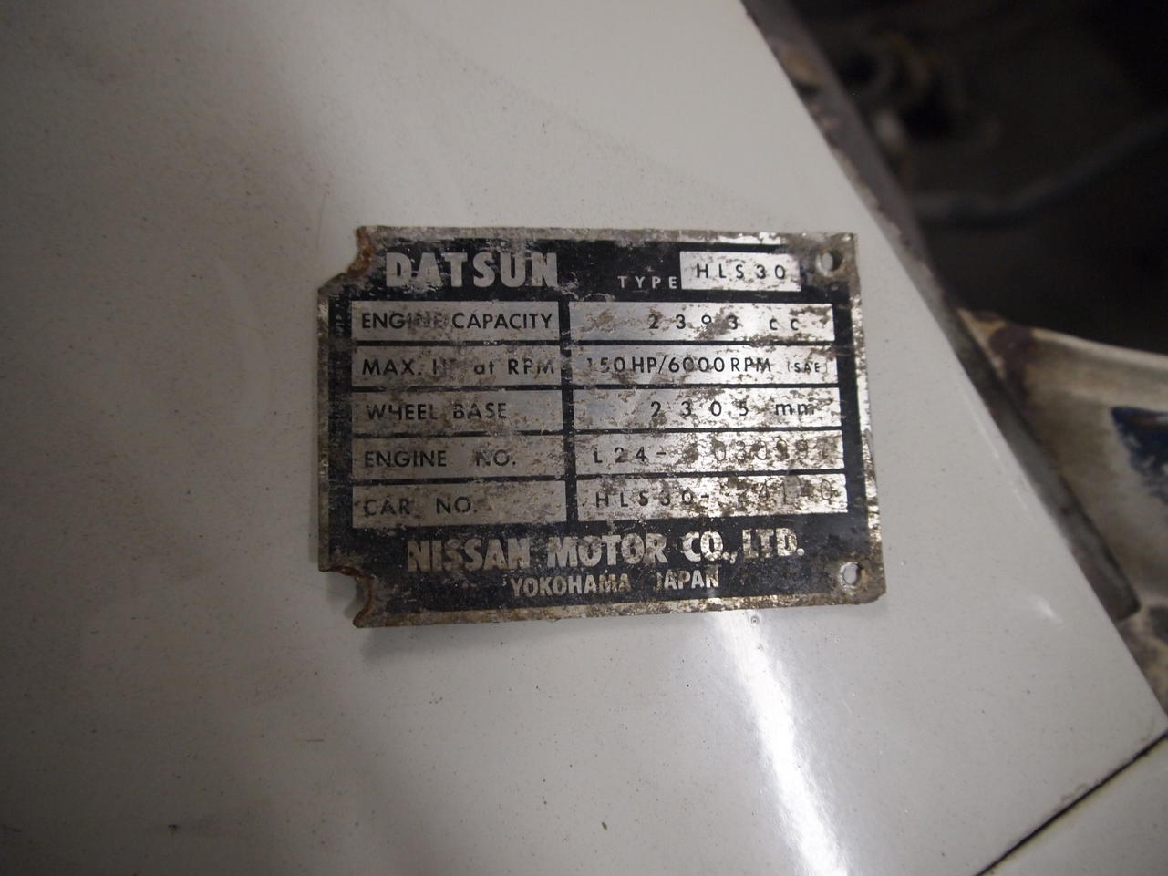

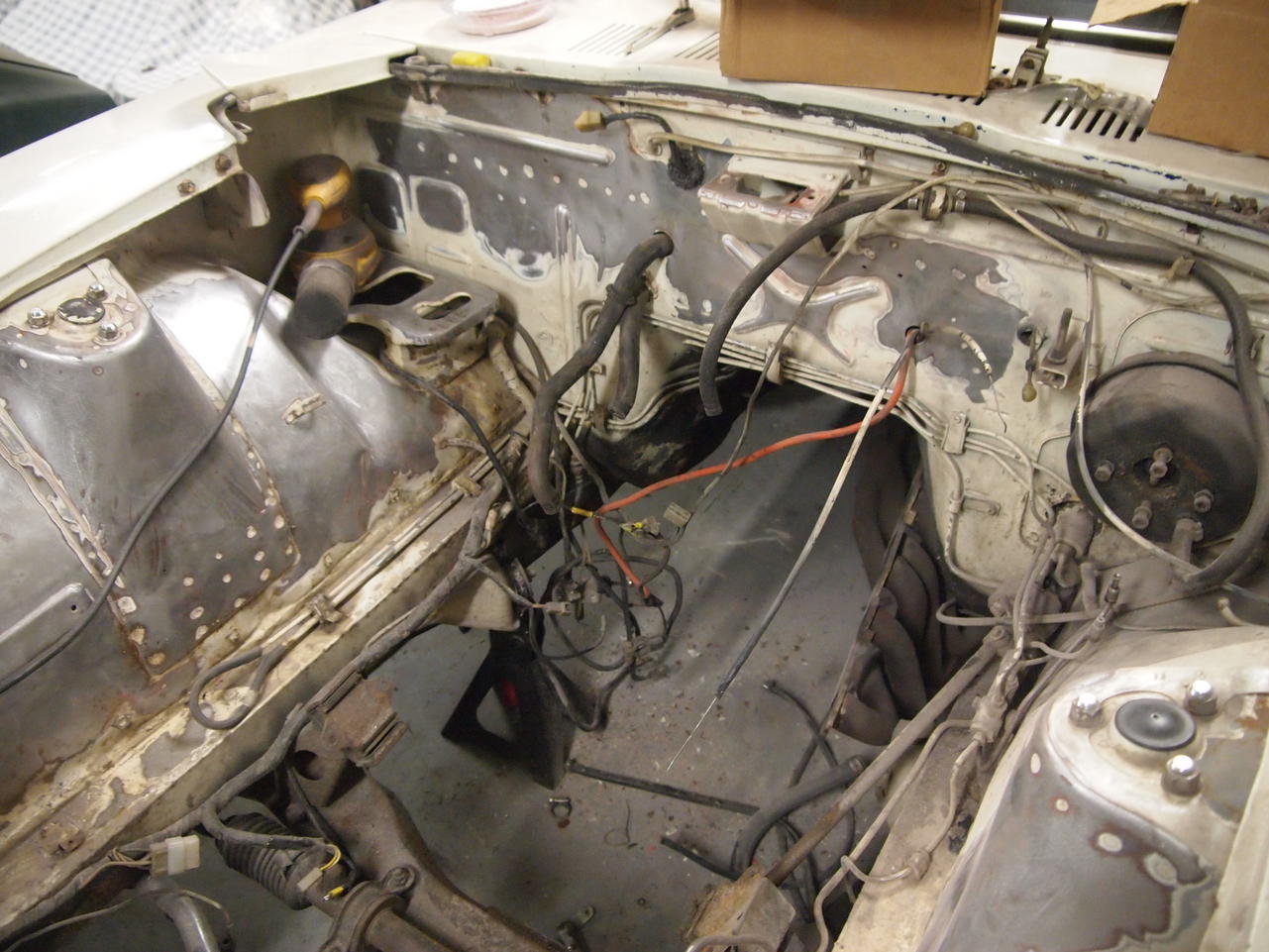

Created an incredible amount of dust in the garage. I need to roll both cars out this spring and just clean. Also, the old VIN plate wouldn't look right when finished. Ordered a replacement from Banzai Motorworks.

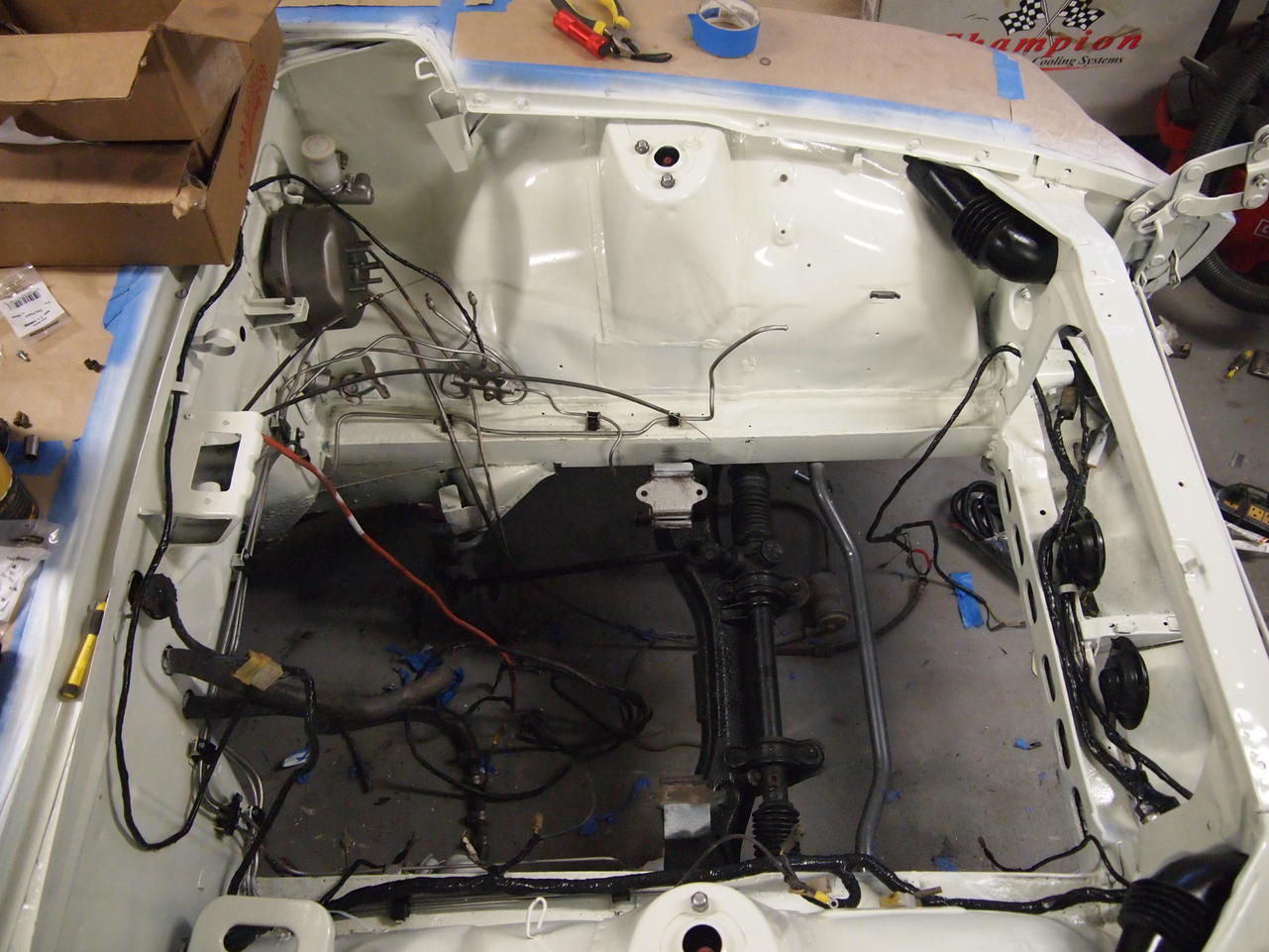

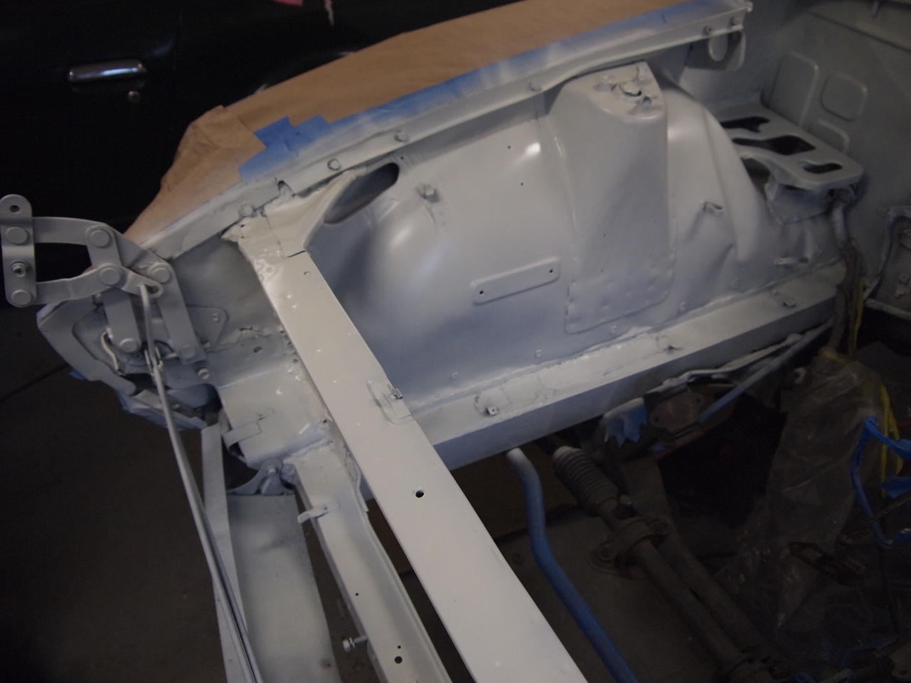

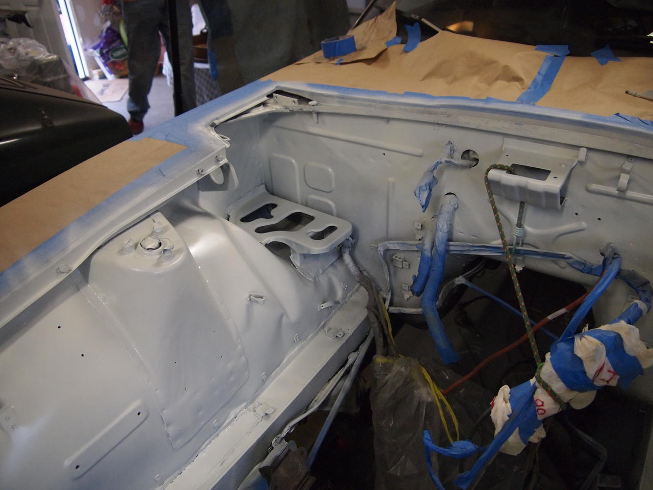

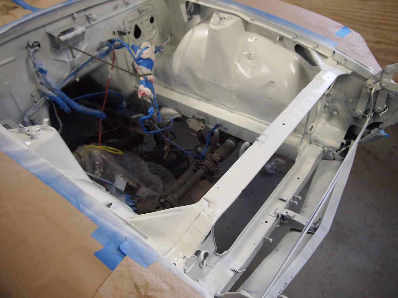

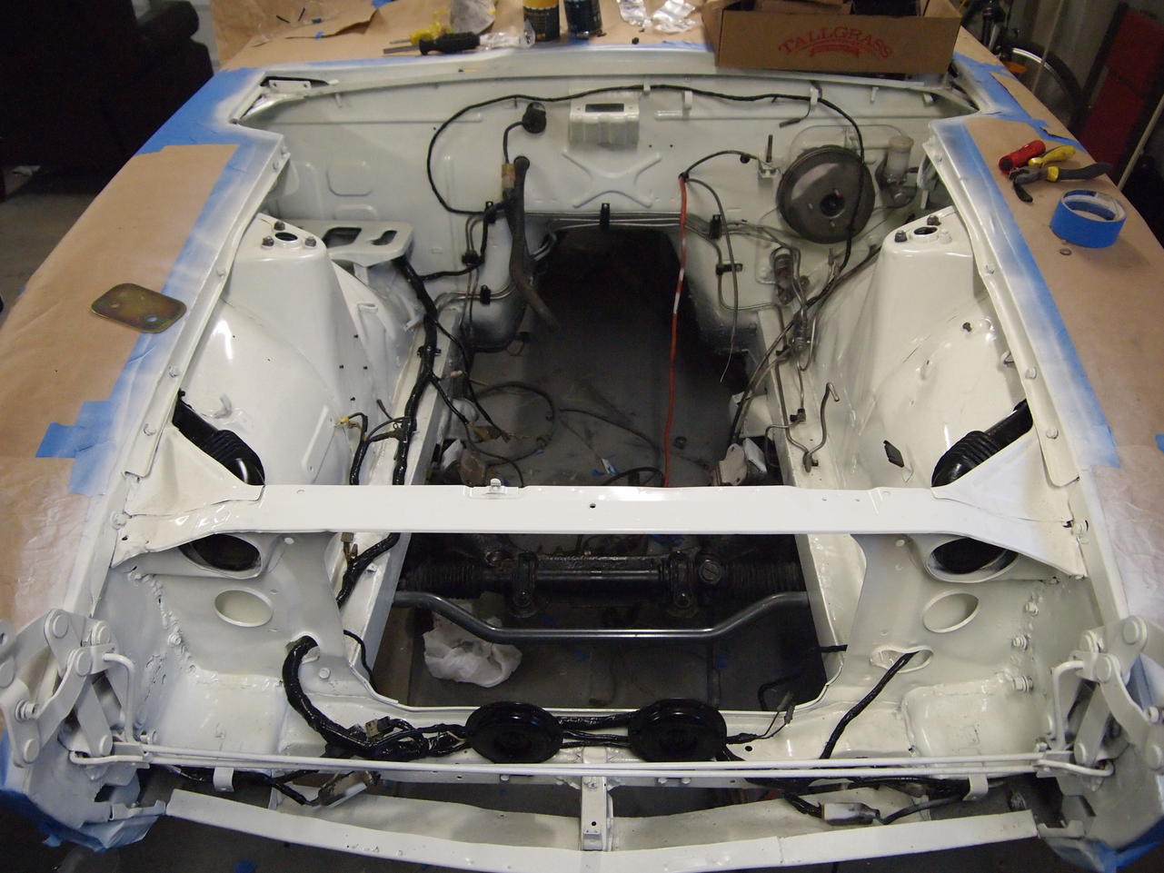

Primer and first coats.
Edited by ksbeta

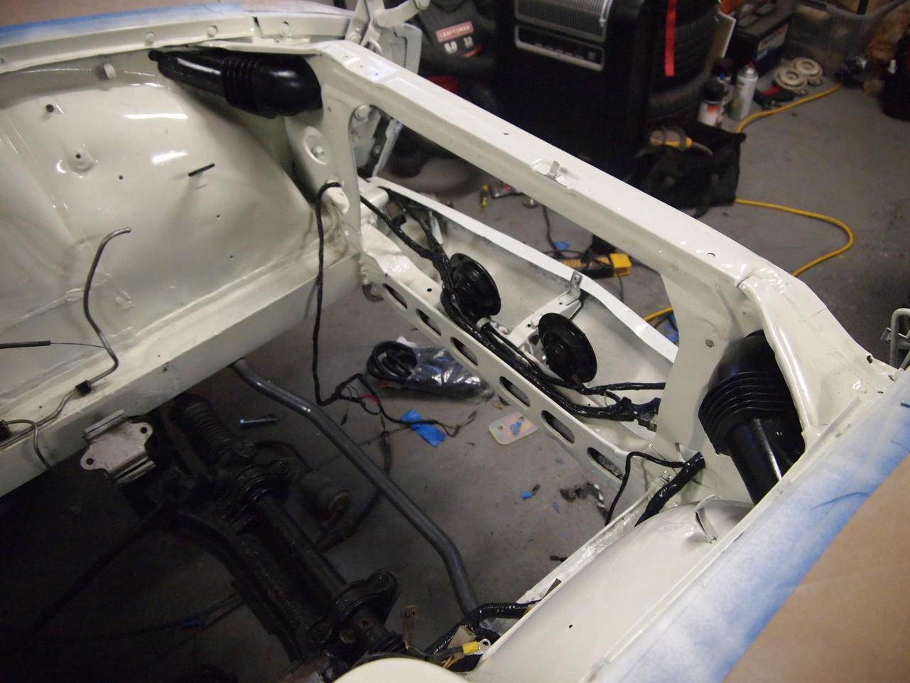

Stripped/painted the horns and hard-line mounts, just so they'd be clean. Didn't put too much thought into it, but black trim pieces + white engine bay = Dalmation car. Stupid stupid stupid.
Spent most of Sunday in the garage, trying to get the car back on the ground. Finally installed the 280ZX 5-Speed, which thankfully went in without too much trouble. Got the rear sway bar installed. I used the MSA kit, which requires drilling some holes under the carpet behind the seats and cursing a bit trying to compress the bushings.
