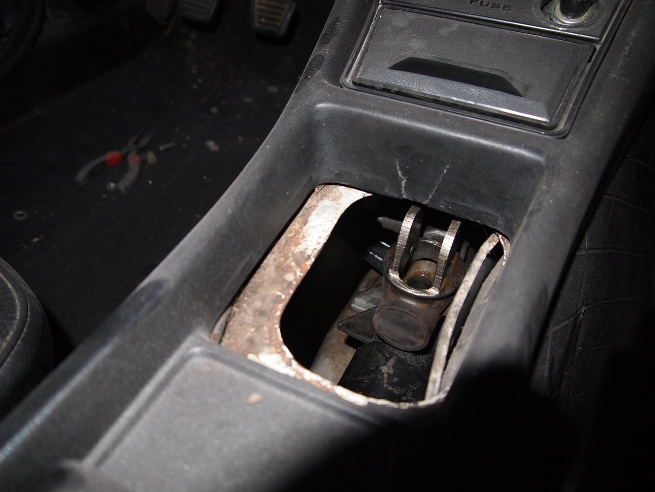

ZX Transmission installed. Obvious why a different shifter is needed

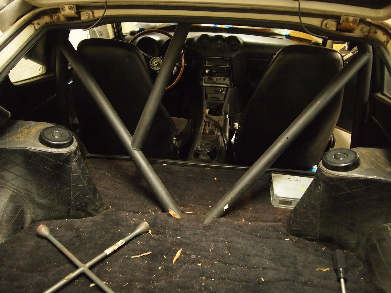

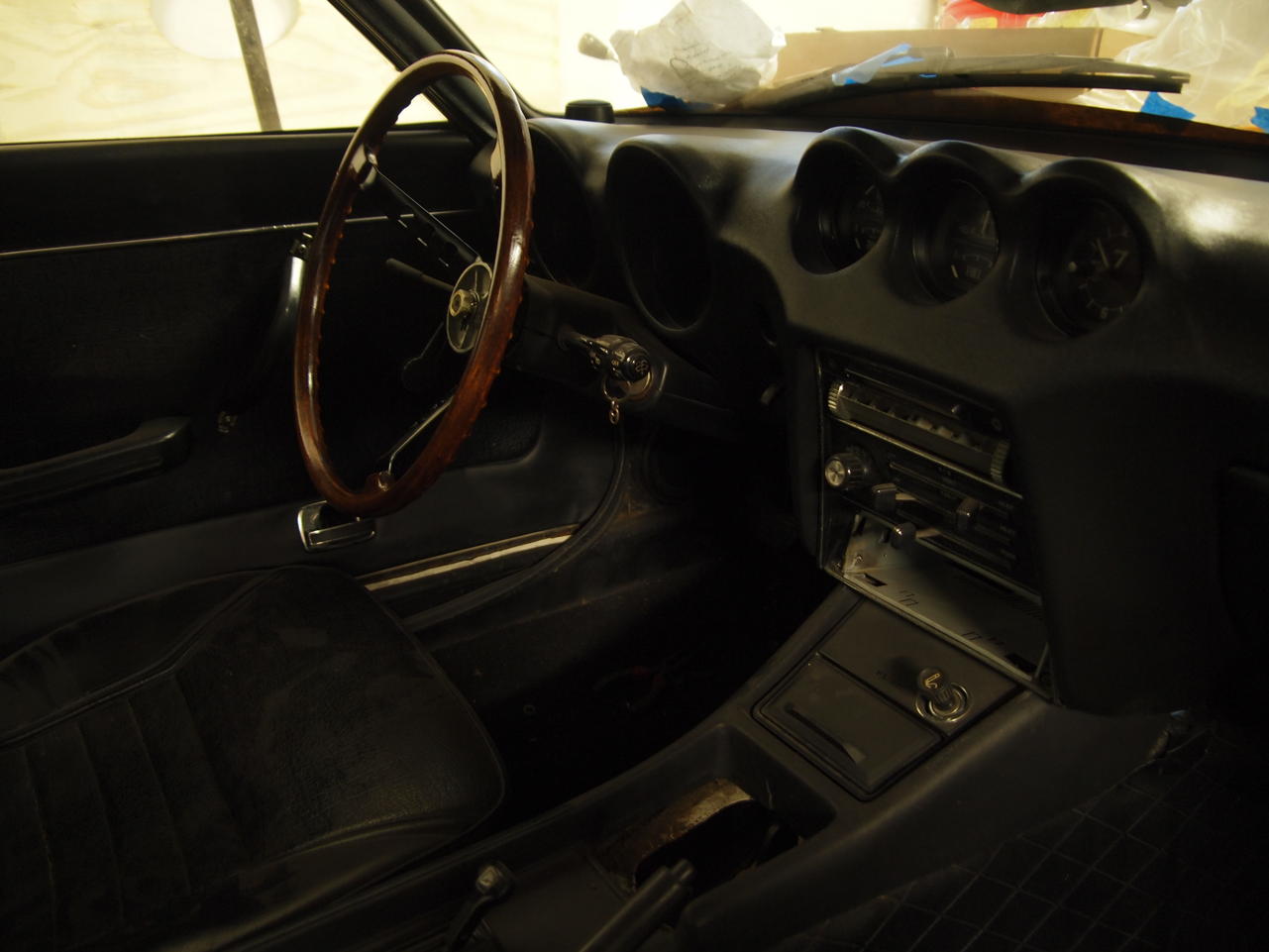

Threw on one of the restored steering wheels to roll it around the garage. Poor shot, but if I used the flash, you could see all the dust. Another of the roll cage.

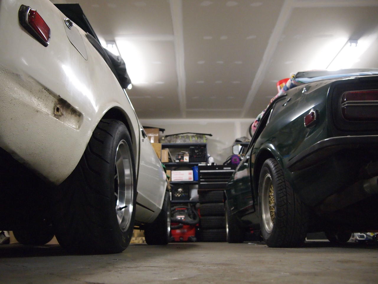

Back on the ground, wheels and tires installed. When I had this towed to the garage back in the Fall, I had them drop it off in the driveway, thinking I'd just push it in the garage where I wanted it. Everything must've been locked up, it was awful. This time though it slid around nicely. Things seem to be paying off.
Thanks Stephen. It took awhile to find a good console for my '70, so I'm very reluctant to tear into this Series-1 piece, lest I regret it later. I'm generally hesitant to do things to the car that can't be undone. This '71 is modified to the point that I probably shouldn't hold that feeling anymore, but I do believe (for the most part) it could still be restored to stock, need-be. Not by me. But someone else with lots of money and time.

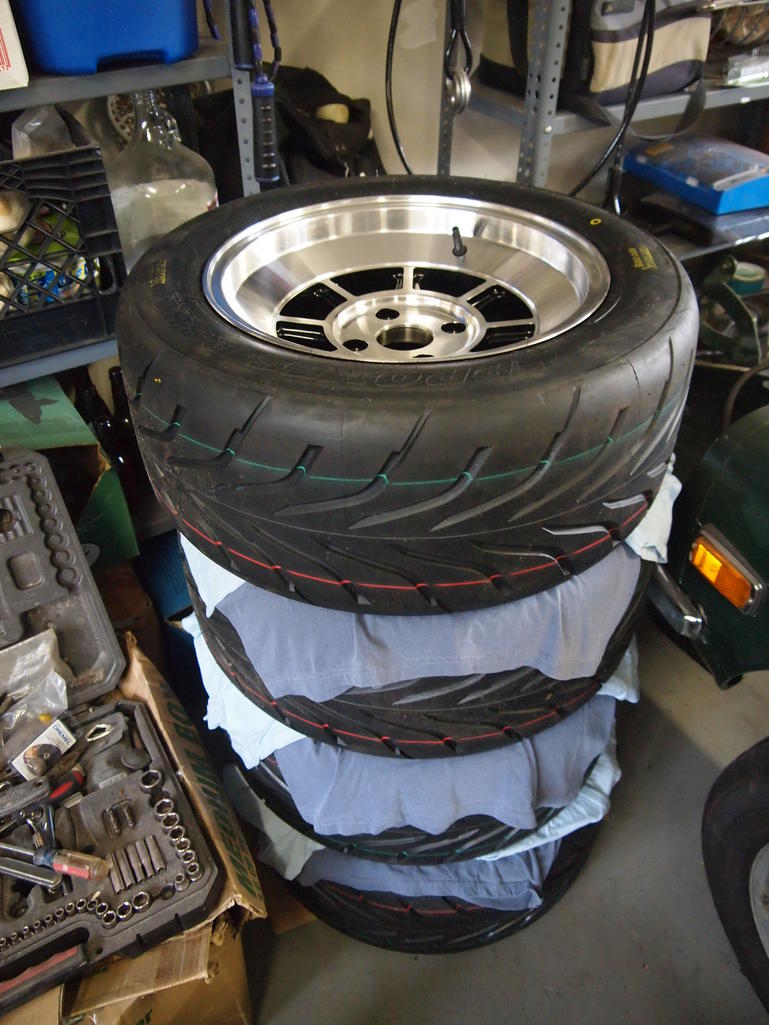

I failed to mention: The wheels are 15x8 Rota's and the tires are 225/50ZR-15 Toyo Proxes R888. No fitment issues, and it'll be nice to see how the front looks once fluids, carbs, the hood, etc. are all re-installed. I'm hoping it'll drop down just a little more. I may find I have to roll something up front later on, but for now things are looking good. Thanks for all the folks who chimed in when I was looking at sizing questions a few months back.
