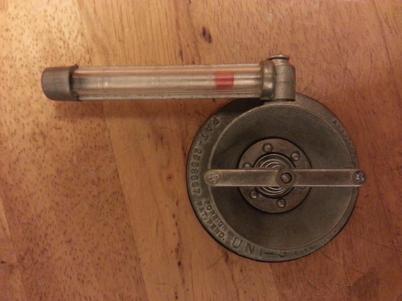

January 22, 201312 yr Author comment_412625 You said thickness, but I'm assuming you meant inside diameter?If that's the case, then you need something close to 3/16 ID. It's not a critical fit since you're not going to be running the car with it installed. Just something snug enough that it doesn't leak or slip off accidentally while you are verifying the bowl levels. Clear PVC would be a good choice for short term gasoline contact and you can probably find something suitable in the lawnmower repair section of your local home and garden supply store. Thanks cap'n thats what I was looking for. Also, good news. I figured before I got spendy, I'd double check the my random car parts box and look what I found! Looks like the PO was nice enough to have given me his old unisynch and I never noticed. I also found some other well needed yet forgotten goodies like new weatherstripping. Bad, yet unrelated news is my Retrosound radio is definitely toast. Probably out of warranty, too. Guess I'll have to just listen to good old engine noise until I can fix it or save up 3 Bennys. Link to comment https://www.classiczcars.com/forums/topic/45448-240z-still-not-starting/?&page=3#findComment-412625 Share on other sites More sharing options...
January 22, 201312 yr comment_412641 Figured as much. So after you verify that your float bowl level is correct and move to tuning with the engine running, here's an extensive collection of SU tuning information. It's from one of the stickys at ZCAR.com, and you should read, read, and read: carb tuning; can't find Norm's procedure - ZCAR.COM If you can't tune your SU's after studying all the info in the above thread, then you should just take it to someone else. And yeah, that Unisynch should come in handy. Link to comment https://www.classiczcars.com/forums/topic/45448-240z-still-not-starting/?&page=3#findComment-412641 Share on other sites More sharing options...

January 22, 201312 yr comment_412682 The Uni-syn is junk compared to the Weber SK tool. I got mine online for about $35. Link to comment https://www.classiczcars.com/forums/topic/45448-240z-still-not-starting/?&page=3#findComment-412682 Share on other sites More sharing options...
January 22, 201312 yr Author comment_412693 Its just an edelbrock I got from the PO. Turns out I had got it spot on by ear. Its running better everyday, so at least I'm making progress. I pulled my plugs, and the front 3 seemed rich, and the rear was pretty good. I'll post pictures in a bit. It also seems like once the engine is warm, the only backfire occurs if I open the throttle quickly, or flutter it. Similar, if not a lean pop. It happens out both carbs at once, the fuel is not ignited. But its been in the single digits. After fire comes into play when I richen either carb any to help settle the pop. Leaning it immediately stops it. Perhaps they really are lean, but my plugs arent burning hot enough to richen it? Link to comment https://www.classiczcars.com/forums/topic/45448-240z-still-not-starting/?&page=3#findComment-412693 Share on other sites More sharing options...
