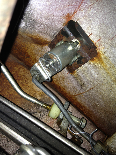

Now, I can't lock the door. When I insert key and turn the cylinder there are too much loose connection.
Does anyone have tips to adjust lock?

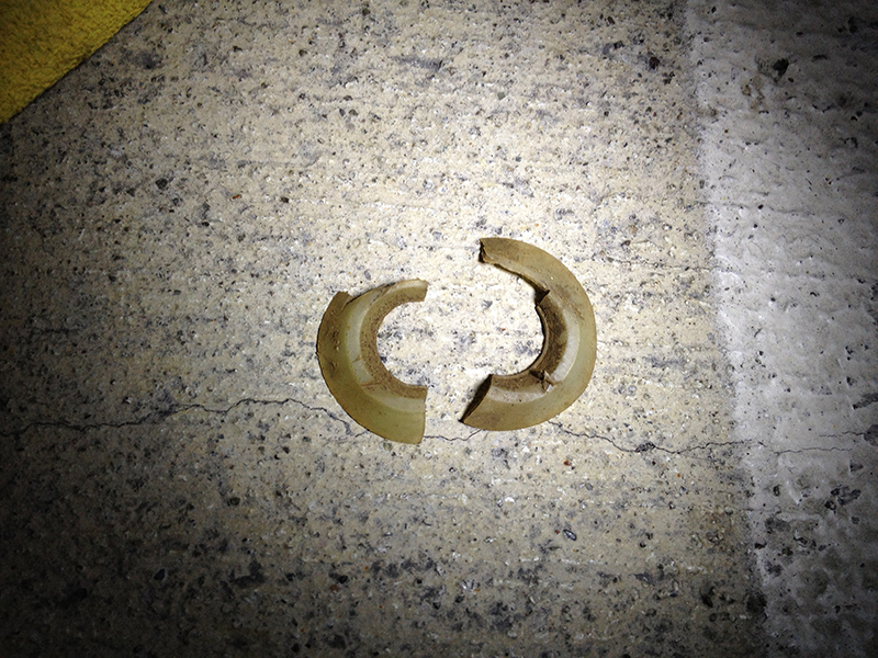

I usually hold off to allow others to chime in, but the game(s) must have everyone distracted.

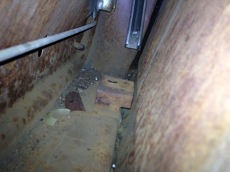

The plastic piece you have in two pieces is usually on one of the rollers for the window mechanism. Nice to have, but I don't think you'll have much trouble for not having it. Best I've been able to discern is that it's to either keep the roller in the track on the window pane, or to keep the roller under a slight amount of pressure and therefore in line in the track. Others may have a better or more accurate explanation.
As far as to why you're not locking now, it may be that the position of the lock and / or the tab on the back side has shifted sufficiently to NOT allow the locking mechanism to travel properly or to be just short (or long) and therefore not permit the lever to rotate.

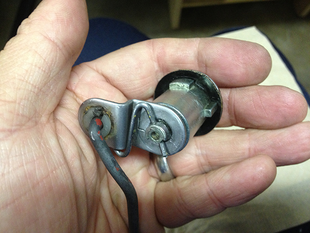

After getting it to play, I can't offer much. Check that you have a Left tab on that lock and that the shaft on the lock isn't too worn to properly actuate it.

I'm not sure but I don't think that there should be so much slop between the lock sand the lever. As you turn the key the lever should move with it. Yours moves together and then the key turns without turning the lever. At least that how the video apprears to me. If I get a chance I'll check out one fo mine today.
Chuck
When I look in the foreground I see that the latch mechanism is barely moving. It should have lots more travel than what you've got
to unlock the lock. The first thing i would try is blasting the latch mechanism with wd40 or pb blaster. Also check that your linkage's
are not bent or are binding and are Properly seated in their bore holes.

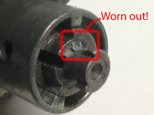

I diagnostic the issue based on your feedback and I discover my tumbler is already worn out!
That's why I can't lock the door.

tamo3, That is a very common failure of the Z car door locks.
Replacing the cylinders is probably the best way to take care of it, but here's some threads that show a different way of dealing with it:

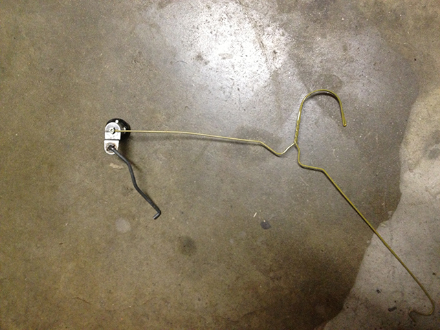

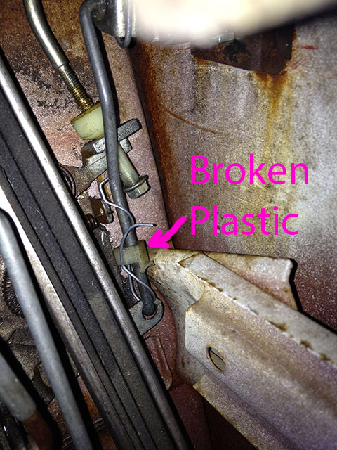

I installed this tumbler and I realized that I broke plastic part that connect to the bar.
I use wire to manage the looseness and now everything is working!
