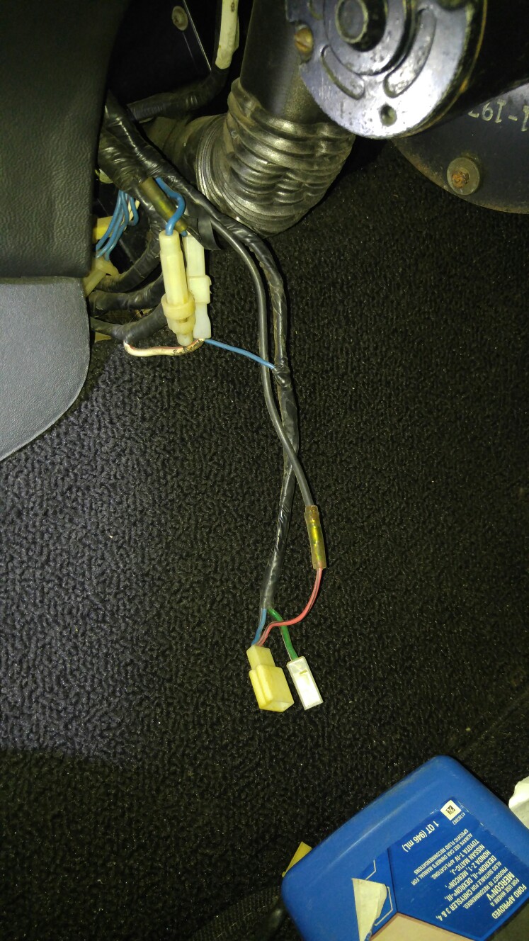

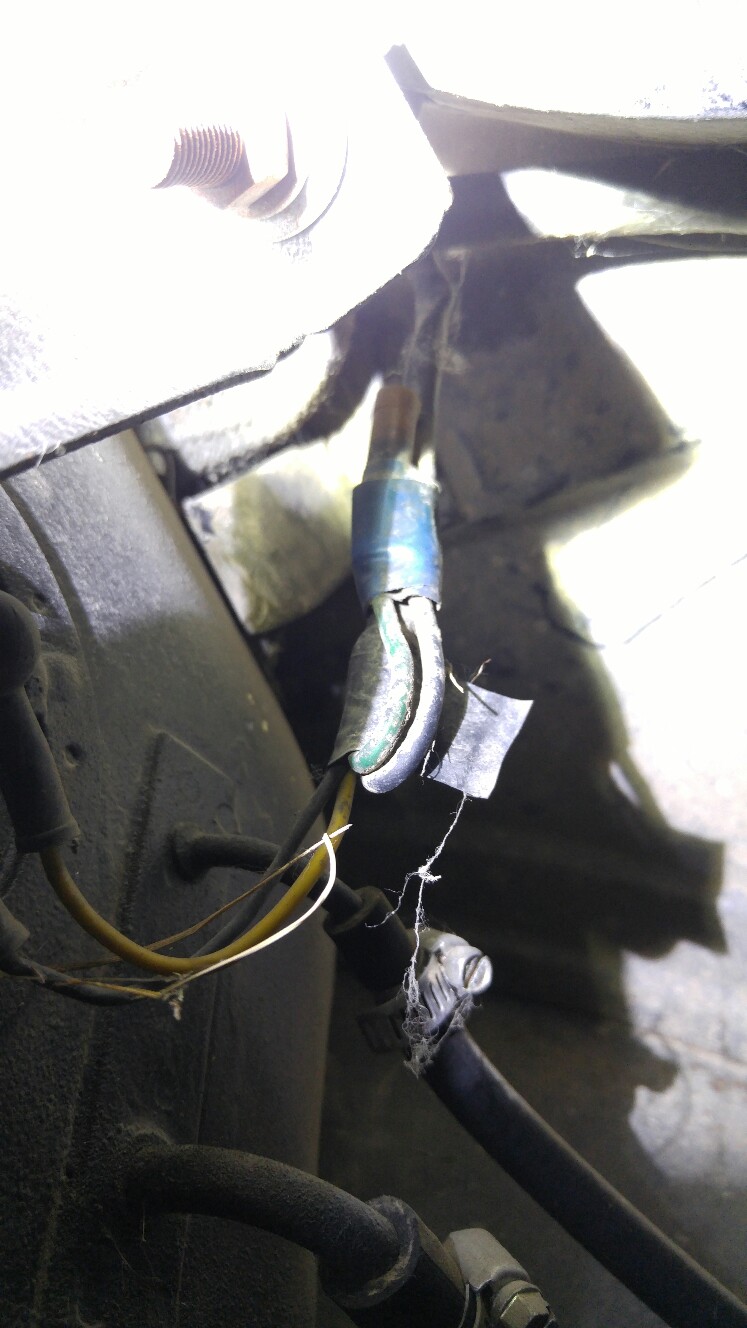

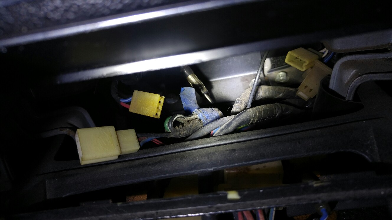

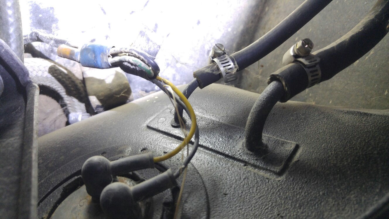

August 3, 20177 yr comment_527337 Photos of harnesses, exactly where expected. So, here's my question... The green from console to tank in continuous wire. Black shouldn't be, right? But also, if not, why is the black there? To ground somewhere? Link to comment https://www.classiczcars.com/forums/topic/45486-240z-electric-fuel-pump-installation/?&page=4#findComment-527337 Share on other sites More sharing options...

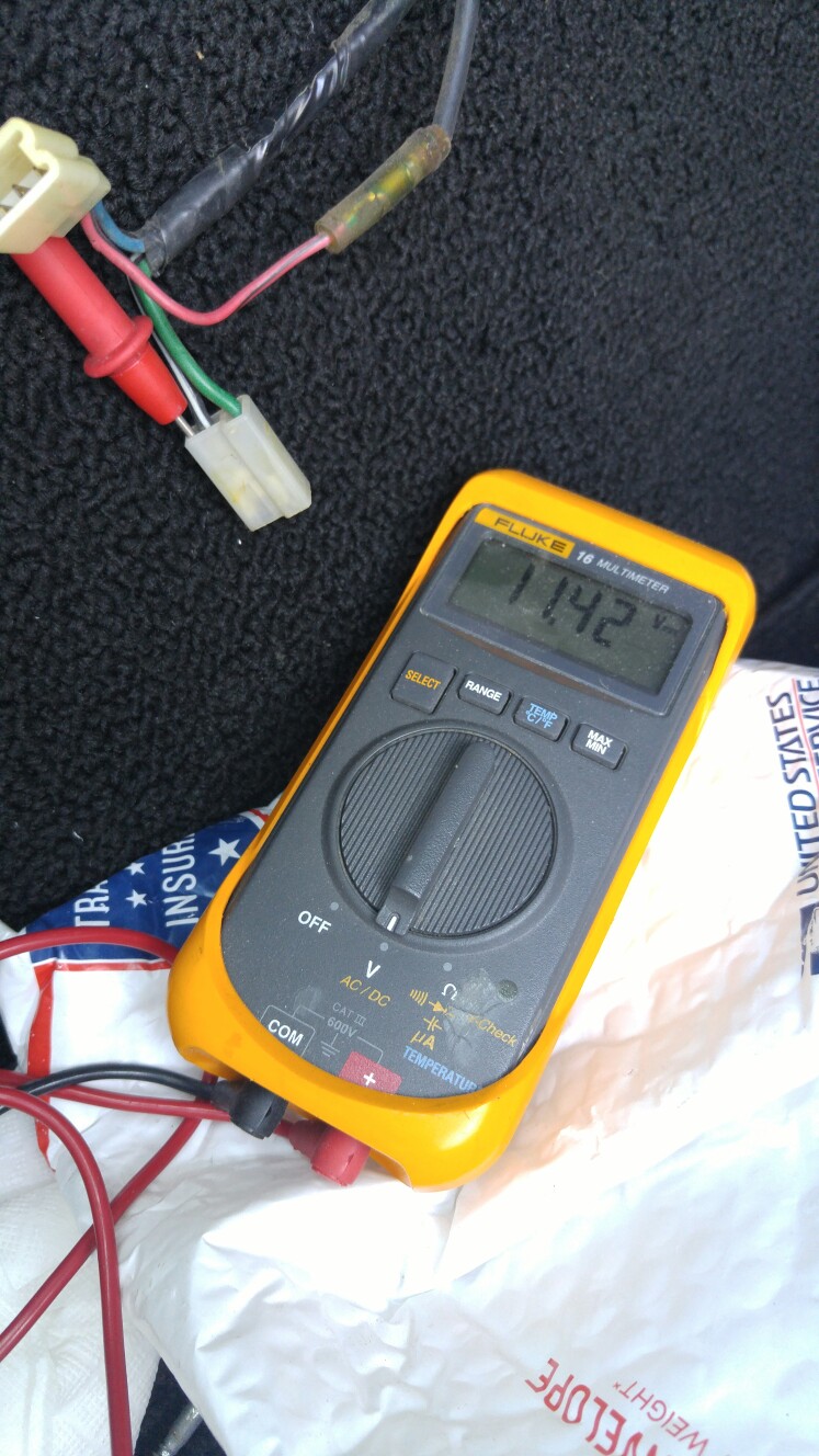

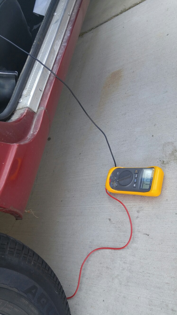

August 4, 20177 yr comment_527339 Ok, tested. Black gets voltage with ignition in ON position. Green from console is direct (zero resistance) to tank green (last photo). Seems like inertia switch between black and green at harness would work great. Still not sure what black is at back, though. Link to comment https://www.classiczcars.com/forums/topic/45486-240z-electric-fuel-pump-installation/?&page=4#findComment-527339 Share on other sites More sharing options...
