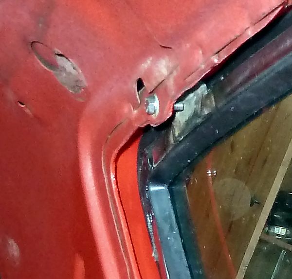

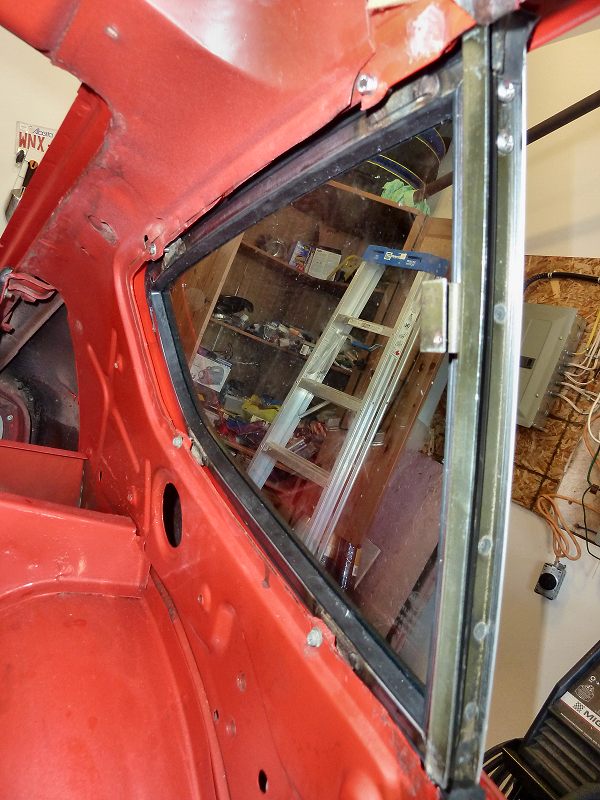

and here is a nice trick to add:
I used longer new screws (actually bolts with same threads) to pull the window in from farther out. Once the 4 bolts have it pulled in, you can change them out with the original screws one at a time.
You can do it in several steps if you want with very long, then medium, then short bolts.
The long bolts make alignment much easier than with the tiny original screws
