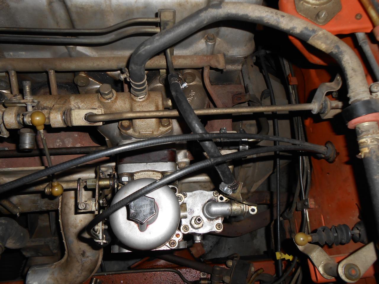

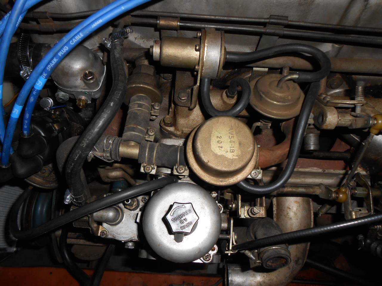

February 1, 201312 yr comment_413666 If it revs fine with the choke on, but dies without it, that's a pretty clear indication that it wants more fuel. But if you've got a wet plug and others that are carbon fouled, that's an indication that it's getting too much.Can you post a couple good pics of the engine bay. Maybe someone can spot an issue up in the pics? Link to comment https://www.classiczcars.com/forums/topic/45535-my-z-wont-rev/?&page=2#findComment-413666 Share on other sites More sharing options...
February 1, 201312 yr Author comment_413671 Can you post a couple good pics of the engine bay. Maybe someone can spot an issue up in the pics? Here you go. I'd be glad to take more pictures from whatever angles if it helps anyone. Just some shots in the dark here: Could the problem be because of timing chain stretch? Just out of curiosity, what do the different numbers mean in the compression test results? Is it due to improper valve adjustment? Link to comment https://www.classiczcars.com/forums/topic/45535-my-z-wont-rev/?&page=2#findComment-413671 Share on other sites More sharing options...
