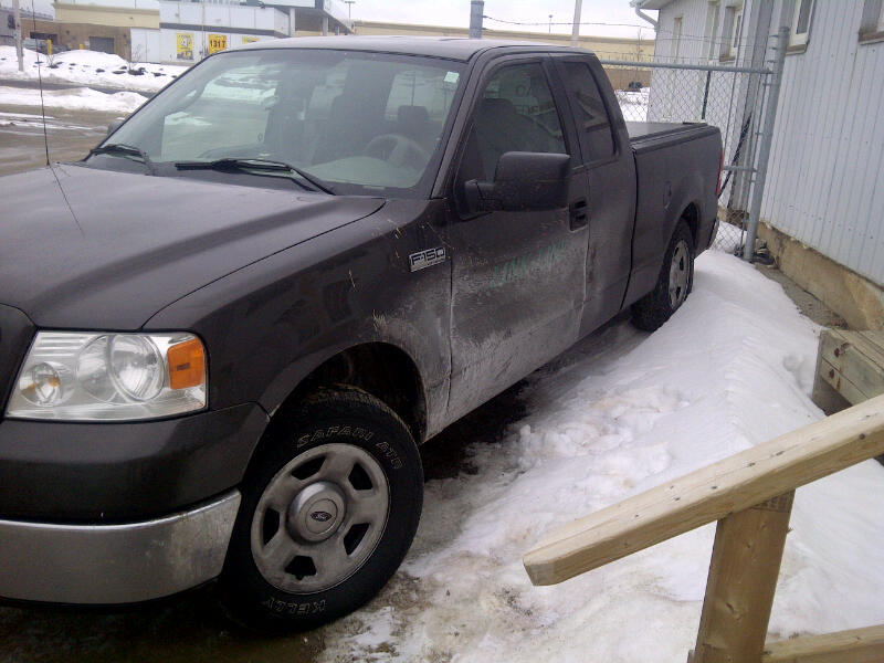

This is a pic of my daily driver.
It was clean in the morning.
One day's worth of pure salt build up.:sick:
Oil treatments are an industry here and make a huge difference in a vehicle's condition.
My Honda Pilot gets treated regularly and is like new after 8 salty winters.
It would be wise to avoid such weather with you Z as much as possible. That Ford has corrosion resistance that the Z will never have no matter what. If you have to drive your Z in such weather probably wise to flush everything with fresh water.

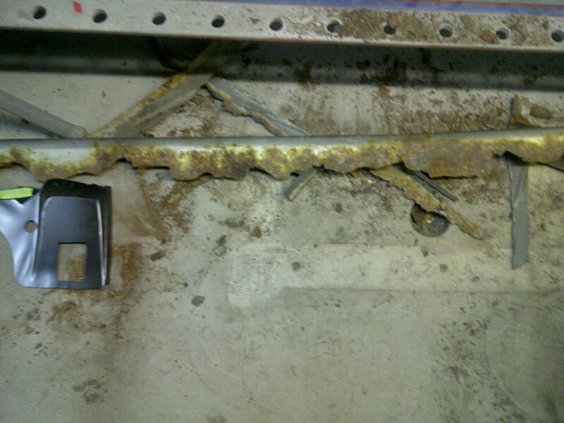

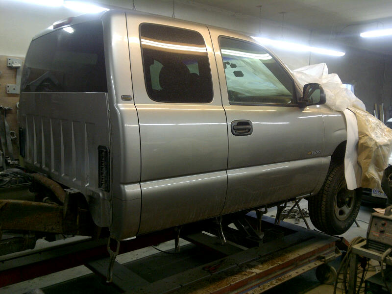

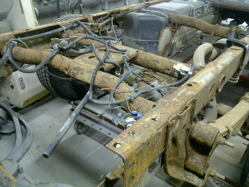

Just a quick example of an untreated 10year old Chevy pickup in my brothers shop.
This is the frame and what's left of the rocker panel.
Posting this to show what we deal with in the great white north:cry:
Also where a vehicle spends its life is important info if you want to purchase.
The box on this truck was so rusty they are replacing it with a better one from the wreckers.
The oil treatments we use and lots of washing prevent a lot of this type of rust damage.
