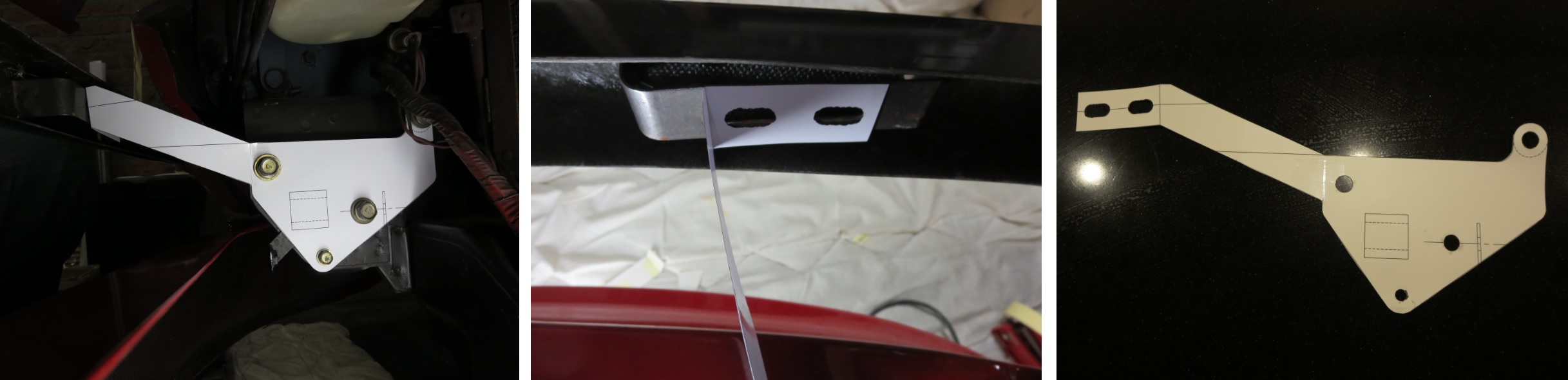

Back to my bumper bracket saga.
I made a mock-up of the towing bracket with the bumper support to see if my calculations we anywhere close. The angle on the bumper face is a little off. About 5degrees. Might be in my calculations. Yuo can see it in the left image where it touched the bumper. Im also looking at fitting a bracket to mount the horns. Its the vertical line just behind the center bolt.
