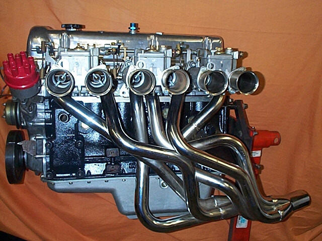

If you are talking about just using the turbo engine (without the turbo), write to Dave Jarmen of DJ Road and Race:
david.jarman@bt.com
He's building me an engine and I've seen the rolling road print outs of similar spec engines and it's not far from 300 bhp !
Photo (I hope) enclosed !
https://www.classiczcars.com/forums/topic/4581-300hp/#findComment-25765
