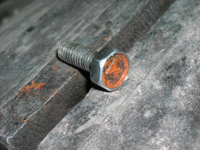

Posted February 25, 201312 yr comment_416145 Now I have no crushing need for an answer, just thought this was kinda puzzling. As I have been cleaning up the original bolts and screws I noticed that all of the M6 x 1.0 bolts have the number 4 stamped on the top. Just trying to figure out what it signifies, strength perhaps? Link to comment https://www.classiczcars.com/forums/topic/45827-question-for-you-original-guys/ Share on other sites More sharing options...

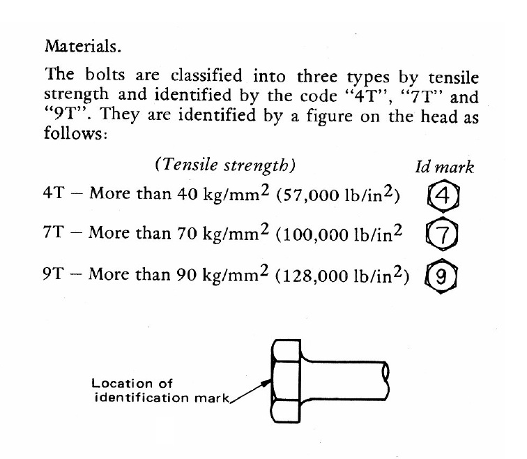

February 25, 201312 yr comment_416155 I ran across this document during my travels...it will answer your question & more. Enjoy!Datsun Torque Specifications.pdf Link to comment https://www.classiczcars.com/forums/topic/45827-question-for-you-original-guys/#findComment-416155 Share on other sites More sharing options...
February 25, 201312 yr comment_416157 Now that's a cool .pdf. Thanks Jarvo! Link to comment https://www.classiczcars.com/forums/topic/45827-question-for-you-original-guys/#findComment-416157 Share on other sites More sharing options...
February 25, 201312 yr comment_416173 Excellent contribution! Interesting to read the cautions regarding bolts going into aluminum or plastics, and others about compensating for friction due to rust or other issues. Finally the best comment - rely on the FSM. Link to comment https://www.classiczcars.com/forums/topic/45827-question-for-you-original-guys/#findComment-416173 Share on other sites More sharing options...

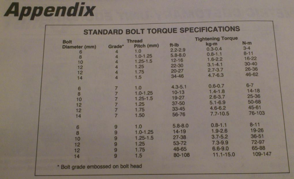

February 27, 201312 yr comment_416389 Thats a great document explaining bolt torque specs. Added it to my collection. Thanks a lot:classic: Ive always used an old workshop manual by Tom Monroe for bolts where I couldnt find the tension in the FSM. It has a table in the back with most of the figures. Although not as comprehensive. Link to comment https://www.classiczcars.com/forums/topic/45827-question-for-you-original-guys/#findComment-416389 Share on other sites More sharing options...
