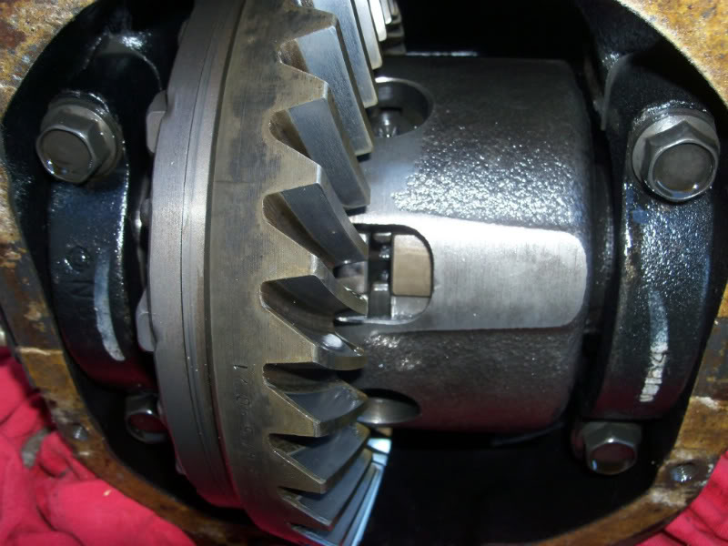

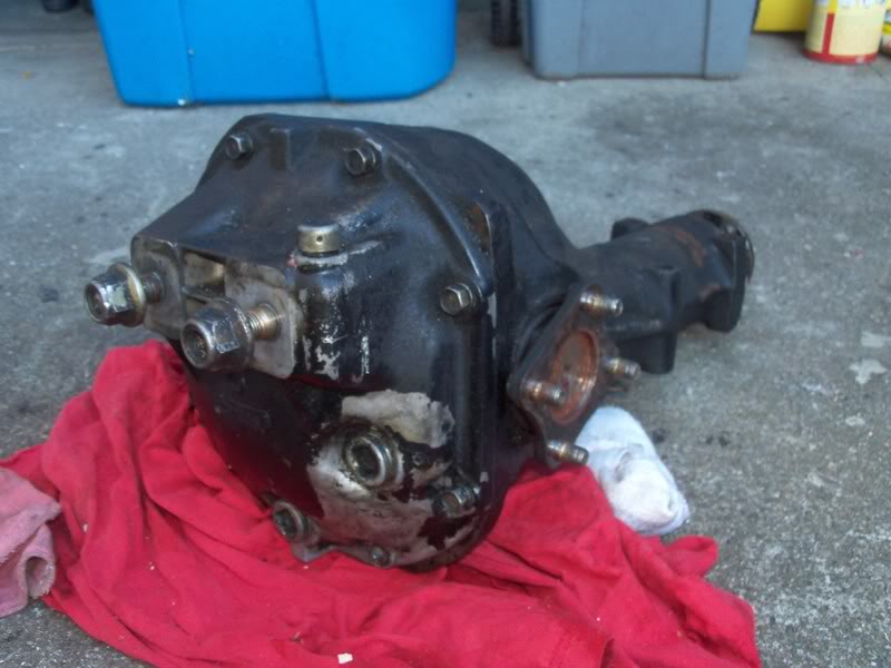

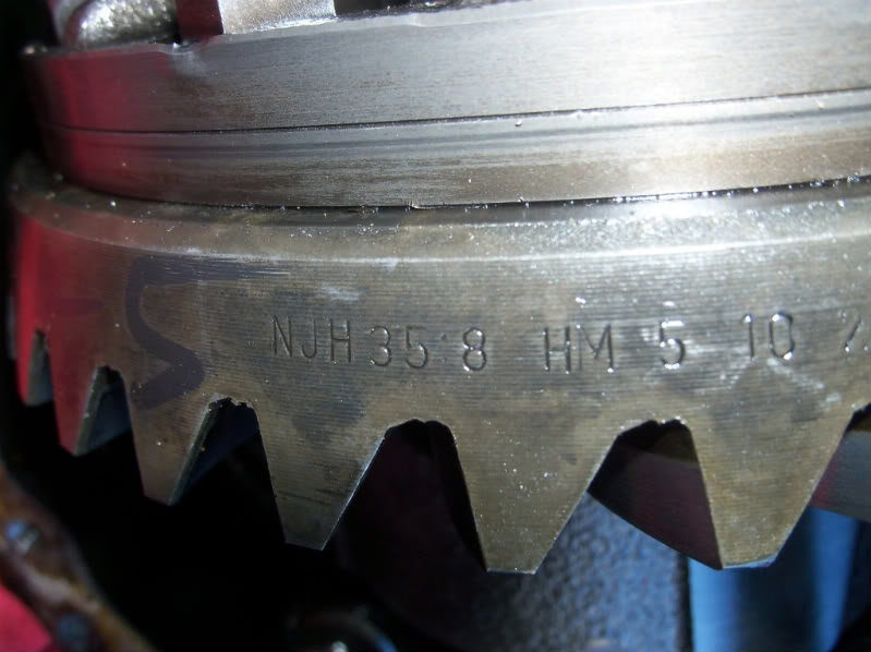

February 28, 201312 yr comment_416510 I have a 4.375 R200 CLSD (longnose) out of an R31 GTS-R but can't see myself parting with it... sorry for the tease! Edited February 28, 201312 yr by LeonV Link to comment https://www.classiczcars.com/forums/topic/45869-ring-and-pinion/#findComment-416510 Share on other sites More sharing options...
March 1, 201312 yr Author comment_416541 Your tease even included pictures !! Shameless. Link to comment https://www.classiczcars.com/forums/topic/45869-ring-and-pinion/#findComment-416541 Share on other sites More sharing options...
March 1, 201312 yr comment_416543 WW2Winger said: Your tease even included pictures !! Shameless.I know, I'm a terrible person! Are you sure you really need the lower gears? What makes you want something lower than a 4.11? Link to comment https://www.classiczcars.com/forums/topic/45869-ring-and-pinion/#findComment-416543 Share on other sites More sharing options...
