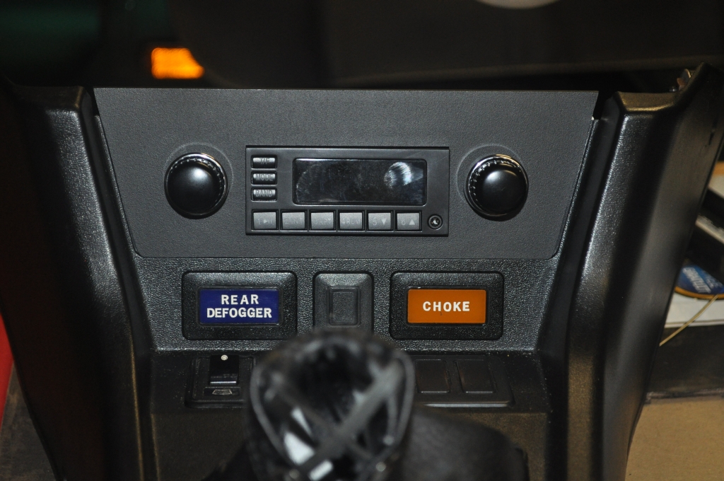

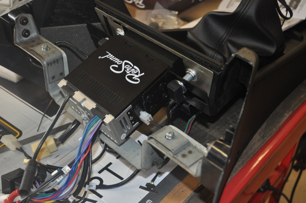

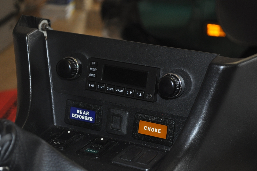

February 28, 201312 yr comment_416505 So I went with the retrosound system and couldn't be happier. It was relatively inexpensive (< $300 if I remember correctly), came complete with a new faceplate, and was an easy install as the radio is so small. It looks like a basic 1970's radio but has most of the modern features you would expect in a new heradunit. About the only thing it doesn't have is Bluetooth, but I solved that problem with a $20 box from a company called Aluratek which will receive streaming BT audio and convert it to analog audio out which can be used into an aux input on the Retrosound unit. I actually connected this little box (about the size of a matchbook) to the remote aux input from the Retrosound head unit which also has a spare USB which I use for powering and charging te Aluratek. In addition to the Retrosound head unit, I also installed a very small but powerful Rockford Fosgate 4 channel amp and it was tiny enough where I could mount it to the top of the glove box, so it is hidden from view. I also installed a small muffin fan in the glove box to provide a little bit of air flow and I power this with the antenna control from the Retrosound which has ample power for this small fan. I was a little worried about the amp overheating, especially in the middle of summer here in Texas, but so far no issues what so ever. It probably helps that I am only using 2 of the 4 channels as well. I also purchased 2 powered subs from Retrosound which fit perfectly behind each of the seats up against the riser. You don't even know they are there but you can definitely hear them. Finally I bought a speaker box from MSA which replaces the rear tail light panel and will house 2 6x9 speakers. I have had very good luck with Infinity brand speakers and so went with the best Infinities that I could find. The system sounds great, is unobtrusive, looks period correct (for those parts that you can actually see) and is powerful enough to hear it with both windows open and on top of my loud exhaust. Here's a few pictures of the head unit as I was installing it in the console, but with the console still out of the car. Hope this helps. I have more pictures from the head unit install and can take some of the subs and amplifier if you are interested. Just let me know. Mike. Link to comment https://www.classiczcars.com/forums/topic/45872-show-us-your-car-audio-receiver/#findComment-416505 Share on other sites More sharing options...
