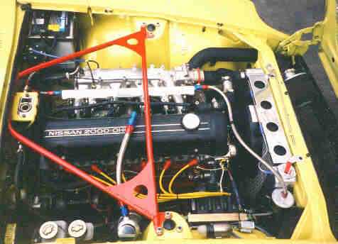

March 6, 201312 yr comment_417031 I bet this has been discussed and its a bit OT but how do you "feel" the effect of strut bar? It looks nice and if it has benefits, i might get one for myself. Performance gains, if any, are minimal unless the bar is triangulated. Example: Link to comment https://www.classiczcars.com/forums/topic/45896-black-valve-covers-on-240s/?&page=2#findComment-417031 Share on other sites More sharing options...
