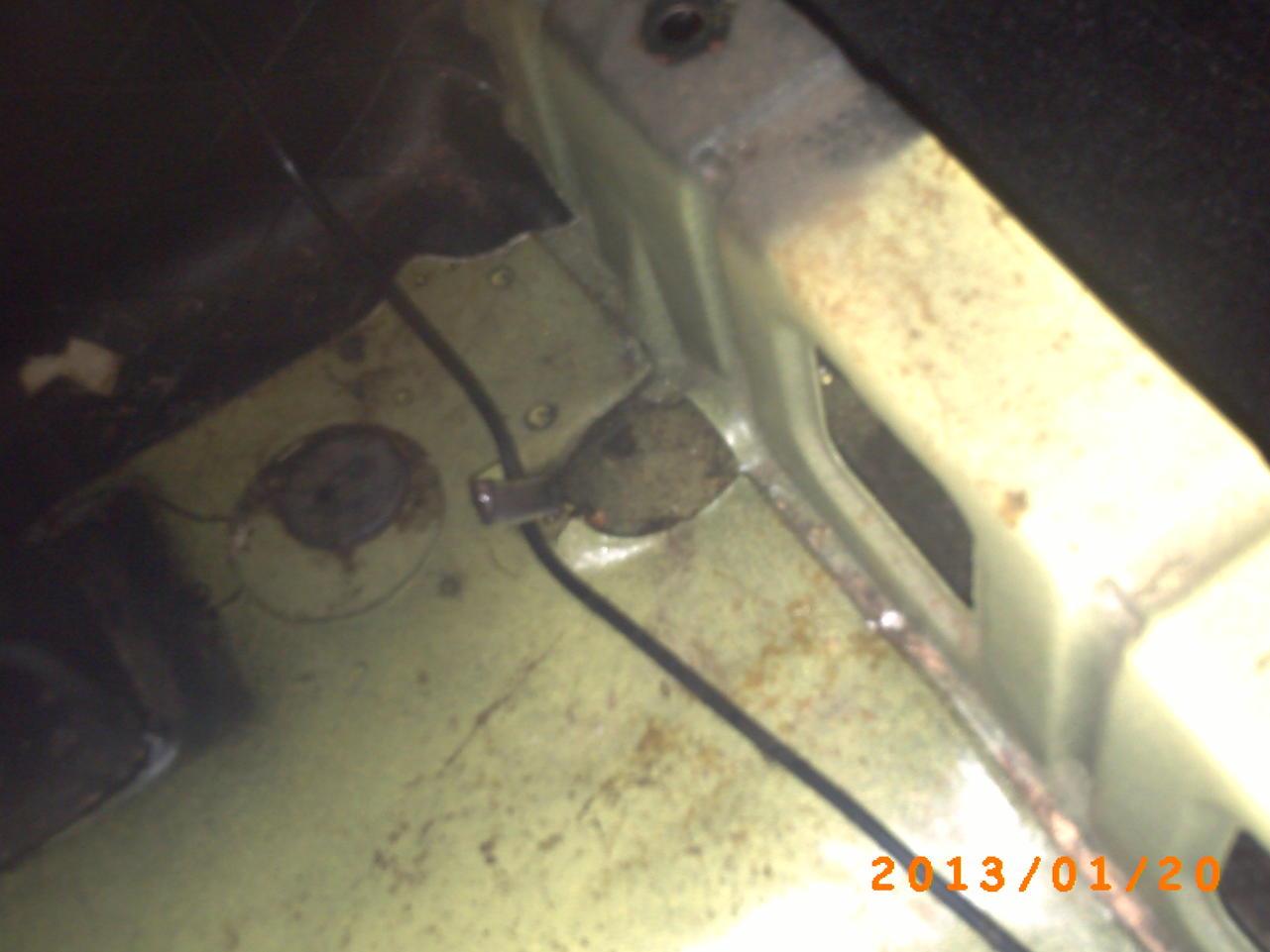

Posted March 7, 201312 yr comment_417138 can anyone tell what this wire is for? it's located under the passenger seat. Link to comment https://www.classiczcars.com/forums/topic/45946-wire-under-seat-question/ Share on other sites More sharing options...
March 8, 201312 yr comment_417141 Color? Can you tell us where you see it going to on either end? Link to comment https://www.classiczcars.com/forums/topic/45946-wire-under-seat-question/#findComment-417141 Share on other sites More sharing options...
March 8, 201312 yr comment_417142 looks like it could be the wiring for the emergency brake light on the dash. Link to comment https://www.classiczcars.com/forums/topic/45946-wire-under-seat-question/#findComment-417142 Share on other sites More sharing options...
March 8, 201312 yr comment_417183 Year etc???The passenger seat had a pressure switch mounted in the springs for the passenger seat to turn on the seat belt warning light if someone was sitting in the seat. It could be the wiring for that switch.jlp Link to comment https://www.classiczcars.com/forums/topic/45946-wire-under-seat-question/#findComment-417183 Share on other sites More sharing options...
March 8, 201312 yr Author comment_417196 it's a 72 build date 10/71. straps, no springs under seat. i think it's for the emergency brake. could it be a speaker wire or does that run under the rocker? Link to comment https://www.classiczcars.com/forums/topic/45946-wire-under-seat-question/#findComment-417196 Share on other sites More sharing options...
March 8, 201312 yr comment_417224 The speaker wire is buried in the bundle running along the right side rocker and disappearing into the dogleg. Check your parking-brake and find the button switch under the handle. There should be a single wire attached to it. The switch goes to ground when the parking-brake handle is lifted, this turns on the light on the dash. As a test, ground your mystery wire with the ingnition on and see if the brake light on the dash comes on. Link to comment https://www.classiczcars.com/forums/topic/45946-wire-under-seat-question/#findComment-417224 Share on other sites More sharing options...

March 9, 201312 yr comment_417252 A Z car owner was launched today into low earth orbit due to a wiring malfunction, news at 11.Only wire in my 1970 model in that location is the emergency brake switch for the red warning light in the speedometer. Edited March 9, 201312 yr by Mikes Z car Link to comment https://www.classiczcars.com/forums/topic/45946-wire-under-seat-question/#findComment-417252 Share on other sites More sharing options...
