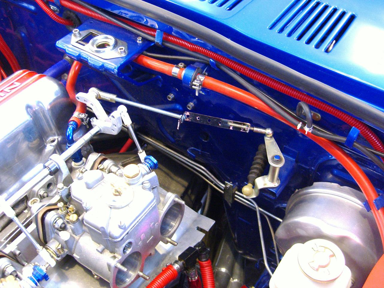

Hey Reverend, I want to chime in here as the photo a few posts back (#48) is from my engine bay...and I stripped it off the car this year as it was binding up. :-(
What you see there is how I modified the firewall bracket to make a "repeater" of sorts, but there was so much slop that it never hooked up correctly and the rubber washer/o-ring in the stock firewall assembly didn't let it rotate smoothly, so it would stick. Plus, there was so much side tension that both the repeater on the firewall and the bar on the carbs would deflect a lot when you stepped on the gas. The car originally had the repeater assembly with a long rod that attached to a bracket on the closest carb cover, but that didn't work well either.
My solution this year (untested yet as it's still COLD in MN) was to eliminate that middle piece, put a heim joint in one of the arms on the carb rod to account for the misalignment, and make new connecting rod that goes from the pedal all the way to the bar (it was about 11"). I did lots of figuring, and my mock-up worked great...but, no real-world testing yet. I do have some photos on my other computer I should be able to find if that would help.
So, if this helps, don't do what I did (or maybe you could try it but do it better somehow).
My next solution was to just switch to cable. Top Performance had a cable kit for about $100, I think.

I just found a picture of the test bracket I made to make sure everything lined up smoothly and the carbs opened all the way. A simple fix. Since then, I made a custom rod that has a heim joint at one end (carb arm) and hooks to the pedal assembly on the other. Hope this helps! (P.S. No idea on the coolant leak...good luck with that!)
Looks simple enough to me to make :D And it works properly? I think less the parts, the better it works.
This is not carb related, but is core plug failure common to happen on Z's? Mine is from CA and i suspect it has been run with very minimal amount of anti-freeze (wich has anti-corrosion materials). Im going to try to replace the plug by removing only tranny and accessories....
Hi Reverend, I can't guarantee it works just yet, but I think it will. It sure looks a lot clearer without that extra piece, and everything feels really smooth. Of course, we still have 2 feet of snow on the ground, so I won't know for sure for another month...or two...when the roads clear. :-(
Yea, i might change them all, i have to start from somewhere. Thank god the rest of them are 800% easier to replace. So far so they all look good and does not drip or sweat...so time will tell. It has been most warmest winter of this decade, snow has melted from all over the country, as normally there is at least 2 feet. I dont mind at all... haha. This is my solution to the carb linkage, so far it works good but as the long rod over the manifold does not have support at the end part, it bends a little, not much, just enough you notice.

Seems like i need to make more modifications, linkage works but its stiff as hell (at the pedal) and wont pass inspection as it is now. Carbs works...okay-ish. You can accelerate without any hesitation but cruising steadily 2-3K rpms..that aint working. It spits and stutters while holding your foot steady.. too little idle jet?

Hey Reverend, just an update on my end. I'm putting together the carb assembly I talked about and you tried, and I think I figured out a way to keep the bar from deflecting. I'm using another bracket that comes off the valve cover to negate the tendency of the rod to pull away from the motor. I'm using heim joints and some threaded rod. I'll have a photo when I put it all together. Good luck with your tune-up in the meantime!
Exactly my toughts!! I was thinking of putting exactly the same thing to get rid of the bending! I managed to get that pedal feel a bit more softer by modifying the assembly, i gotta take pic to show. Its still quite stiff but way better than it used to.
