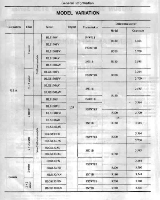

Good answer. I didn't even really look at the number. Reminds me that I did try to use the FSM once to identify a 1979 by VIN number but couldn't find a number that matched. Which is surprising by the General Information page in the FSM. One of them should have matched, there are so many.
I looked in 78, 80 and 81 also. I don't see any HGS... numbers. All of the Model numbers are HLS..., KLS, or GHLS...

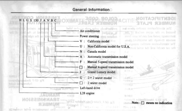

The L means left-hand drive so maybe they just left it out for the non-Japanese market. It's in all of the FSM's though as a descriptor.
You're right though about ZX = S130. Most likely a 78 build date 1979 280ZX. Probably with a transplanted turbo motor.
Edit - added the legend

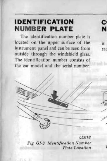

The GI chapter in the FSM is what makes it confusing. It says that the Model number is part of the what we call the VIN. Model number + serial number = VIN.
I'm think that the US market VIN's are different from Japanese market and the FSM didn't get changed to show that. All US cars start as "L" so they left it out, just like all Japanese cars start as "R" so they don't even recognize it with an "R".
Forget about the "L" and the Model numbers probably make sense.
